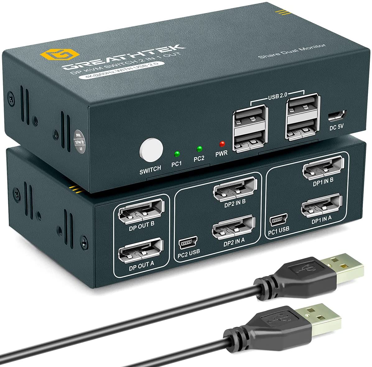

I've been having a look around to see if there is a possibility I might be able to share one or both of the displays between my HP Spectre X360 15" and the cMP and I've stumbled across this;
DisplayPort KVM
Figured I should be able to connect the two DisplayPorts on the K5000 on the cMP to one side of the KVM and the HP to the other side using a USB-C to DisplayPort adaptor or cable and the outputs to the displays using a couple of the proven DP to Mini DP adaptor I linked to above to connect to the Mini DP cables from the displays.
Looks like I might even be able to share some USB peripherals between the two devices which would save me plugging/unplugging my scanner for example.
Does anybody know if this might do the trick and if not is there a known solution to share both displays between the cMP and the HP Spectre? 😕
There seem to be some more expensive KVM switches such as the TESmart that wold also appear to do what I want but has anybody been down this road before and if so what worked for you?
I'm asking because this seems too easy a solution and things don't normally go this well for me! 😉

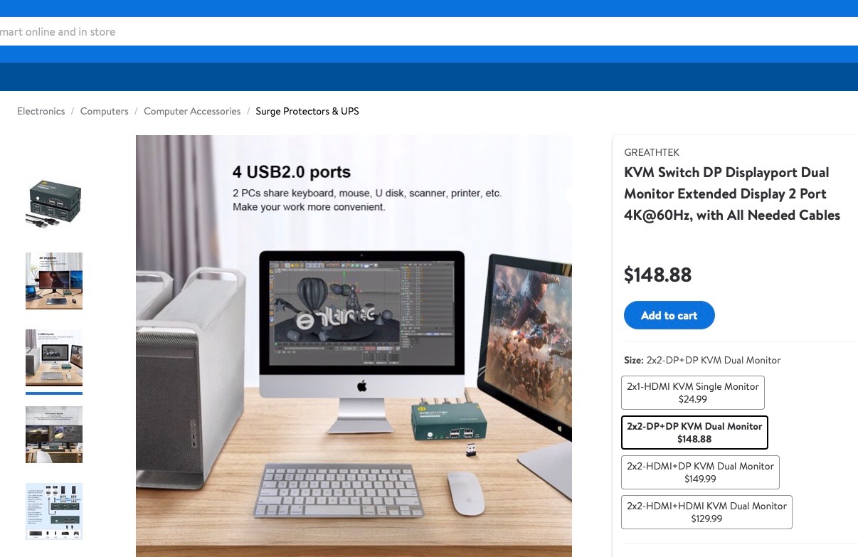

Seems like it's almost guaranteed to work with Mac and Cinema Display if this screenshot from Walmart is anything to go by; 🙂
Fingers crossed it works with the HP Spectre hanging off of one side because if not it seems my only option will be something like the the TESmart 4x2 KVM at over double the price! 😱
