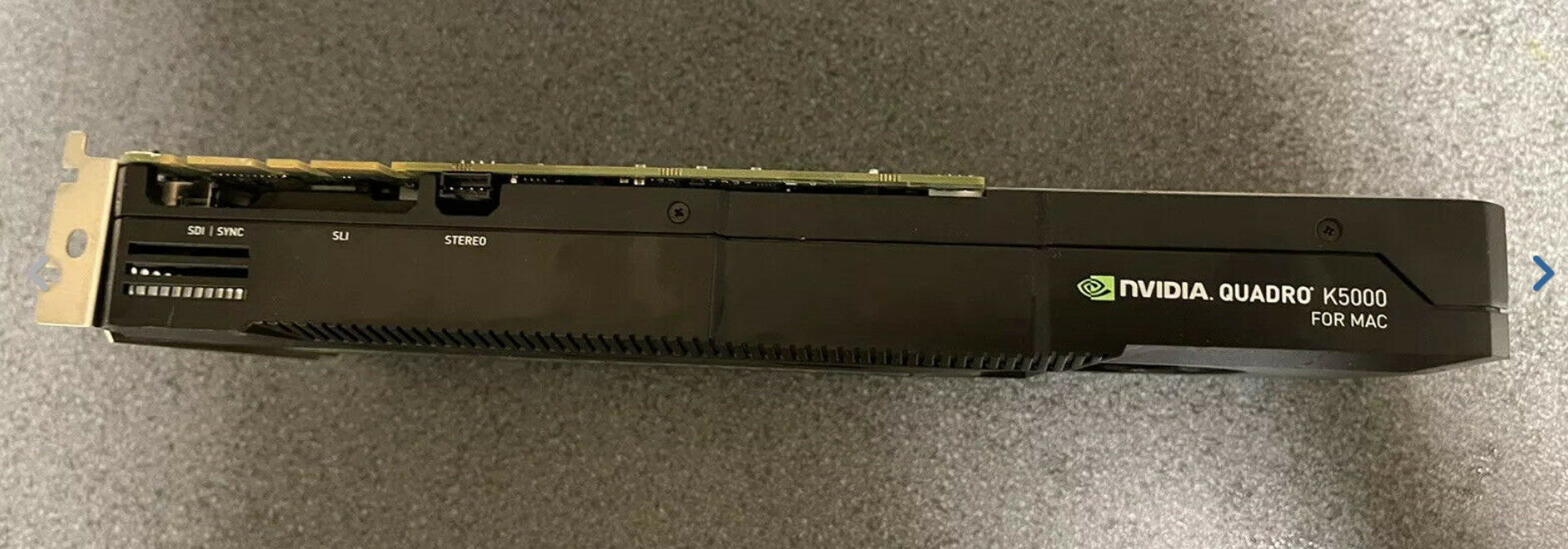

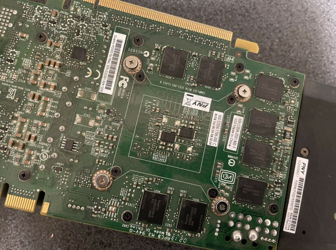

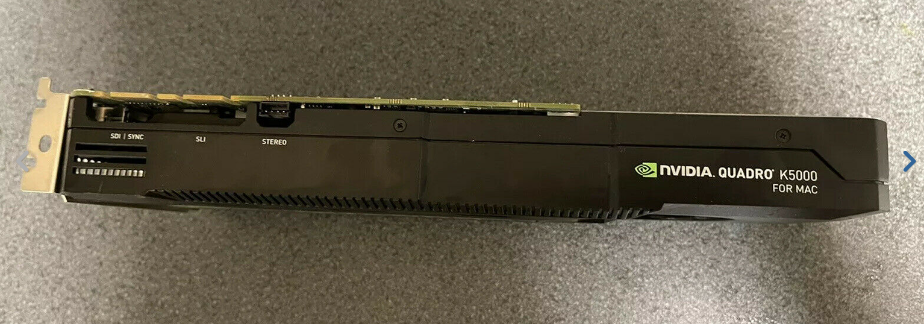

No seriously it is the genuine Mac Edition of the K5000 not a generic flashed one but even after all my research I just discovered after buying it that it occupies two slots in the Mac Pro which might have scuppered my plans for that Highpoint/Sonnet/Squid M.2 adaptor and a couple of blades down the road unless the double Slot 1 space still allows for a card in Slot 2?
Physically a HighPoint or similar will fit in slot 2 with the K5000 in slot 1.
Nevertheless it's common to install the GPU in slot 2 and the HP card in slot 1 , as the HP will almost completely block the fan(s) of the GPU.
Drawback is that you will lose slot 3 though.

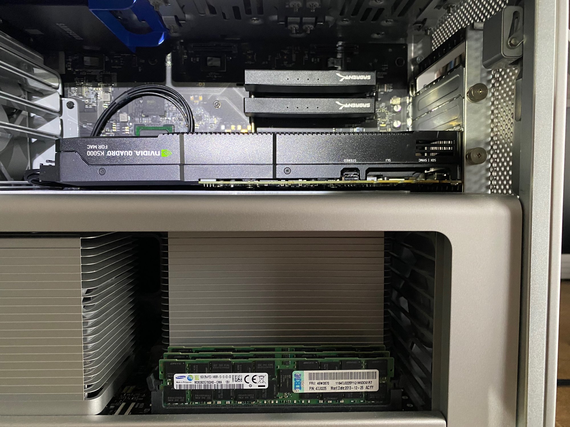

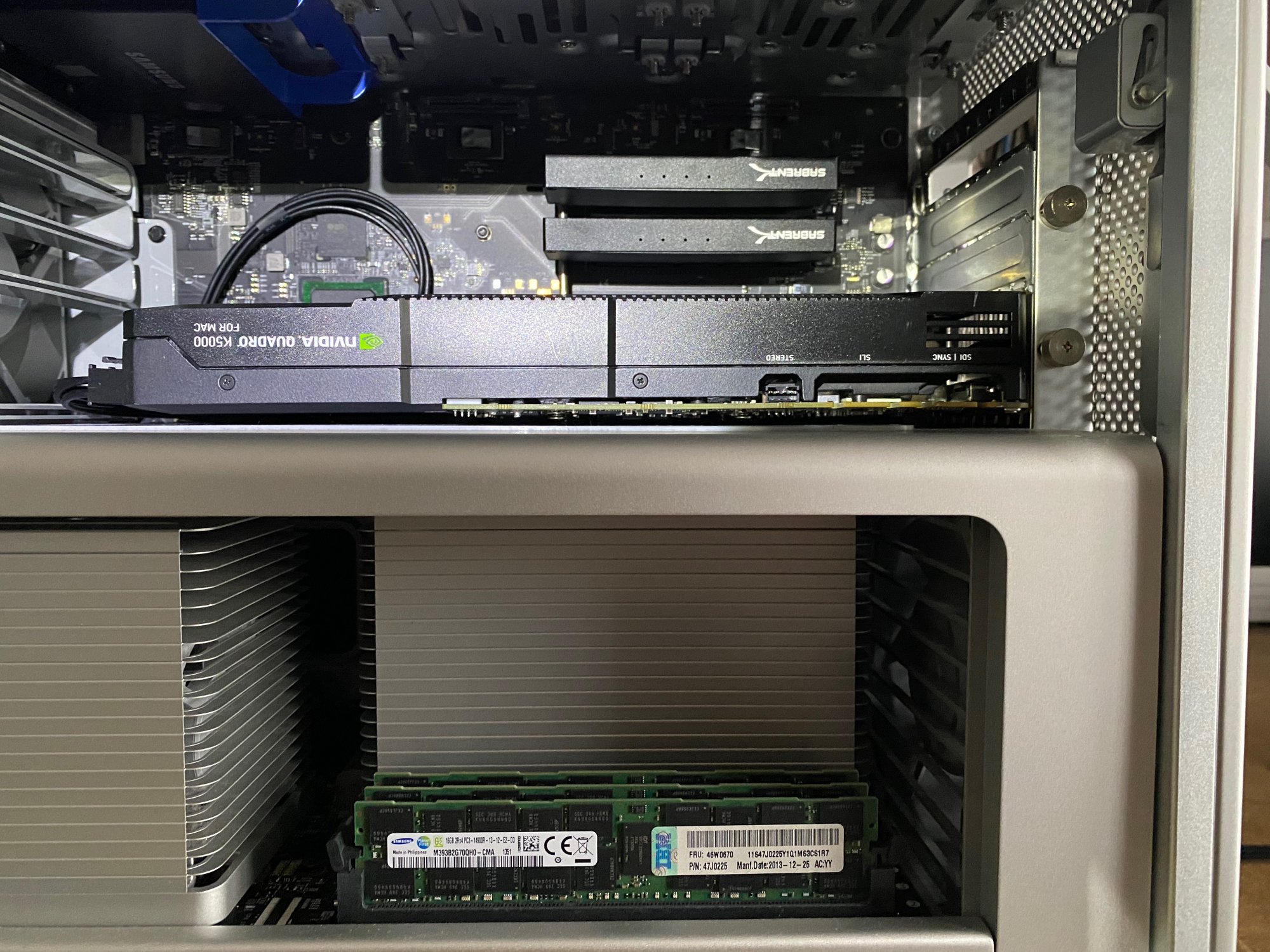

Well it turns out it is indeed a Mini 6-Pin to 6-pin cable that is needed such as this one;
COMeap Mini 6-pin to 6-pin PCIe GPU Cable
Even though it is 350mm long I dressed it neatly inside the case where it naturally forms a loop tucked up against the motherboard behind the card itself so keeps things nice & tidy and does not impede airflow from the PCIe fan;
There are two cables in the pack so I can utilise the other one if needed without re-ordering.

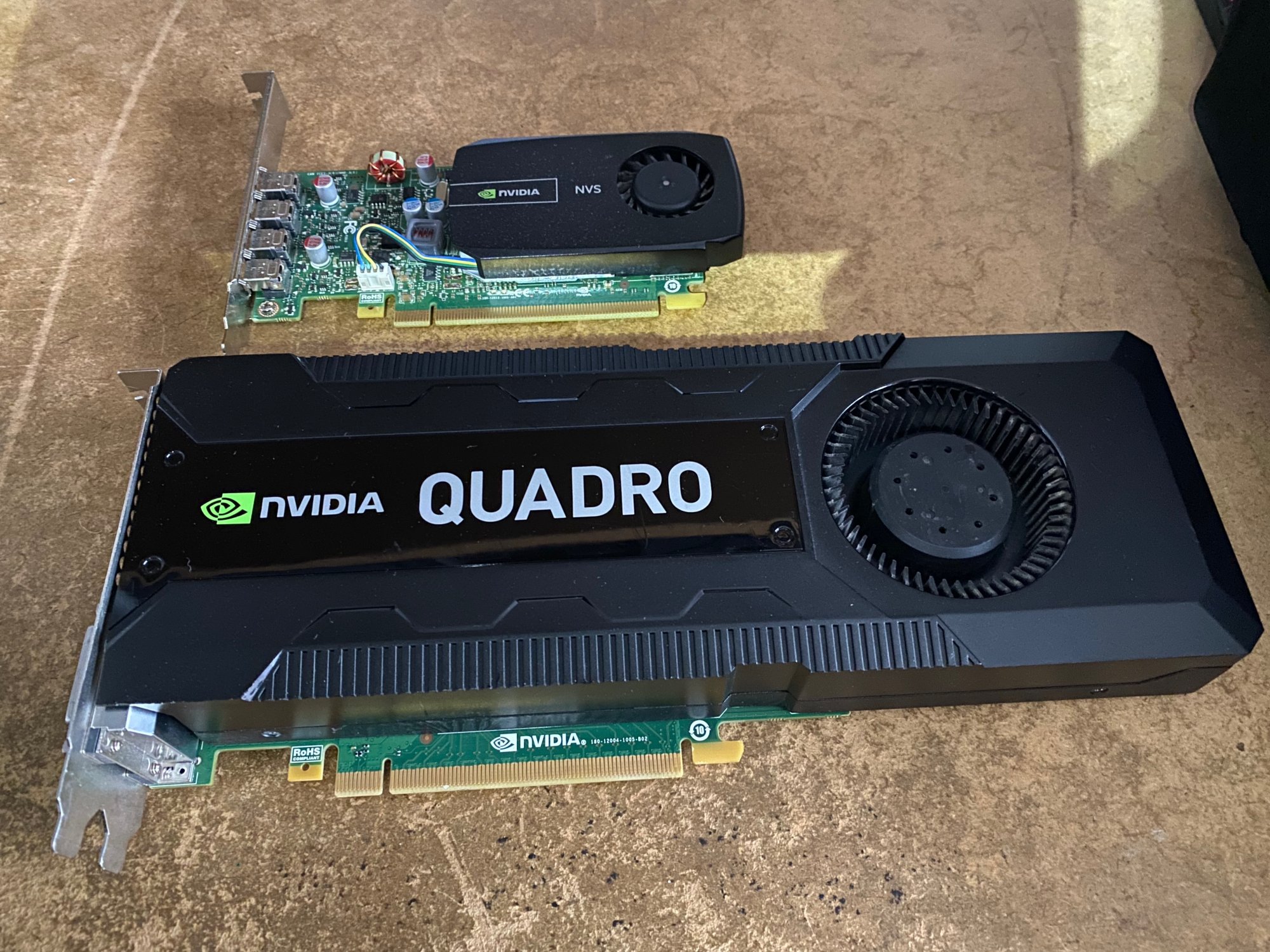

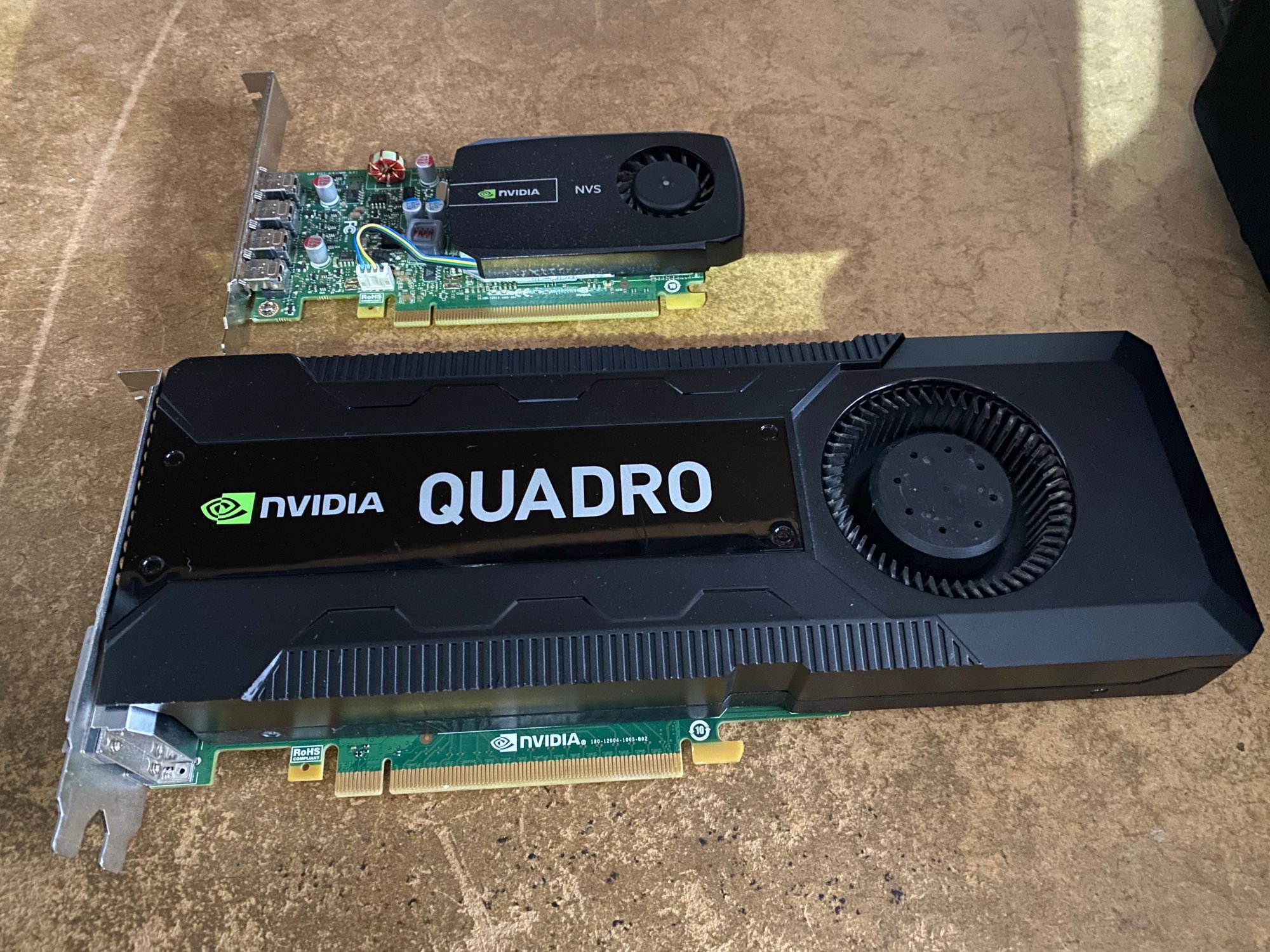

The K5000 is a huge card compared to the diminutive Quadro NVS 510 it replaced though; 😱
Mind you it benchmarks 500-700% faster than the smaller Quadro although what that means in real life remains to be seen.
