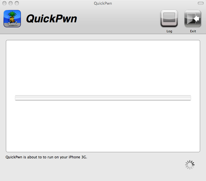

  5. Cryptonv thread starter macrumors newbie
    Joined:
    Oct 10, 2008
    #5
    Ok, decision...
    I'm going with with Quickpwn, I have already gone with it and its been stuck on this part for a while. Help?

  6. DannyBres macrumors 65816
    DannyBres
    Joined:
    Oct 30, 2007
    Location:
    UK
    #6
    have you changed the USB drivers/ using a usb hub?

  12. brianpennington macrumors newbie
    Joined:
    Dec 11, 2008
    Location:
    Pensacola, FL
    #13
    No matter what I do I cannot jailbreak my 3g with 2.2.1. I get the phone to recognize and into DFU and then the program just sits and spins. I tried both Pwnage and Qwkpwn. I even tried following the great tutorial at iClarified. I can get all the steps done but the program just sits and spins for 20 plus minutes. Locks up the whole system. I am using 10.5.6 on a 2.0g MacBook.:confused:
  13. bytethese macrumors 68030
    bytethese
    Joined:
    Jun 20, 2007
    Location:
    Cranford, NJ
    #14
    Are you using a USB hub?
  14. Moi un Mouton macrumors 68000
    Joined:
    Mar 18, 2008
    Location:
    Bracknell UK
    #15
    From the Dev Team blog regarding 10.5.6, assuming you aren't using a USB hub:
    Fixing DFU mode on 10.5.6
    As noted previously OS X 10.5.6 introduced a bug that affected the use of DFU mode. with some Macs. There have been previously published hacks and techniques to fix this, but here is another method that can be used to temporarily restore DFU functionality in order to use QuickPwn or PwnageTool.
    1. You will need an account with ADC (Apple Developer Connection) this is free and takes a few minutes to sign up, you should read the terms and conditions carefully and you should only sign up if you are thinking of developing applications in the future - http://developer.apple.com/mac/
    2. Download the disk image “IOUSBFamily-315.4-log.dmg” for Mac OS X 10.5.5 Build 9F33” (yes, that is a “5” in 10.5.5 - this is a developer debug package of the USB kernel extension).
    3. Unplug non-vital USB equipment, such as external DVD writers, USB scanners, USB mass storage devices, at the most leave a Keyboard and Mouse connected.
    4. Install IOUSBFamily-315.4.1.pkg from within the disk image
    5. Reboot your system!
    6. Perform necessary DFU activity with QuickPwn or PwnageTool.
    7. Download the disk image “IOUSBFamily-327.4.0-log.dmg” for Mac OS X 10.5.6 Build 9G55”
    8. Intall IOUSBFamily-327.4.0.pkg from within the disk image
    9. Reboot your system!
    10. Reattach your USB peripherals.
