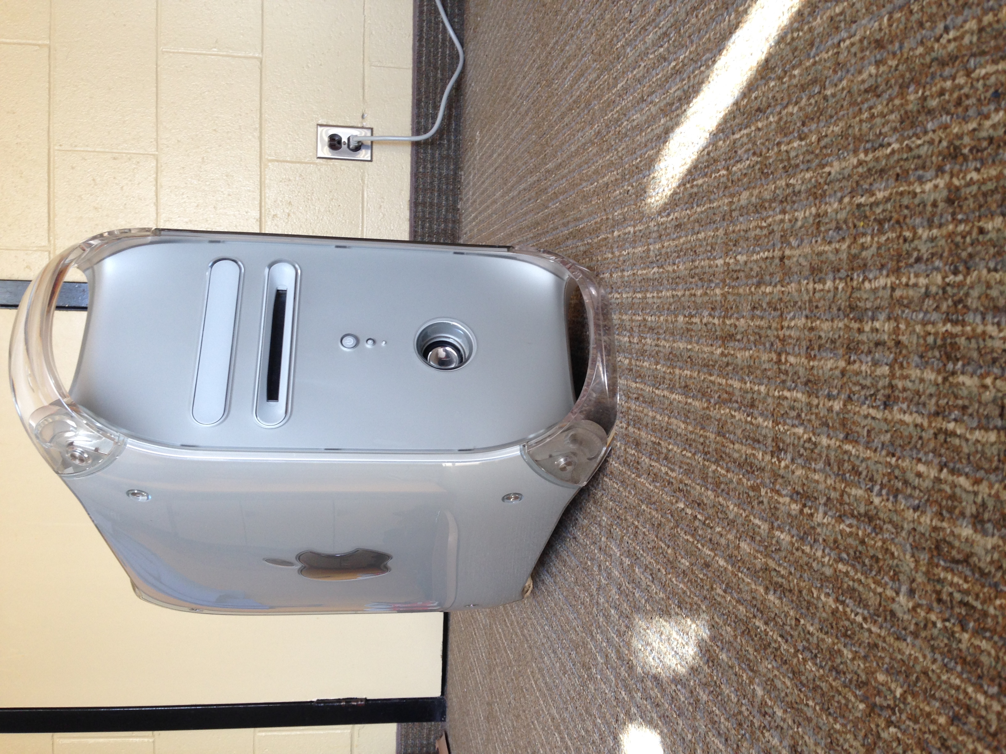

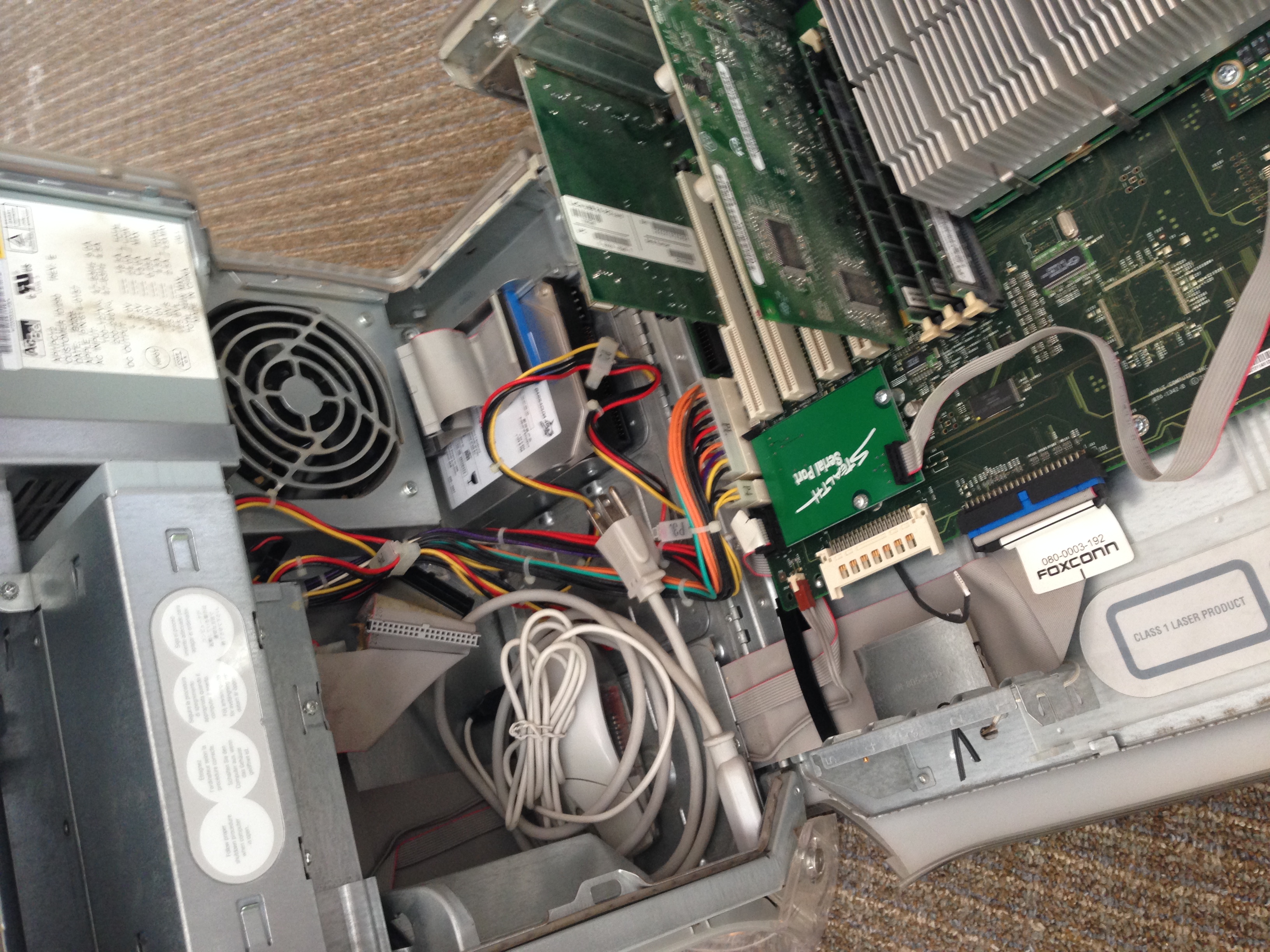

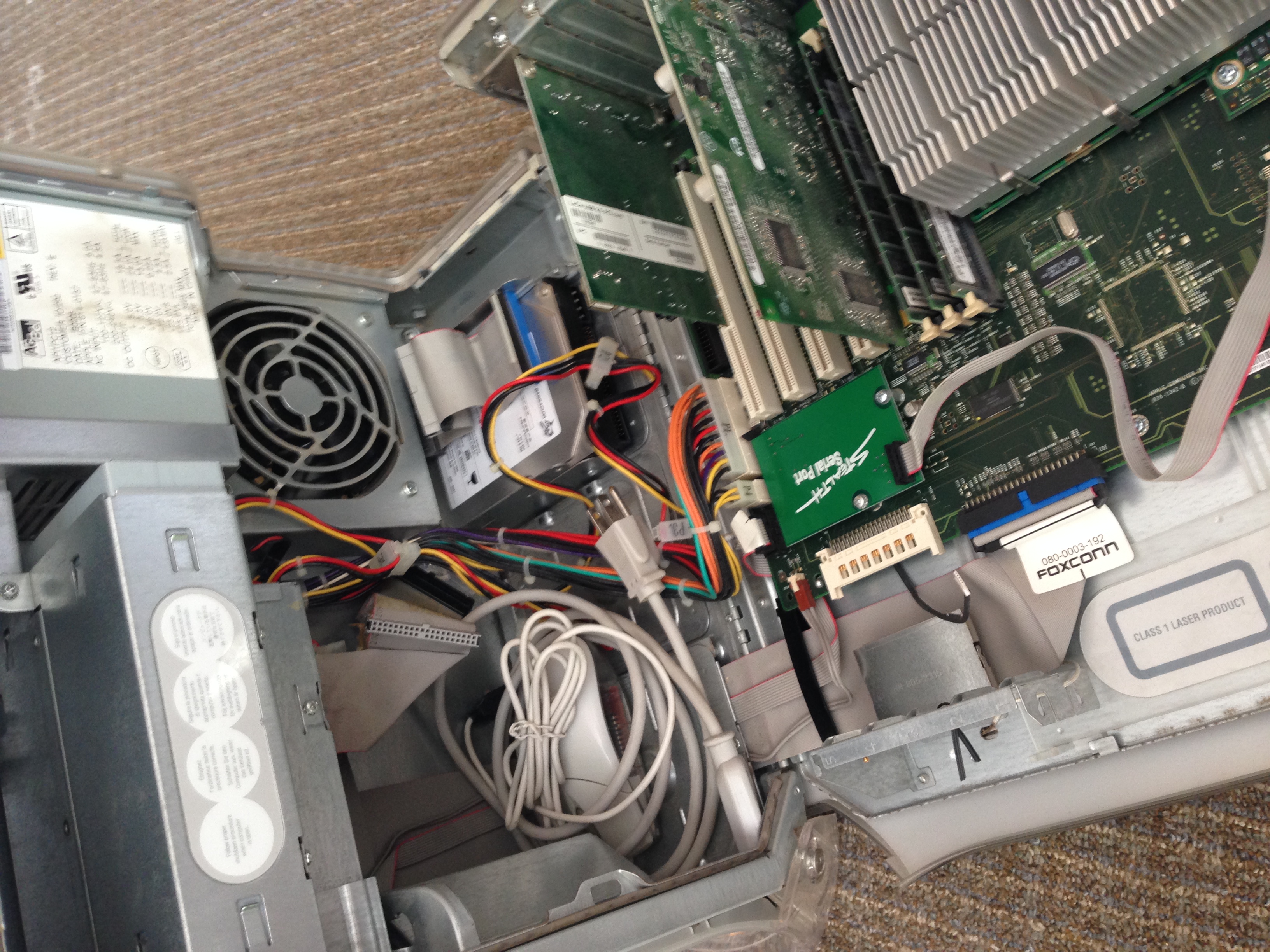

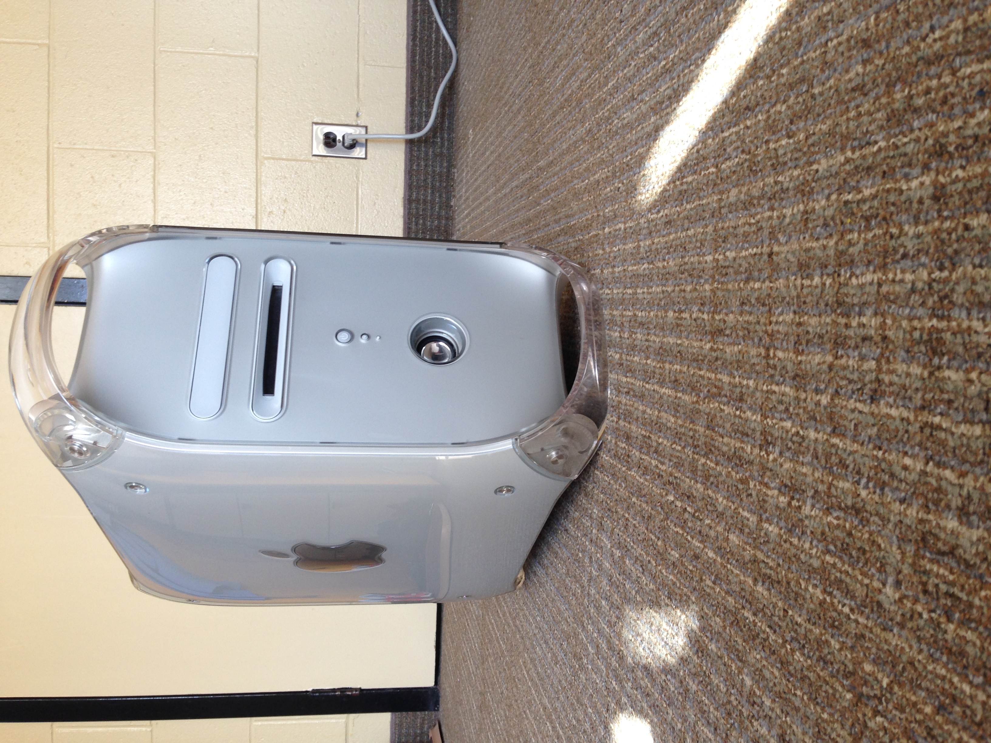

Today i managed to purchase yet another Mac. This one is my first Power Macintosh with a cool design (i do have a beige G3). I checked the tag it actually is a 1ghz DP quicksilver! The owner had adder a PCI USB card and it has 1.5GB of Ram a Zip drive and DVD pioneer burner etc.
Here is my issue, It wont chime 😕 The owner said he thinks its the Powersupply and he also knows the Hard drive was on its way out.
The first thing i get when i turn it on is the fans spinning up, there seems to be something in the Fan Under the PSU as it made some scraping noise. So i unplugged it. The Red light appears on the board and all Fans are spinning just no chime no display.
The light on the button shows when i press it thats it. Ive tried different Ram so far, removed the USB Card. IM going to remove that Stealth Serial port card aswell and blow the dust out of it. He said he added the card himself..

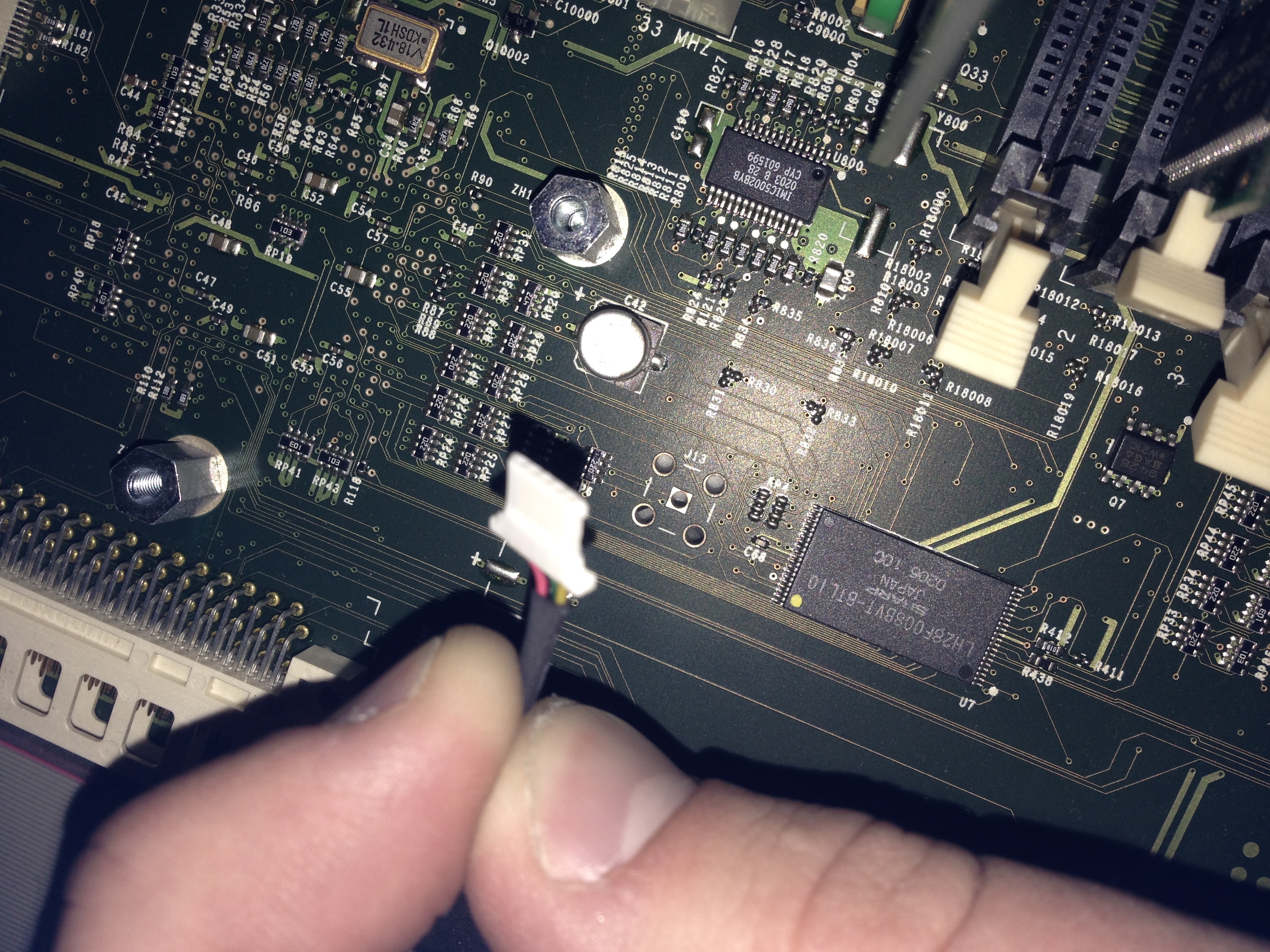

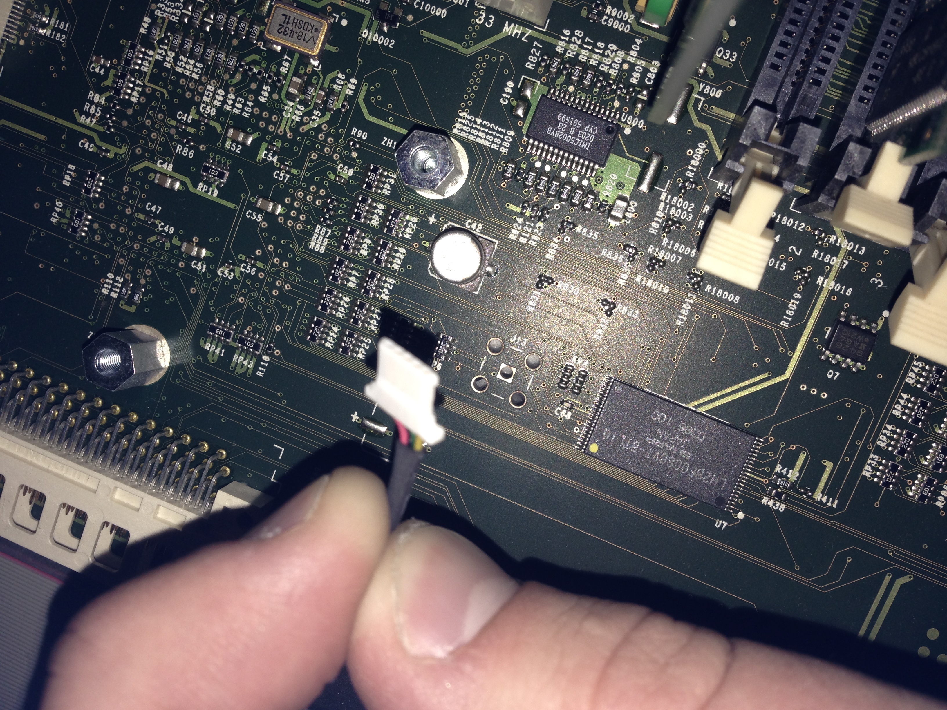

There is a cord unplugged if someone could help identify what it is. He had all the Ide cables unplugged as well as all the PSU cables other then to the mobo. Is there a way i can use a standard PC Power supply to try it?
Any tips/help is appreciated! Thanks

Try resetting the PRAM. That little cable is for the modem. If you are not using dial up, you don't need it connected.

is there a way i can use a volt meter to determine if the PSU is working? Or what? this seems to have 2 more pins making it harder to use a ATX PSU without some kind of modification...
You can use a volt meter by sticking the probes in any of the HDD or Drive power plugs. you can check the other (3.3V for example) by back probing the connector.

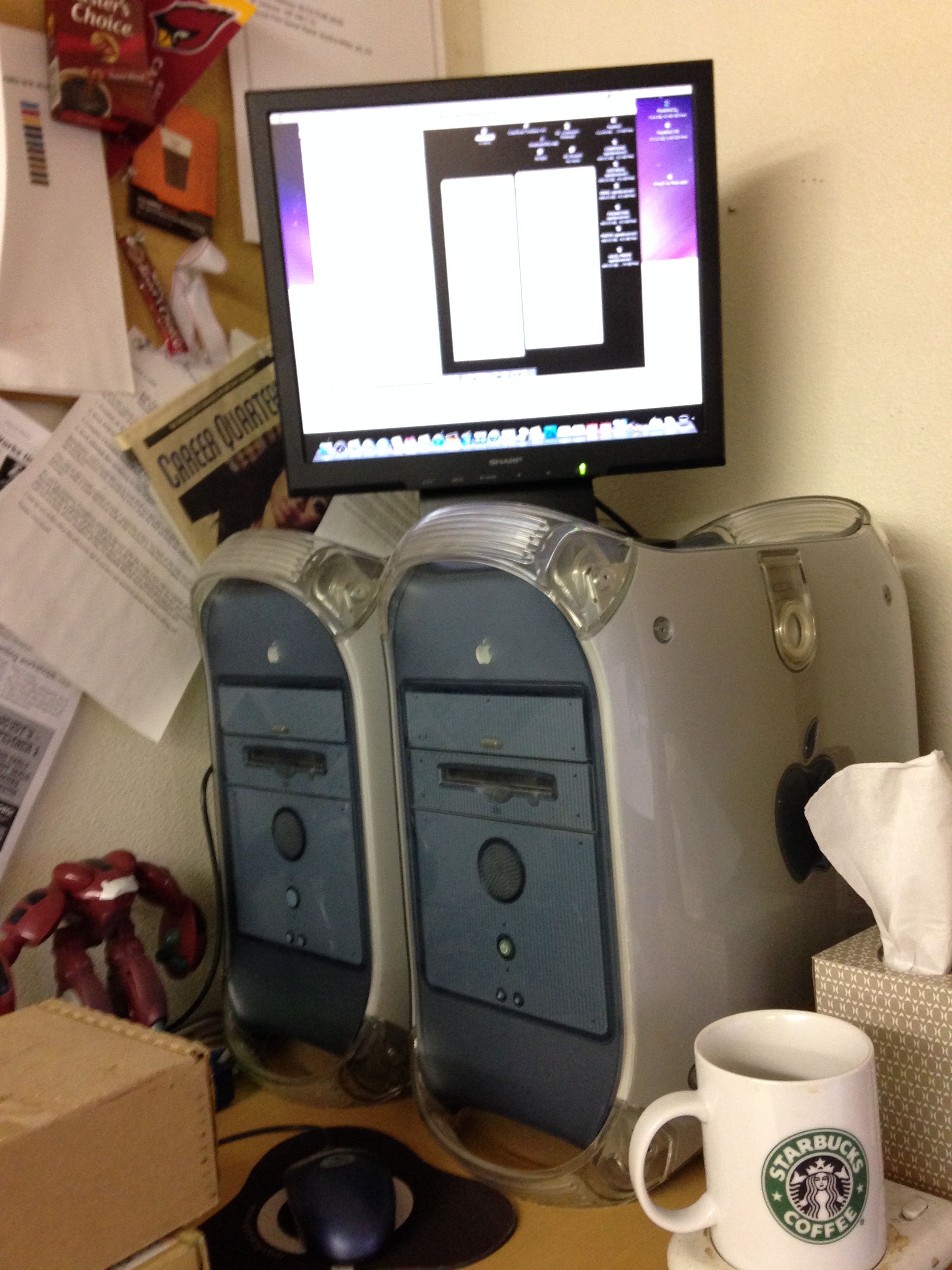

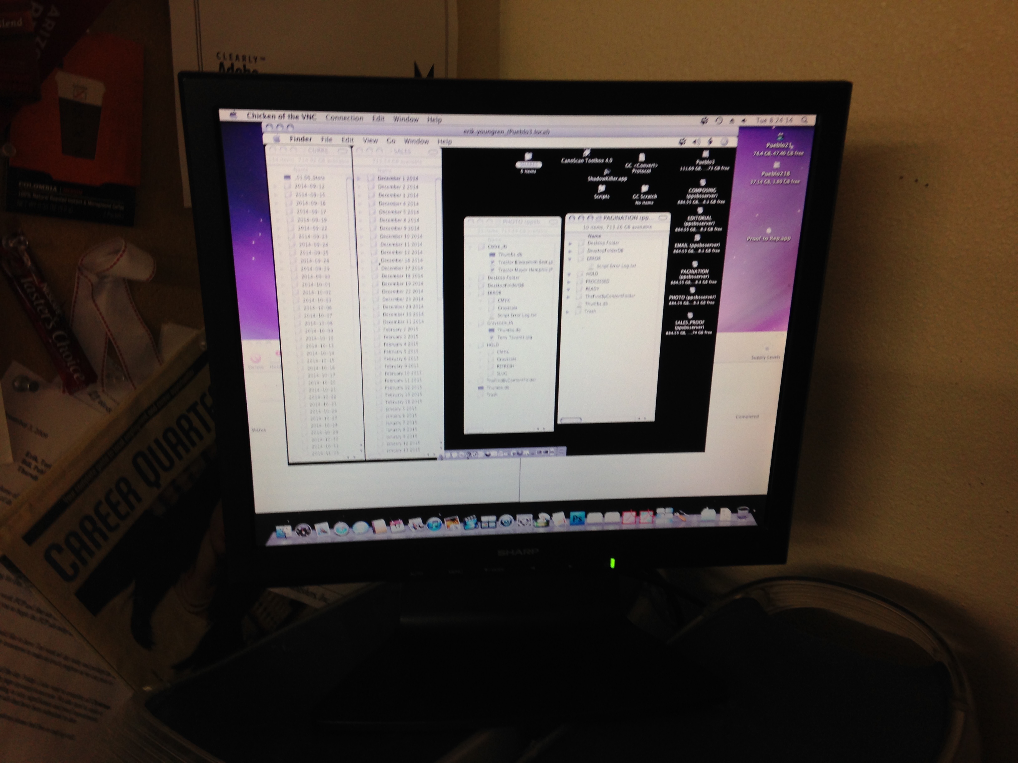

I have a G4 PCI at work that I run headless. Meaning it's running without a video card. The only way I can control it is through screen sharing.
See the attached pictures. The G4 on the left is the headless one and the G4 on the right is controlling it through Chicken of the VNC.
My point in making that suggestion was that if the video card was bad you could tell by removing it. If the Mac was otherwise ok, with a bad video card removed it would boot.
