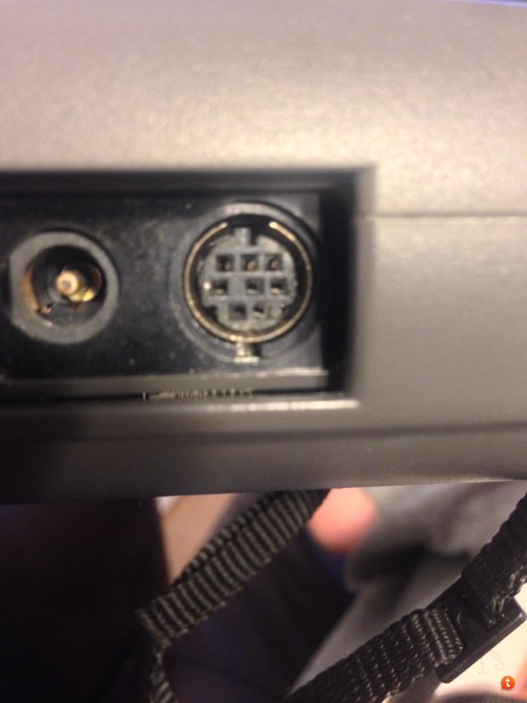

Sounds good so far. Would you know the name of the cable I would need? Want to see if I can find it locally or online. The camera works, flash works it all seems perfect and I'm really curious about using it.

This is the only connection on the camera
Yes, that's Mini Din 8 pin to Mini Din 8 pin that you'll need.
I can't find a reference to the Mac cable, only the Windows cable, however, it's apparent that a standard MiniDin8 to MiniDin8 male to male cable will do the trick on your 6500
It's the one labeled "System 8 Cable", the same one for Mac / IIgs to ImageWriter II.
Don't get one that says "Straight", or "switch box", that will just give you a headache.
That makes it a "590-0552". That number is embossed on the molded connector's housing on an original Apple cable.
Also finished goods P/N M0197
