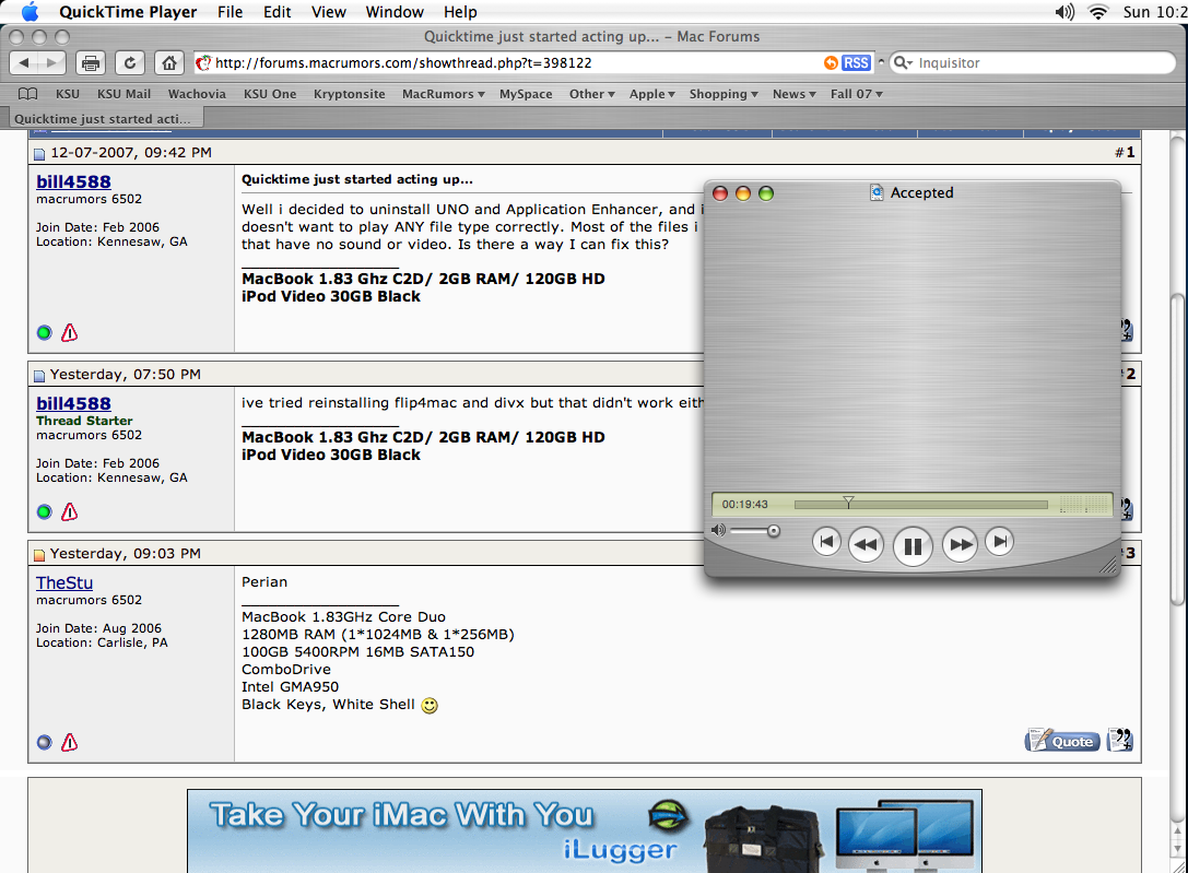

Well i decided to uninstall UNO and Application Enhancer, and immediately after doing so I noticed that quicktime doesn't want to play ANY file type correctly. Most of the files i try to play have sound and no video, but there are some that have no sound or video. Is there a way I can fix this?
ive tried reinstalling flip4mac and divx but that didn't work either. any tips?
i tried that too but it doesn't work either. this is what it looks like:

3 months later... But for anyone who has the same problem: The QuickTime-no-movie thing arises from an incompatibility with UNO. The solution is to reinstall QuickTime using a standalone installer. Also, the older QuickTime receipts need to be deleted from the Receipts folder, in order for the installer to work.
This works!
I uninstalled Uno (Restore), went to HD/Library/Receipts and removed ALL QuickTime Receipts, Including 7.4.1 (I'm running Panther 10.4.11), went to Apple downloads to get the stand alone installer for my system, ran the installer and restarted. Bingo. I've got Picture again.
