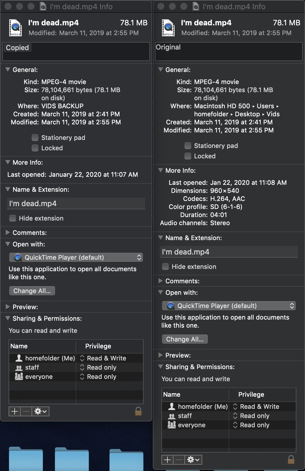

5. Can you post a comparison screenshot of the Get Info window from an example original video file and a copied video file (blurring out any personal information, of course)?
Enclosed, with copy on left and original on right.

Hi again, Shawn C,
Hrm, based on your Get Info screenshot something is causing the file attributes (Dimensions, Codecs, Color profile, and Duration) to be trashed on the copied file. A few more questions...

Hi again, Shawn C,
