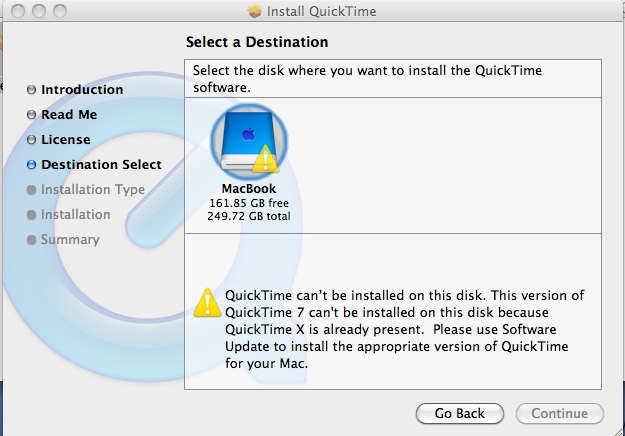

Hi guys,
I accidentaly AppZapped my quicktime and after that cleaned my trash can so it is completely gone now but when I try to install quicktime again from the apple site, it tells me that QuickTime X is already present and it can not install the file I am trying to install.
I've attached an image of what is happening and I'd really appreciate if someone can suggest what to do on this quicktime issue.
Thanks so much in advance,
Dogan

Which version of QuickTime did you accidentally remove? 7 or X? You *may* be able to reinstall QuickTime 7 by using the installer on the 10.6 DVD. However if you're trying to get QuickTime X back then you're most likely looking at an OS reinstall.
I feel like I had the X version. Everything on my mac was up to date. That's why I assume I had the X.
I guess I will do a clean install.
Thanks guys.
Could it be that it's just an installer receipt that's stopping it? Go to Library/Receipts and see if there is one for Quicktime there, and delete it if there is.
Hi Jackerin,
I've done that too before. There was a quicktime file there and I deleted it but still when I was trying to install it, it'd give me the error.
