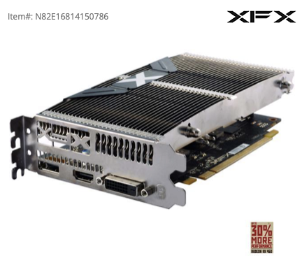

Well there was this XFX RX 460 4GB (and 2GB too). I even bought one, but decided to return it, and swap it after reading the forum a little bit. I chose GTX 1060 6GB instead.
But yes, there has been a reasonable Metal compatible card. Now it's hard to find, and XFX brand is not the best for Macs, I have read from here and there.

Is there really no fanless / totally quiet / passive cooled GPU for Mac Pro 5.1?
That depends on :
- the performance you need
- the OS you're running
Short version: for Mojave and up only nVidia Kepler family cards are supported and AMD cards ( see GPU sticky thread for further info).
If you specifically want a passive cooled GPU there's a GT710 passive version (MSI I believe) and there was a GTX680 passively cooled version.
Otherwise lots of modern GPUs only ramp up the fans when a certain Temp is reached , so under light/medium use there's no GPU fan spinning as for example the RX580 Sapphire Pulse.

Radeon VII is special, no 3rd after market options. All Radeon VII are reference, with the same firmware basically.
In general, XFX cards works on cMP. However, some after market options has highly customised PCB, which also shipped with a tailor made firmware. And some of those cards doesn't works well (or even can't boot) on the cMP.
Therefore, for those who don't do their study, better just avoid XFX completely.
