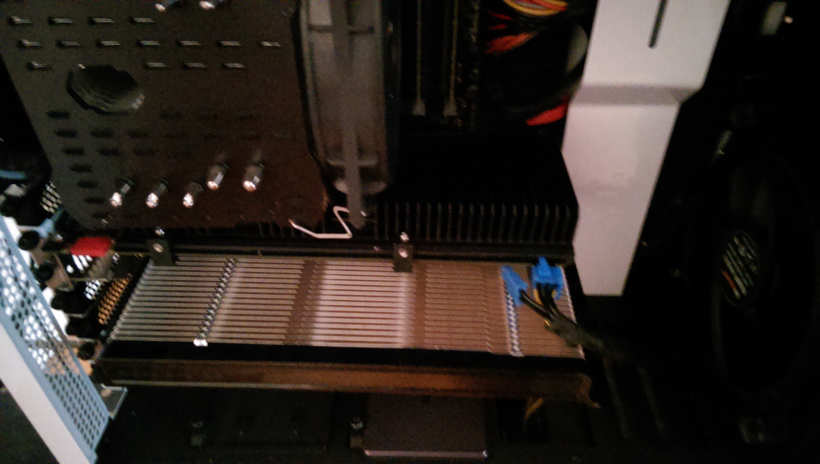

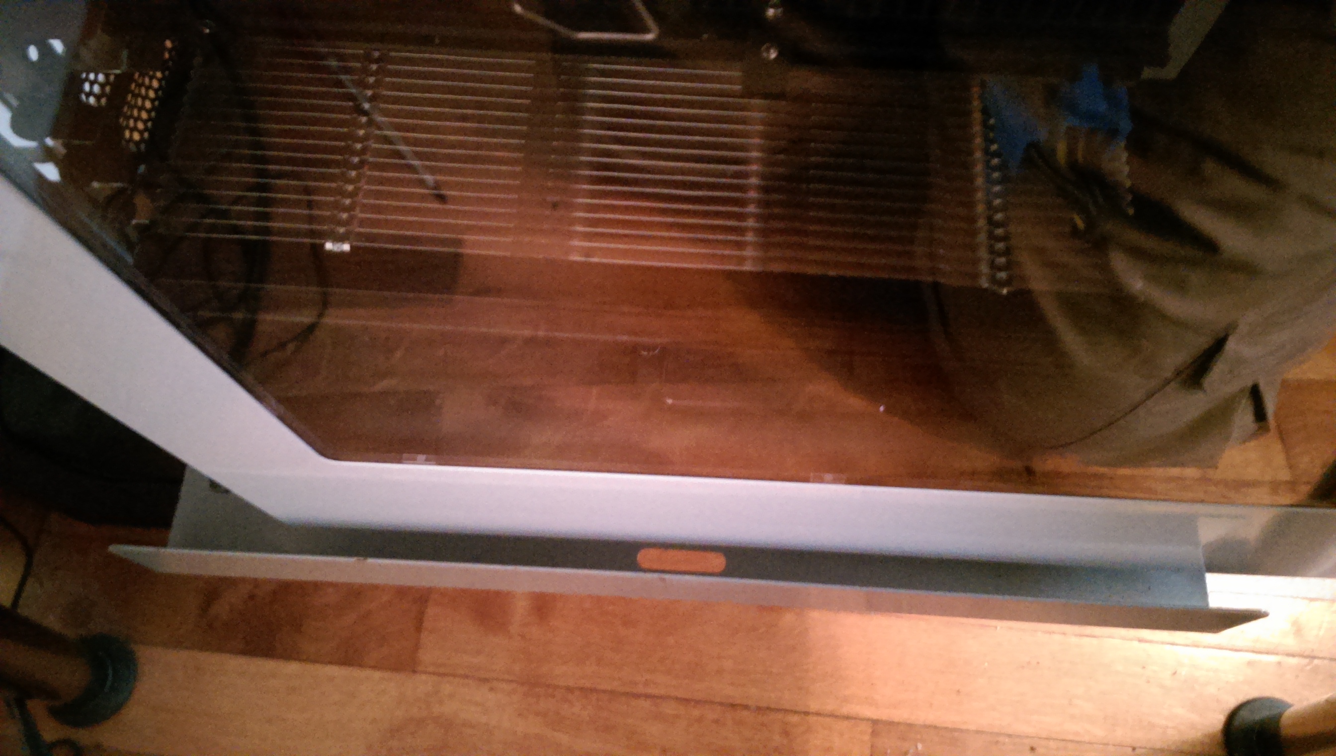

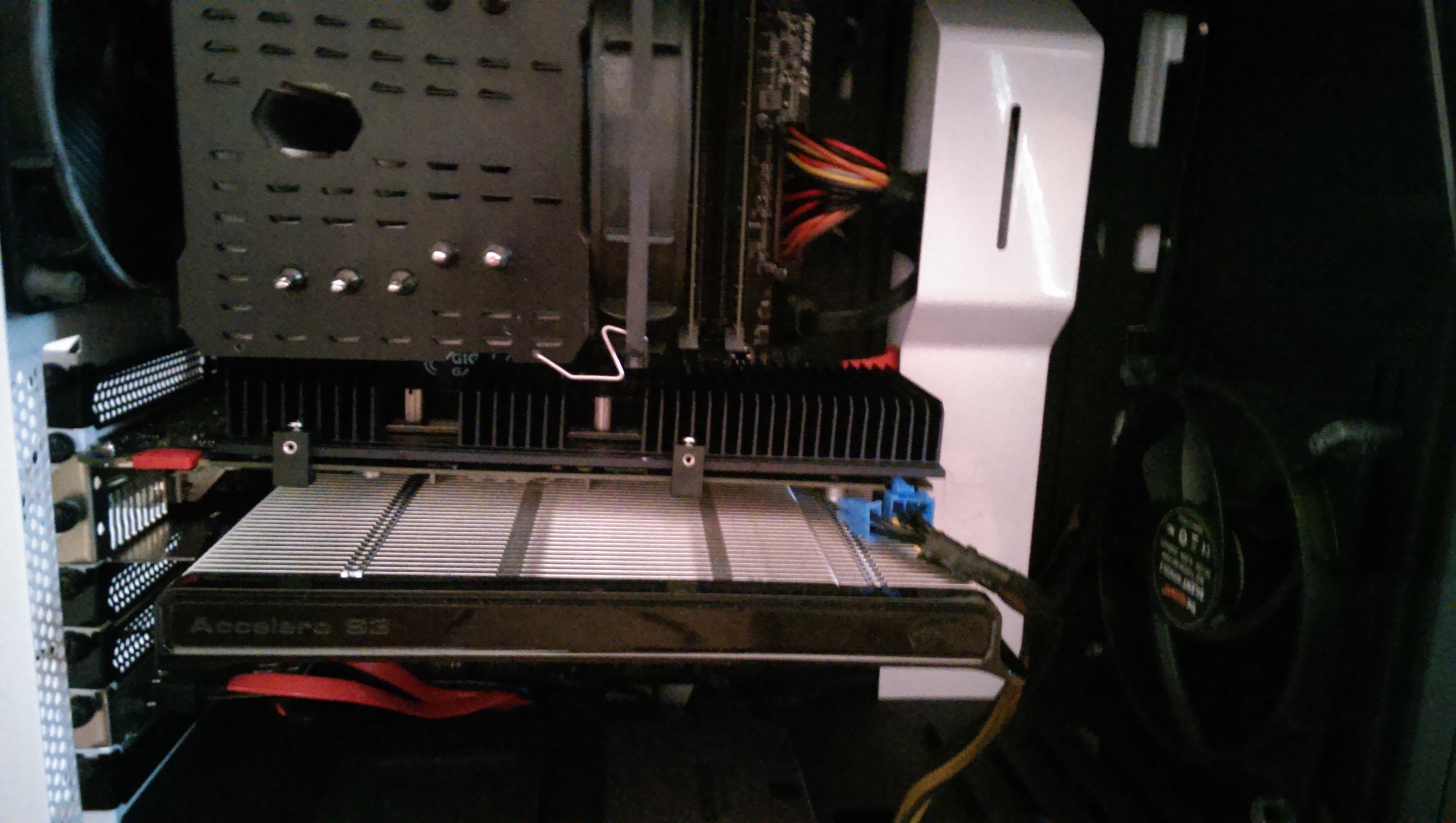

It's a huge son of a gun and the most non-German thing I've ever installed. The installation guide is clear as mud and doesn't list the card as being supported so it's a play it by ear sorta thing. If I were thinking of putting it in the MP I'd measure the heck out of everything before, it's WIDE. The plus side is my PWM fans are now stopped which they never were so it is displacing heat better than the MSI cooler did. I'll dink around with it tonight then heat it up tomorrow, I'll probably have to change to positive case pressure, but I'll know tomorrow.
