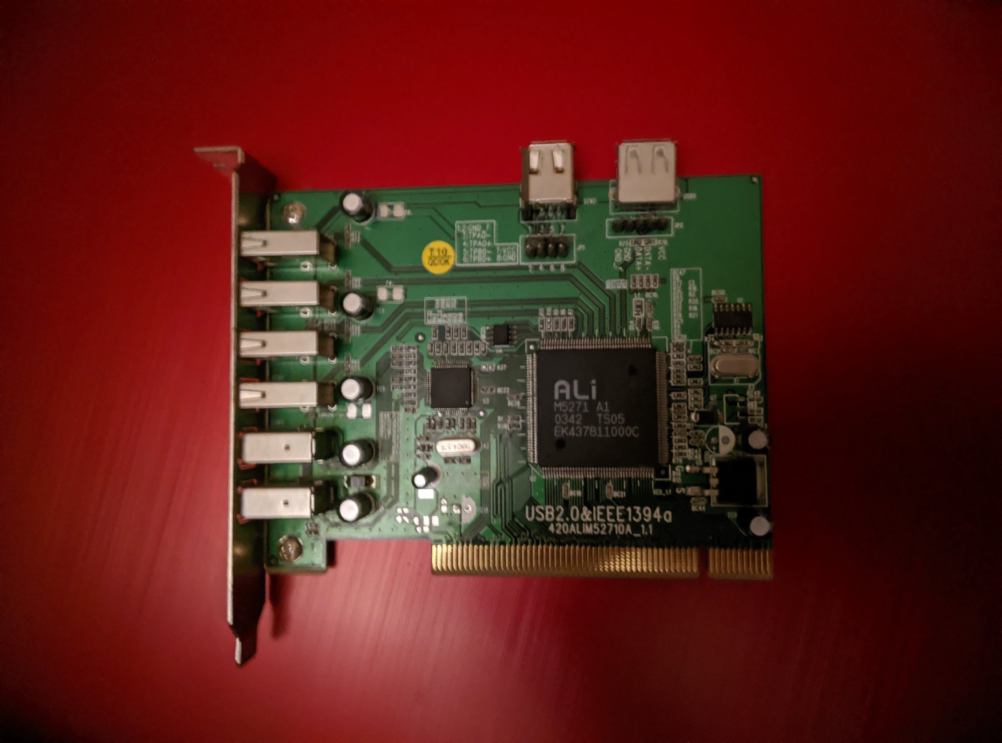

So, I was looking around for anything I might already have to add to my nice new acquisition, and stumbled on my old pci usb2/firewire card. And once I got it in, the thing wouldn't boot. Absolutely nothing happened. After messing around with it, I got it to boot, but it said some of the ram was no good. After pulling each stick, I've come to the conclusion, that the ram slots are just loose. Is this just a common issue with these old computers? I hadn't seen it anywhere.
Here's the pci card in question, btw. I couldn't find anything about it specifically, but it looks like you can still buy cards with the ALi M5271 chipset, and they seem to work all the way down to Mac OS 9, no driver needed, at least. My problems were all in the ram.

And fixed. The card works perfectly so I clearly made a good choice way back around 2004 when I got the thing. I kind of have to wonder how low a version of Mac OS I'd have to go before it stops working, but getting it into the system was such a pain I don't want to touch it.

That's fair. I do know bad RAM/slots is something that can cause strange issues on most computers, especially Macs of this age. If it doesn't require extra drivers, then I'd suspect that any version of Mac OS with built-in support for FireWire and USB PCI cards could handle it.

I'd go so far as to say the ram actually feels loose. I didn't think that was an issue at first, but as I diagnosed the issue, that's all I could come up with. Fortunately, I was able to get all the sticks of ram it came with working, and that's a mix of unmatched 512 mb sticks, and one 256 mb stick. The system came with proof of a power supply refurbishment, for what that's worth, I do get the impression that it was a cared for machine.

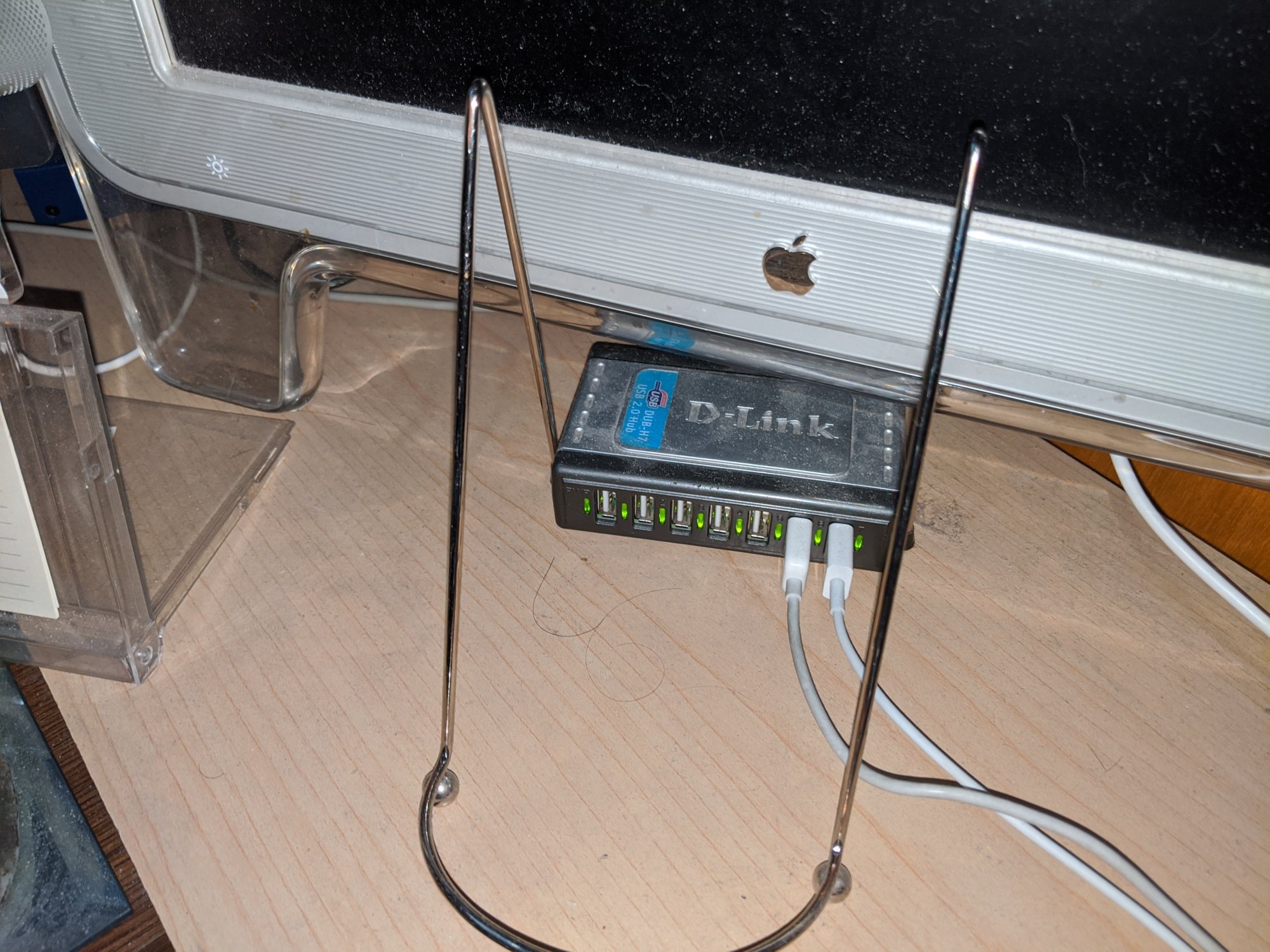

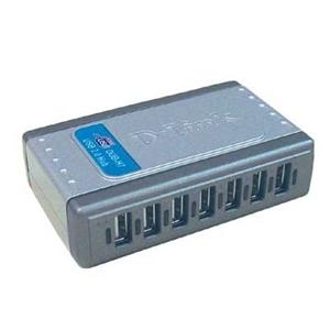

In the last two years I've picked up two of these for around $20 (D-Link DUB-H7): https://www.ebay.com/itm/D-link-DUB...sh=item2ade834c98:g:zKIAAOSwwD1eF~8L&LH_BIN=1
7 Port USB 2.0 hubs.
