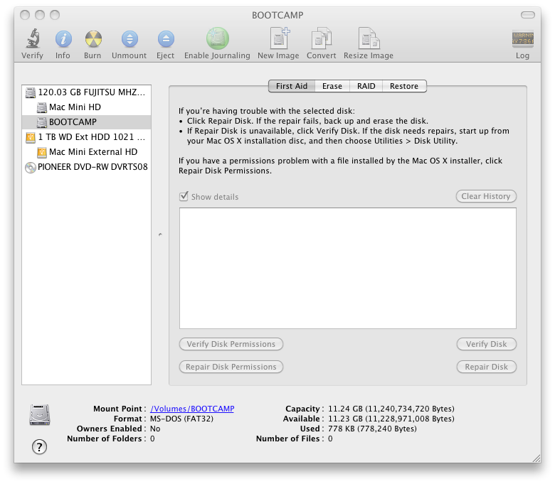

so i started partitioning some space for windows today, and decided i wanted more space so i canceled it. Than i tried it again and came up with error of not being able to move files and to reformat it as mac os extended journaled. so i went to disk utility but i t was already that format. then i noticed in the side by all the drives there is one called "bootcamp" even tho i didnt make it. Than i went into bootcamp and its like its installed and the selections are to create or uninstall windows and start windows installer windows.
when i click uninstall it only sees my mac partition....so in order to fix this problem do i just erase it from disk utility? if so how?

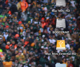

its also appeared on my desktop

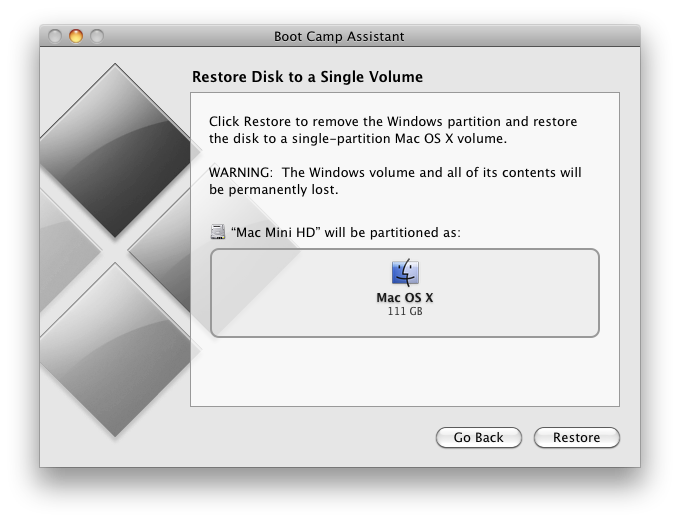

EDIT: or is it only showing my mac cuz that s what its going to be after i hit restore?? (on third picture)

Boot Camp Assistant is the way to go and these are the windows you will see during the use of Boot Camp Assistant removing the Windows partition.
ah ok thanks i wastn sure if there was supposed to be a windows partition to click on and THEN hit restore....thanks
