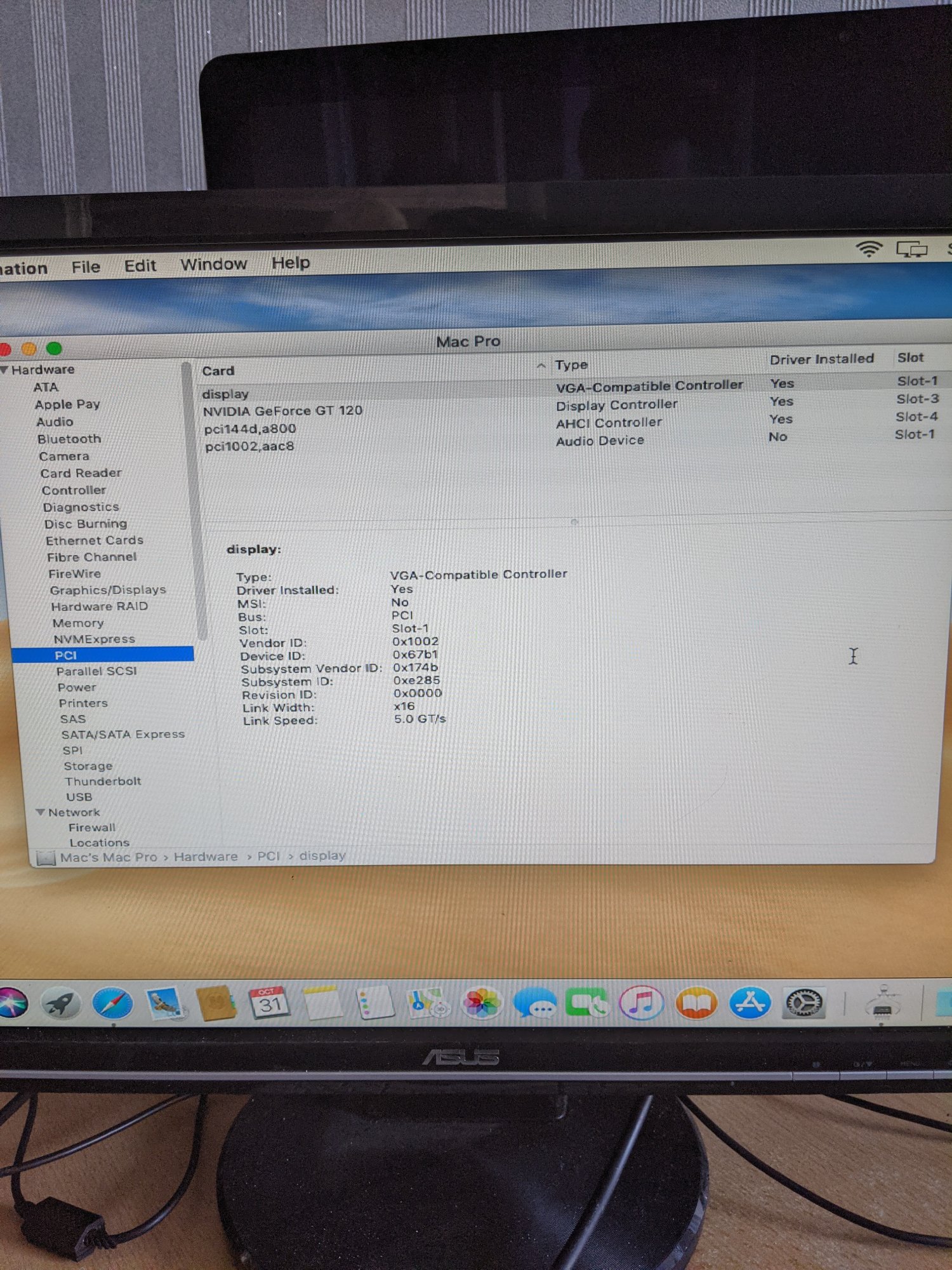

I connected the 2 monitors at the same time and got these infos( see pic ):
An other update: Now it boots only if I have installed both of the cards (gt120 + r9). It does not boot with the gt120 whereas it did until I put both of the cards in to see what's going on.. It is pretty confusing... Btw I install Mojave with dosdude1's ratchet.

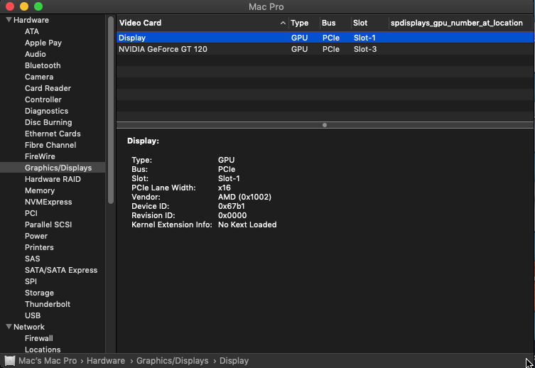

Thanks for the advice. I installed high sierra to see if the problem still occurs and it does. I clean installed it (wioed my drive, downloaded installer from app store). Although my gtx 560ti gets recognized and it works properly. Same issue with the r9 (recognized as display, says no kext loaded). What am I doing wrong..

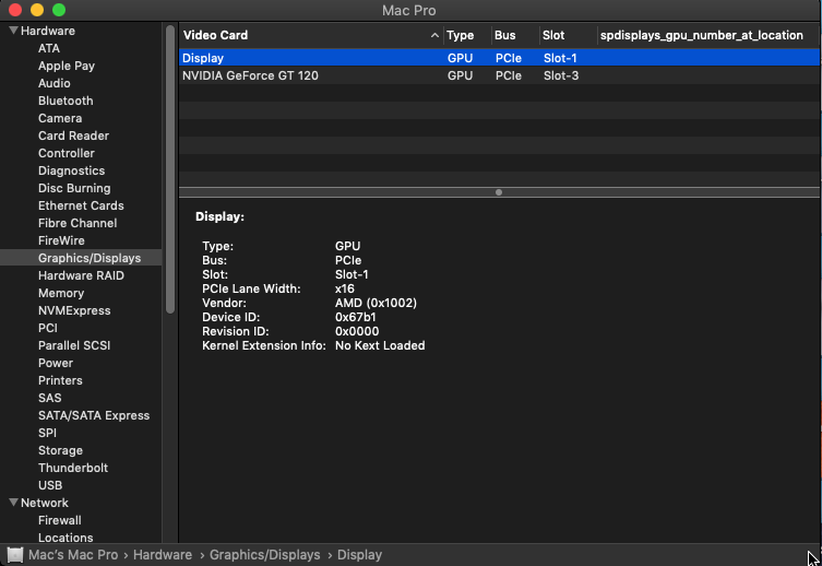

And thanks again for the fast replyView attachment 1884966
OK, I see. You haven't done anything wrong. Apart from your GPU isn't 290X, but 290.
Device ID 67B1 (R9 290) is NOT supported.
The supported one with device ID 67B0 (that's the R9 290X).
