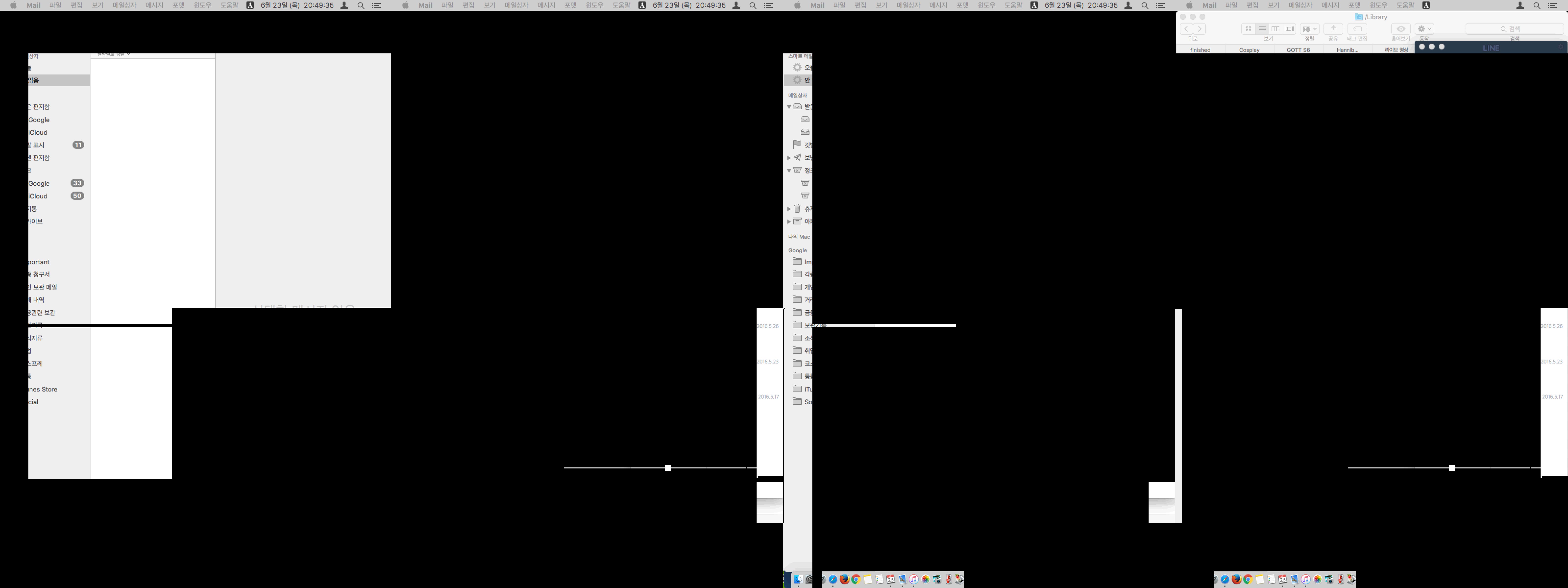

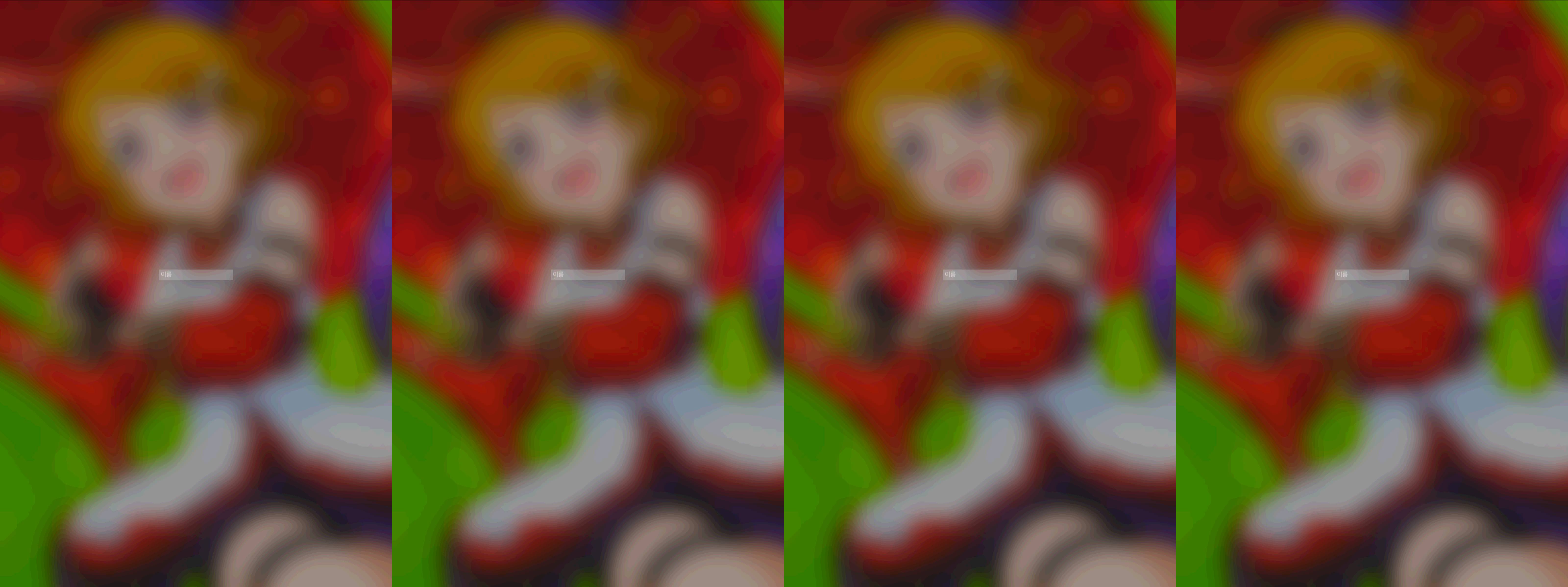

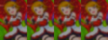

When I access via VNC, I can see four 800x2400 size desktops like following screenshot. IMG_1720.JPG
I could log in, and according to apps open screen is flickering, and broken like following screenshot whenever I tried to move cursor, switching apps and try things, etc.
There was no change when I plug display (I use DVI port) in or out.
Would it be driver and/or port issue? Or my card is just damaged?
It bugs me that box was not sealed when I take it from the seller.
Take a screenshot of the graphics section in your System Profiler.
Can't launch System Profiler on R9 380 because screen is broken and I cannot recognize where I'm clicking. Even though I could launch System Profiler using keyboard shortcut, I think I cannot move to graphics section. I'll try it by memorizing menu location and practice keystorkes. Will upload screenshot if success.
