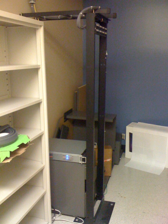

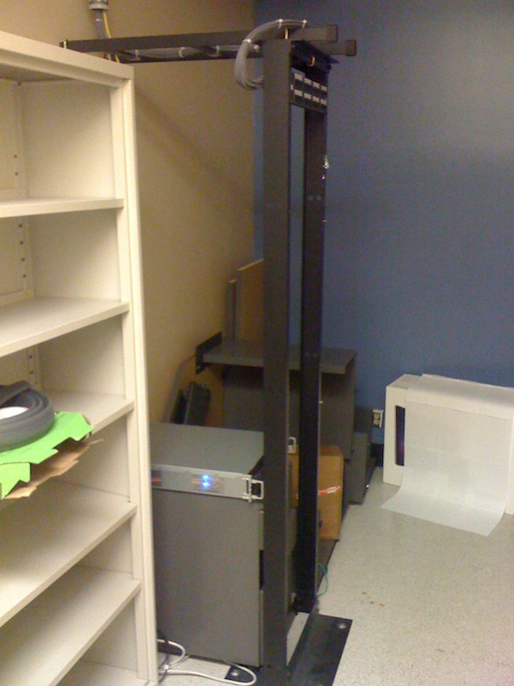

I don't know what the rack was used for before. Pic attached. Not sure if I can buy the rear posts or if I simply need something else.

Yeah that's a two-post rack, normally used for patch panels and telco equipment.
You'll want to look at getting a four-post rack like this, they vary in price quite a bit depending on features and brand, if you don't need a full size rack you could go for a 24U rack like this one.
Personally, I wouldn't recommend an open rack. You're definitely better with a closed cabinet.
Not only because of security issues, a closed rack also reduces noise and lowers the effort (hence cost) for maintenance as most of them will come with integrated dust filters.
It also seems as if you won't require a full size 42U rack/cabinet. For only a few servers/storage systems, a 12U might be sufficient and of course, cheaper.

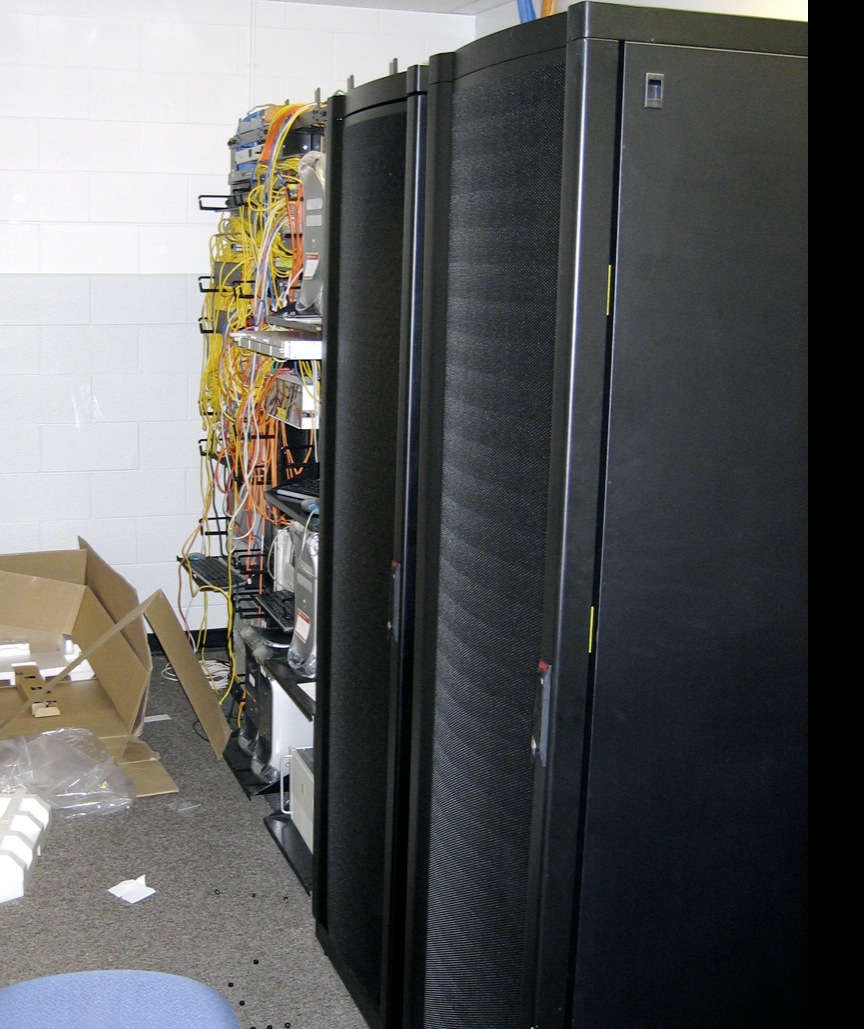

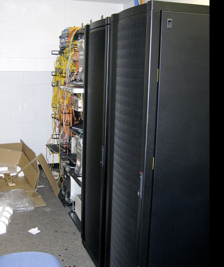

I had those same open racks for patch panels, but i had a Mac Pro server I needed to get off the floor. they have these shelving units you can buy that bolt on either side that worked great, and even for a time held an Xserve. If you just have a small server and are experimenting, there is no need for a cabinet. a deep racked unit can be quite expensive. my half-height one was 800, the full were 1500.
you can just see the shelves in this pic i took a few years ago, can even see the xserve there.
why spend good money if it might be temporary?

if you do have a 2 post rack, you can look on ebay or other places for a chatsworth server mounting kit. it basicly extends mounting points in front of and behind the 2 posts to screw your rails to. if you need, shoot me a msg off list and I can find the product # for you.
