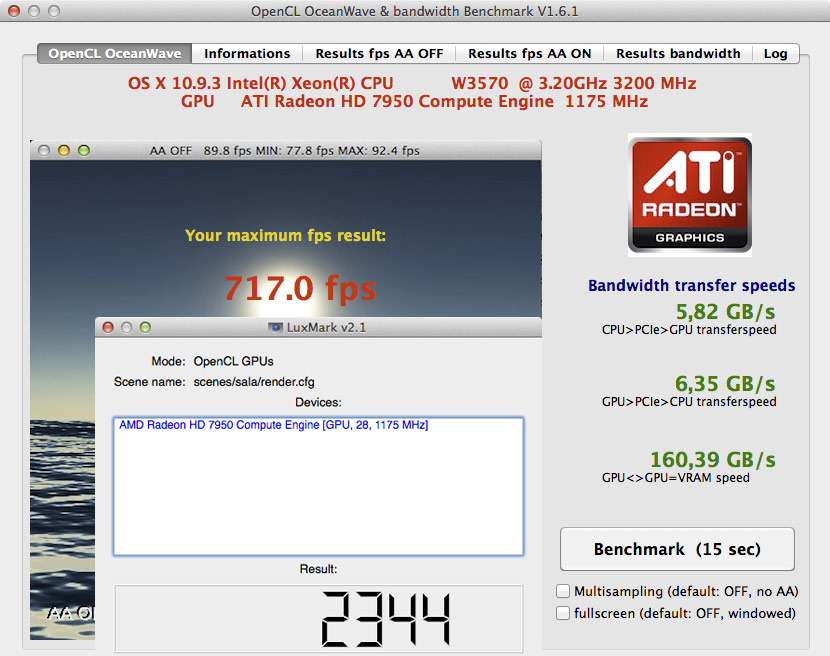

FWIW mine 7950 WF3 @1175/6000 does BruceX in 40s (to ProRes 422HQ). MP 4,1/5,1 W3570, 48GB 1066 MHz, stock 640GB HDD, FCP X 10.1.1.

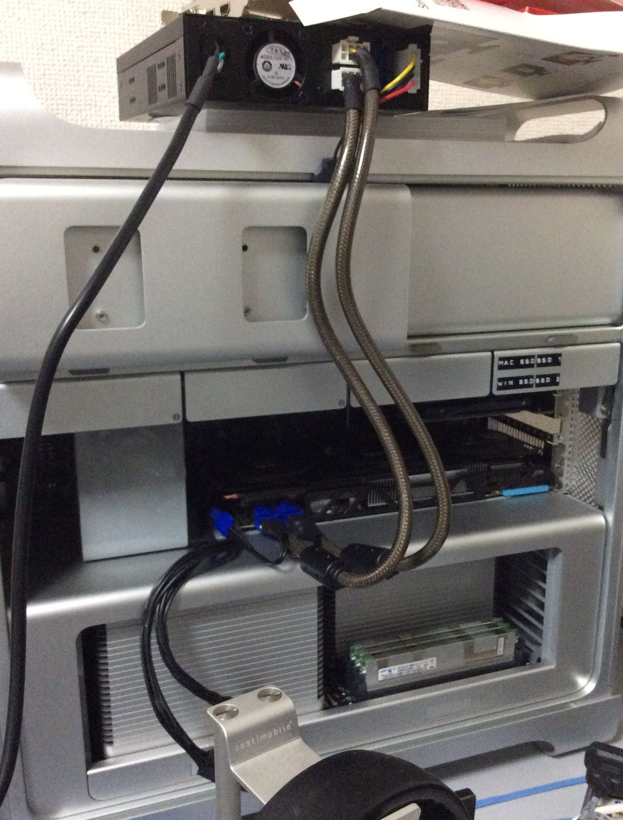

Feedback on AUX Power and 280X in cMP 5,1
Just want to update this post, I can confirmed that 280X works well in Mac Pro 5,1. But I could not run the card at factory clock using the internal pcie power. It would run fine, but furmark and occt will shutdown the computer, maybe it could be done while lowering down the voltage. I bought an aux power separately so did not bother too much testing further with the internal pcie power from the motherboard.

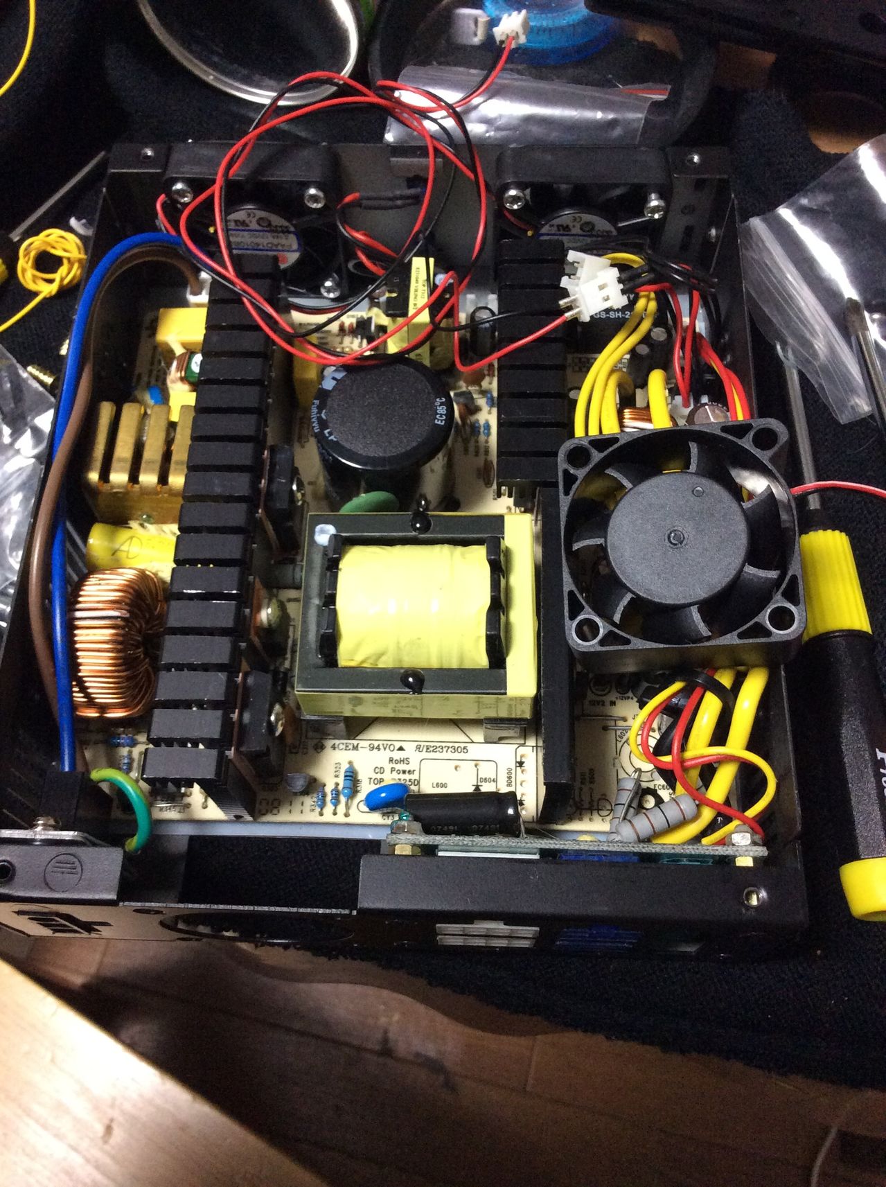

For those of you who are planning to buy the ePower juice box, please purchase some quiet 40mm fans. The first thing I noticed when I was testing the unit, is that the fans (3 in all) are extremely annoying (up to 35 dB @ full load). I replaced the fans yesterday with some ultra quite ones, below is a picture of how the epower looks inside.
What fans did you put in? I might be getting the same PSU and would like quieter fans.
Hello, good question, the brand name is Tranyoung Technology (T&T). It was purchased on ebay, however any 40mm fans will do.
I would suggest to check the AUX PSU fan noise when you receive it, mine was noisy from day 1. Surprisingly, some of the members here mentioned that the stock fans are very quiet (so it could be that mine was faulty).
So check the noise level when you receive it, if you are lucky, no need to purchase new fans.
