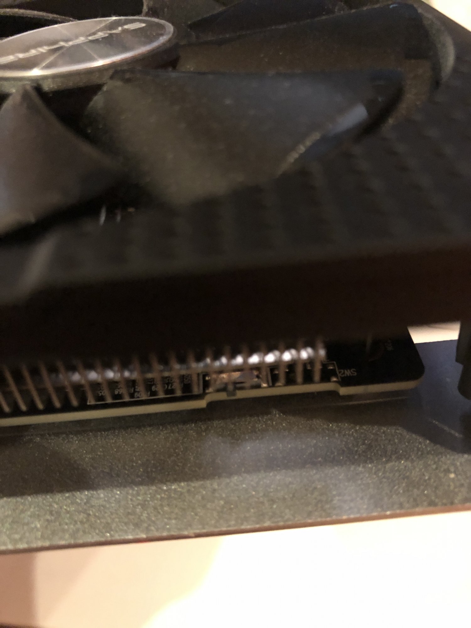

Remove the GPU and I inspect. Use some compressed air on the PCIe pins and check/inspect the PCIe slot. Reseat the power cables.

removed and replaced the card several times, no change.

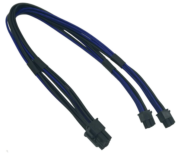

1. Shut down the cmp
2. Remove the power cord.
3. Remove the RX580 AND it's power cable which should be this one . . .
Dual mini 6 pin to single 8 pin

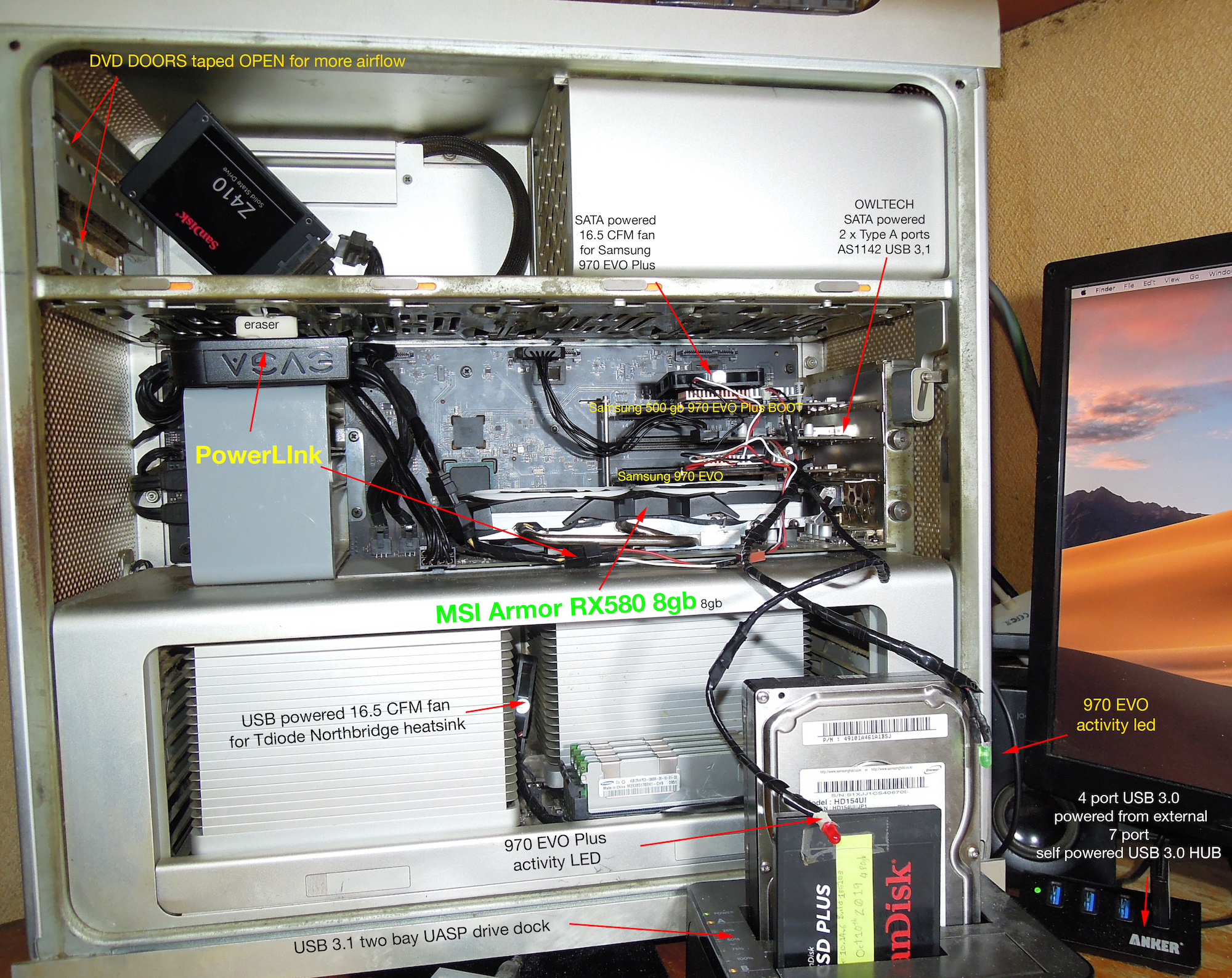

I use an MSI Armor RX580 8gb ( single 8 pin power socket ) in a 4,1>5,1 cMP with the above power cable running through the wonderful EVGA PowerLink as shown here.
When I run X-Plane 11 I also add a SATA to 6 pin cable to the EVGA PowerLink
No problems whatsoever.
