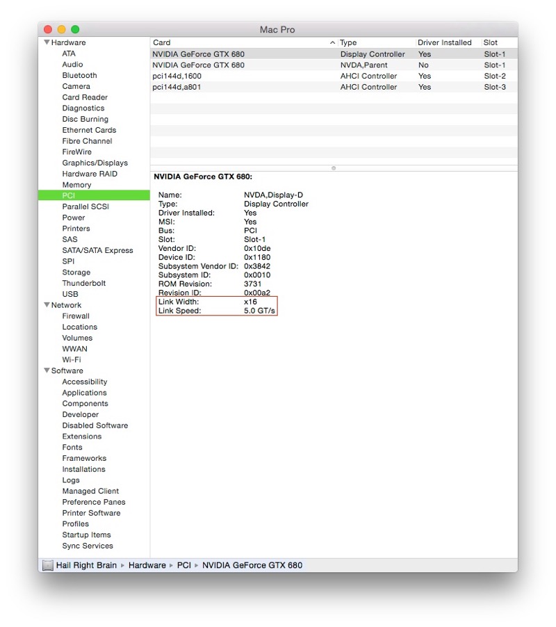

If you are connecting any displays that are greater than 1080P DVI or Displayport is the best method. If going 4K Displayport is the only method to get 60hz.
You need to remove the R17 resistor on the 7950 to achieve 5GT/s link speed. One can achieve the same with the flashing done by MacVidCards.
Without a 5GT/s link speed you are essentially crippling your upgrade to half of its performance.

Does the 7950 not work out of the box with 5GT/s speeds in OS X? :O
I thought the EFI flashing just enables it for windows?
Correct, to my knowledge nVidia uses soft hooks, AMD uses hardware (resistors). Flashing gets you efi but it's only 2.5 GT/s until the resistor mod.
