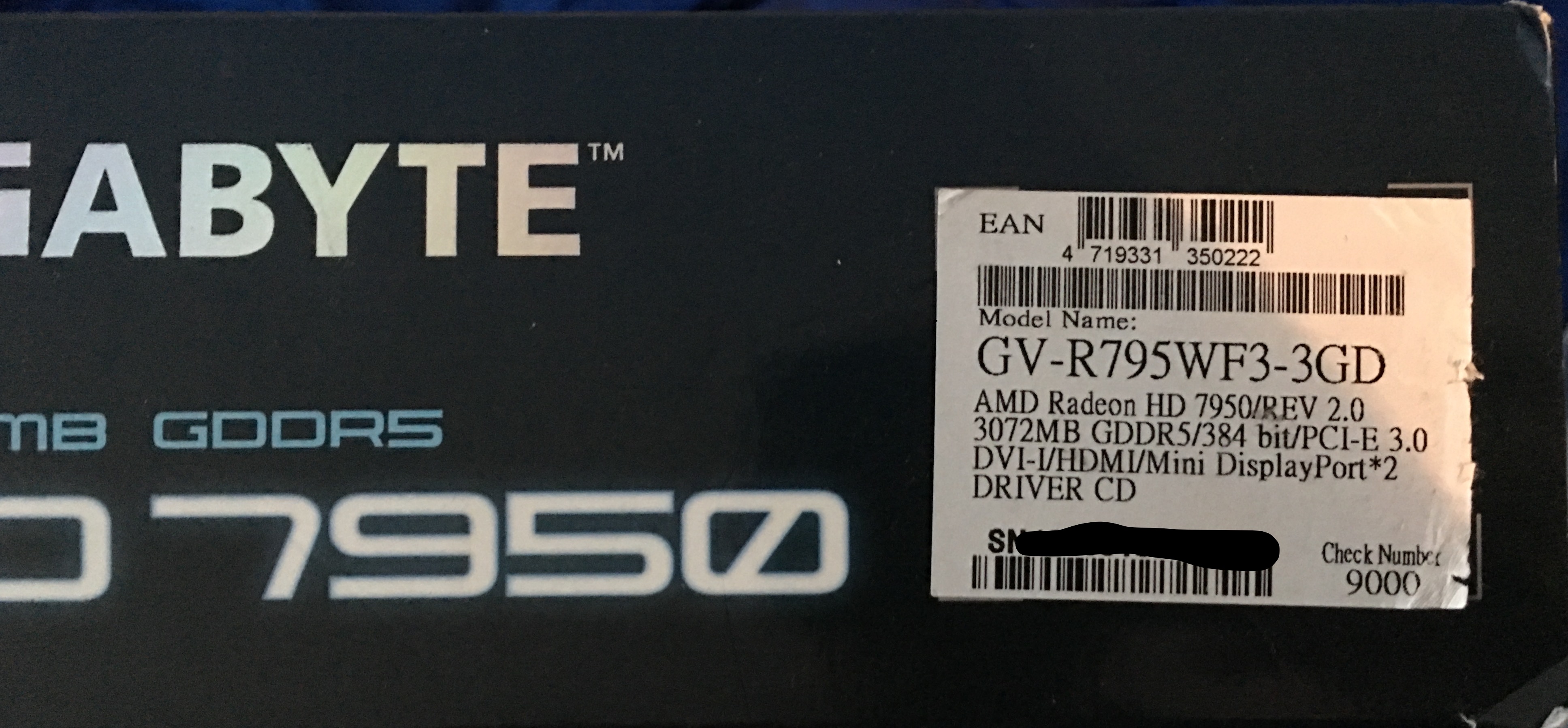

I have exactly the same card. Now, when I say exactly, I mean the box the card came in says that. The serial number on the box matches that of the card. The firmware on the card is definitely from the GV-R795WF3-3GD. However, the PCB of the card tells another story. It reads just above the PCIe pins R9-280X OC rev 2.0. That's right, a 7970 with 7950 firmware on it. From Gigabyte.
When I check in GPU-Z it shows 2048 shaders rather than the 1792 expected. It has Elpida GDDR5 memory on board rather than the more common Hynix. The card requires 8+6 PCIe power rather than the 6+6 expected. I had to do a Pixlas mod to get enough juice to the card. It is definitely not a stock GV-R795WF3-3GD wrongly labelled.
I wouldn't mind as it seems that I have an upgraded card but the card itself is unstable. If I try to run any benchmarking software on either Windows or Mac, like Unigine Heaven or Valley, my MP either reboots or freezes stone cold. The MP will not even boot up with the legacy BIOS switch, so I have no idea what is on that.
I am tempted to try to force flash the R9-280x firmware on it and see if it behaves nicely but there may be a reason Gigabyte did what it did and I could overstrain the card killing it. The best place to ask would be at Netkas' site but registration isn't working there and hasn't for some time.

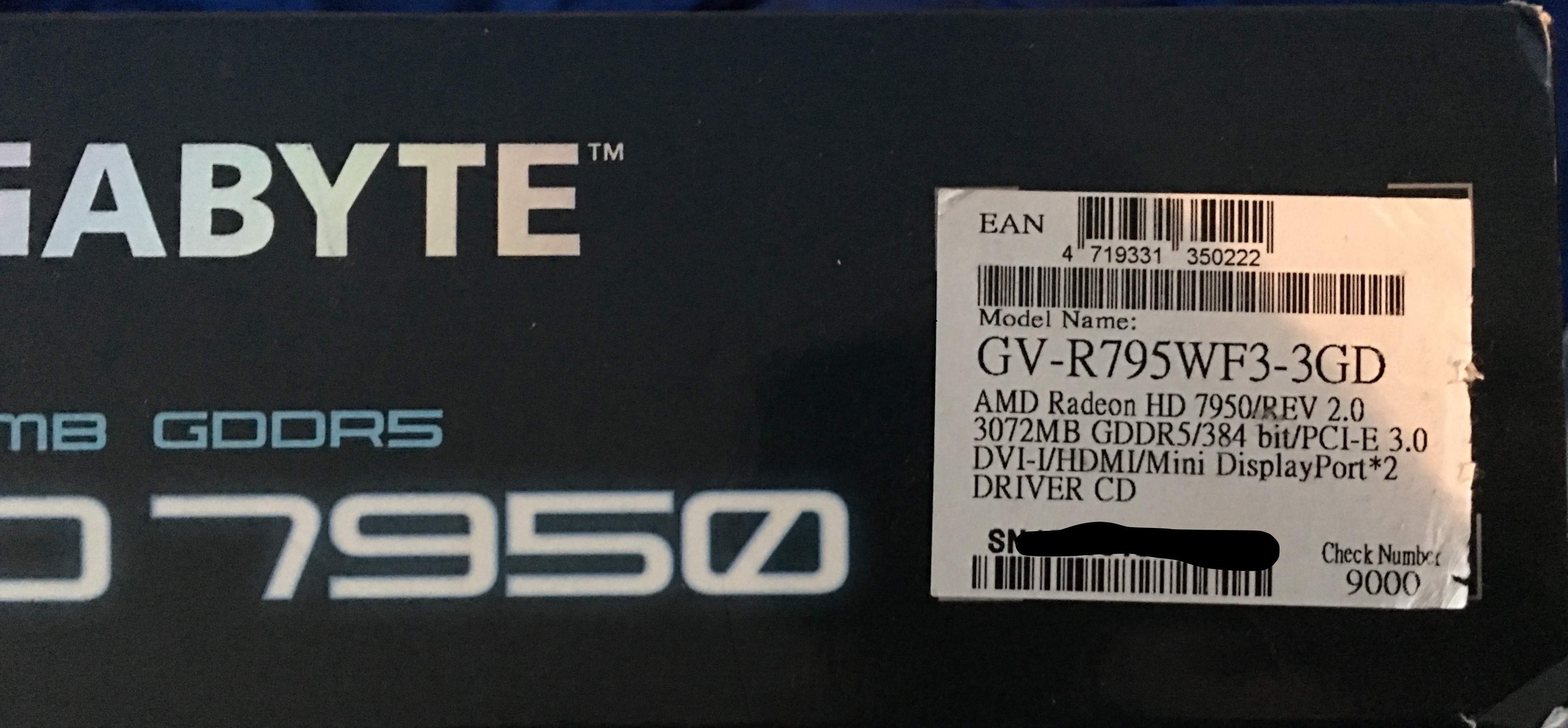

I don't have this card, but since it has dual ROM design, I will definitely try a R9 280X rom. If that works, then make a Mac EFI ROM base on that good ROM. If you have extra time, you may even downvolt or OC the ROM to make it run better.
Oh I know what might of happened
I had to deal with this on a R9 280X (also Gigabyte) that @MacCubed bought for his MP1,1/2,1
these cards where quite popular with crypto-currency miners
and sometimes they would create a custom BIOS which increased their mining capability but it completely broke any sort of 3D.
once I flashed his card with the Factory BIOS image (well Factory BIOS image plus Mac EFI) the card started to work fine and still does to this day AFAIK
heres the link to your cards BIOS page https://www.gigabyte.com/Graphics-Card/GV-R928XOC-3GD-rev-20#support-dl-bios
(I wonder if he has the same model of card as you do)
Reactions: tsialex
The cryptomining is an interesting theory but I don't think it has any custom firmware on it, unless the custom firmware happens to coincide with the revision number on Gigabyte's website.
This is the box info:
The firmware is here: https://www.techpowerup.com/vgabios/139011/gigabyte-hd7950-3072-130329
I am just wondering whether the card failed batch testing and was downgraded to a 7950 because it couldn't handle the overclocking of the 7970 or Gigabyte produced too many of them and had a shortage of the GV-R795WF3-3GD.
what is the Device ID of YOUR card specifically?
the R9 280/7950 and R9 280X/7970/D700 have diffrent device IDs, the 679A vs 6798
that should give us some idea on what the hell is going on LOL (although I dont know if the device ID is a soft or hard strap or both on these cards...)

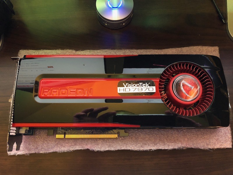

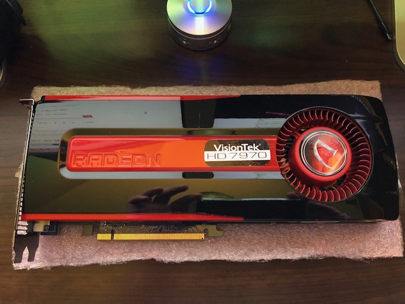

Also, found a Visiontek 7970 locally on craigslist. Is this a flashable option? If so, what are you guys using to power the 6 pin/8 pin connectors on this card?

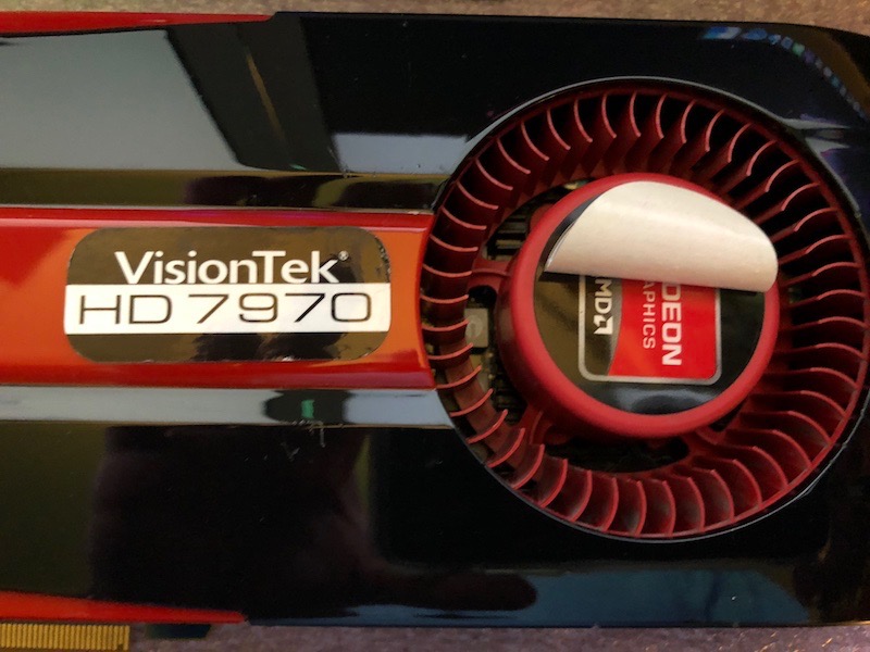

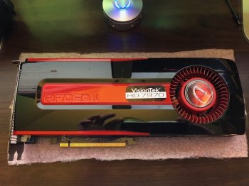

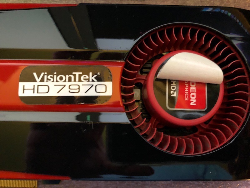

So I purchased a Visiontek Radeon 7970 GPU locally through craigslist. At least it appeared to be a Visiontek...
Looked good, until I started cleaning it. I noticed the stickers on the fan began to peel away...
So was Visiontek just basically slapping their branded stickers on a Radeon reference card?
