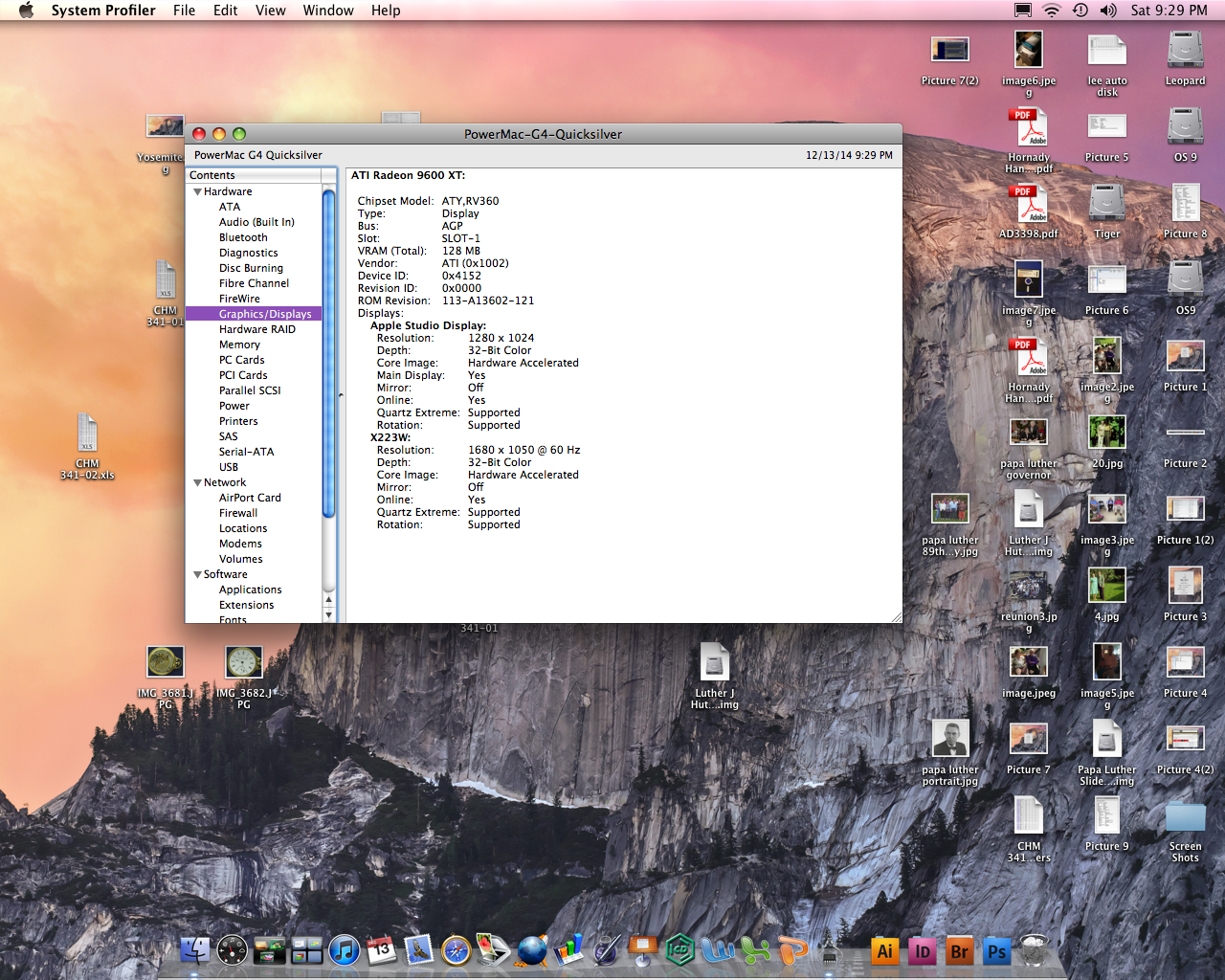

On advice from Intell a while back, I finally bought and got around to installing a Radeon 9600XT in my main Quicksilver.
I did so by taping off pins 3 and 11, and using the "fingers" off an old PC ISA card to bring the ADC from the socket on the Quicksilver logic board to the tab on the Radeon card.
Functionally, the card is fine. It drives my 17" Studio Display and and a 20" 1620x1050 LCD just fine. The USB ports on the Studio Display even work. The only quirk I find is that the power button on the display will no longer power up the computer.
I'm not sure that I'm getting the full capabilities of the card, however. Under 10.5, system profiler IDs the card correctly but says that Core Image is "software" and Quartz Extreme is not supported. I'm also not getting the GUI "goodies" that usually come with these features, such as the translucent menu bar and the "ripples" when adding a widget to the dashboard.
I tested the card in one of my MDDs before soldering the ADC jumper onto it, and all of these features worked correctly.
Is there an extension or kext that I need to check for in the 10.5 install on my Quicksilver to enable these features?

Okay, I think that I have found my issue.
A while back, I went through and disabled some extensions on this computer(by moving them into a new folder named "unused extensions") to dry and make the Leopard install less bloated.
One of the things I ditched were all of the ATI extensions, as at the time I was not using an ATI card nor did I have any plans to(famous last words). I went through and put all the ATI kexts back in place, although things still aren't working exactly right.
In any case, I fired up another computer running Leopard in target disk mode(in my case my new 12" PB-thanks Grockk!) and booted my QS off of that. Upon booting, I found that Core Image and all the associated "eye candy" were working correctly.
I'm going to try doing a 10.5 re-install on the Quicksilver, and hopefully that will fix things.
After dumping all the ATI kexts back into the extensions folder and still not getting anywhere, I had the thought that maybe I should try repairing the permissions(I was also getting errors on startup about extensions not being correctly installed).
I attempted to repair from within Leopard, but waited over an hour and it was nowhere close to being finished. So, I rebooted into Tiger(on a separate physical volume in this computer) and repaired the permissions in Leopard from there.
On rebooting, it works perfectly. I now have the translucent menu bar and all the other core image goodies.
