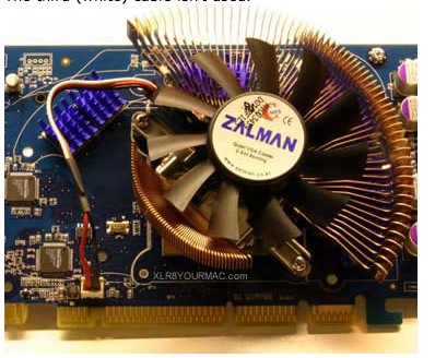

I installed the Zalman VF700-Cu on a Radeon 9800. After the swap the idle temperature of the GPU dropped about 3 - 5ºC in stressed situation, the PCI bay temperature didn't change. The noise level dropped to a level which didn't bother me anymore. The stock card is very loud.

Was there any trick to the install of the Zalman or was it just plug the 2pin in the card?

The only problem is the Zalman embossed rear brace plate. When screwed in on top of the rear nipples as directed, it makes the card too wide to get into the G5's AGP slot. I just took it off. Even without it, the installation is very sturdy, and this fan isn't going anywhere. The nipples now just barely come up against the metal wall that's next to the AGP slot. It's a perfect fit. The Zalman is heavy. If you're moving your G5 and it might get bounced around a bit, it might be a good idea to remove the video card and pack it separately.
Just plug it in as shown in the picture. There are two possible speed settings on the Zalman, so I picked the lower voltage to reduce noise. It runs cooler than the stock fan and is almost silent.
If you wish you can use the G5's 4-pin Molex connector that's connected to the optical drive. You just need to get a Molex Y-splitter, literally a two dollar part.
