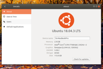

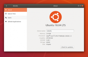

I've got this new-to-me 2006 17" MacBook Pro with ATI Radeon X1600 graphics, which you can read about here, and I've successfully installed Ubuntu 18.04 LTS on it. However, I can't seem to get full graphics acceleration or even get the OS to recognize the graphics chip. It looks to me like it's using an open source driver, see below:
Screenshot from 2019-10-18 17-02-48.png Screenshot from 2019-10-18 17-04-33.png

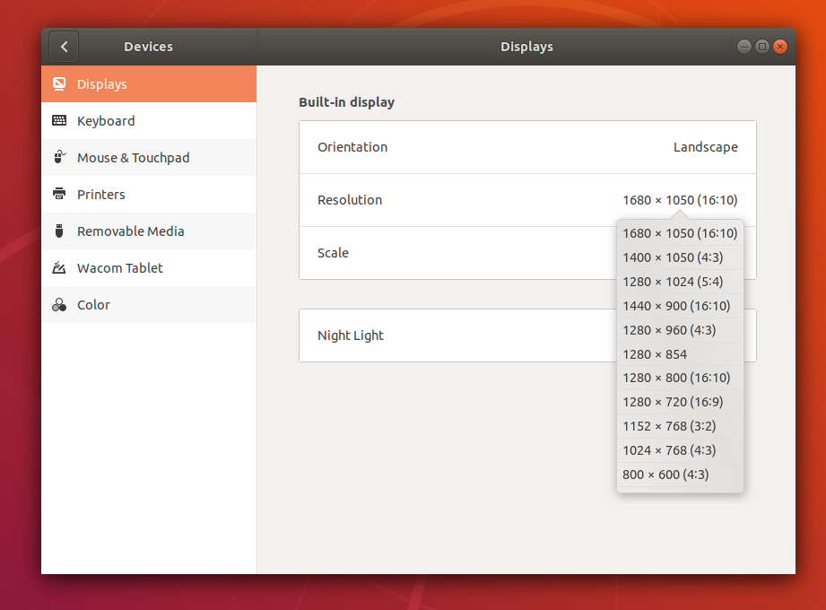

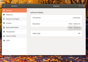

Video performance isn't what it should be, and I can't use the display's native resolution of 1680 x 1050. See below, my only option is 1400 x 1050. This leaves things looking somewhat stretched out.
I don't know what to do here. I've tried installing older Radeon drivers I've found here and there online, with seemingly no effect. I've tried terminal commands to force the 1680 x 1050 resolution, but instead of recognizing the display's proper pixel depth, all it did was stretch out the display even further so that not all of it appeared on screen.
There's no doubt I'm part of the problem here, because I just don't know what I'm doing. Unfortunately trying to educate myself has not proven fruitful. All I've managed to do so far is blindly fling stuff against the wall to see what sticks, so to speak... and so far nothing has stuck.
Is this the best I can do with this machine, or is there help for me out there somewhere?

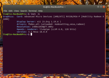

And what I got this time was probably a couple hundred lines of gobbledygook I didn't understand. But the instructions said to look for my OpenGL renderer string, so I scrolled up til I found it.
It said: llvmpipe (LLVM 6.0, 128 bits)
I gathered from the instructions that this is bad, so I moved on to the next section, which led me to a different page to find out how to remove a driver, and more commands and gobbledygook I just don't understand.
I can keep up the monkey-see-monkey-do routine forever, but I. Don't. Know. What. I'm. Doing.
I feel like I'm wasting my time. Help?

No change in inxi-G.

OK now I'm like a dog with a bone.
I booted my MBP from the Ubuntu Live DVD just to see what that looked like, and lo and behold, it's running the right driver! Recognizes the graphics card and the built-in display, and not only utilizes its native resolution, but gives me choices as well! I took a couple screenshots, see for yourself:
Screenshot from 2019-10-20 02-11-02.png Screenshot from 2019-10-20 02-08-36.png
So at least now I know it's possible. Can't play with this any more tonight, but as soon as I can I'll nuke & pave, maybe go back in with Ubuntu or give eOS a shot, I don't know. All I do know is that this should work, so I'm gonna keep at it til it does.
