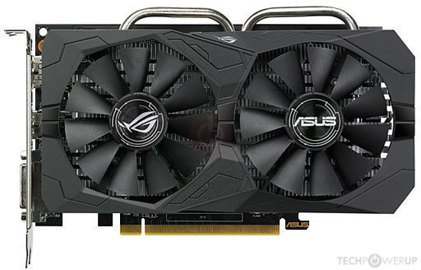

And what about ASUS Rog Strix RX 570 8GB? Is this suitable? Is this possible to flash EFI Rom?
Regards

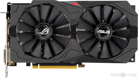

If it's this one, works fine:
Not by yourself. Last self-flashable GPU was Radeon R9-280X, from 2013. You have to pay someone, like MVC Europe, to do it or use OpenCore to provide pre-boot configuration support.
Reactions: antonio.vazquez

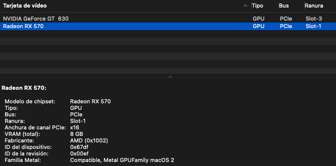

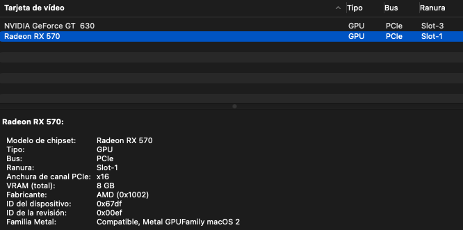

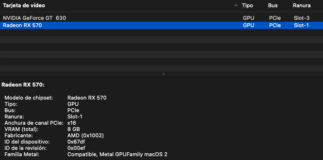

Hi,
I have connected Rog Strix Card, but the display remains dark, altough the card is recognized.
Does anybody know I need to connect the card with a conversor from dual 6 pin to 8 pin?
I'll attach a screenshot where the card appears as recognized. Regards
Hi,
Yes, you need a dual mini-PCIe 6-pin to PCIe 8-pin.
I'll attach a screenshot where the card appears as recognized. RegardsView attachment 2031166
Mojave and newer don't support mixing supported and unsupported GPUs, keep just the RX 570. Also remove any patches that you installed to get the GT120 running, or better yet, don't waste time and do a clean install.
I imagined that it probably need to acquire the cable.
Regarding the card mixing. I'll follow your comment.
Many Thanks
Many Thanks
After you get the correct power cable, do fully supported clean install of Mojave, or High Sierra, to test the card. Patches to get unsupported cards running have the adverse effect of making METAL ones to not work anymore.
