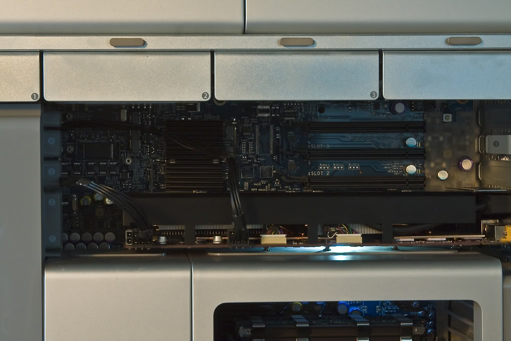

post pictures please

WOOW....coool

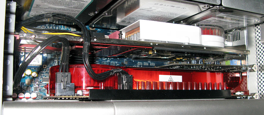

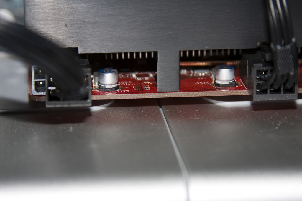

Haha. No. I use Mac as well. The other card (7300GT) was out because I'd been reconnecting the power supply earlier in the day. (The cord fell out! You have remove half the stuff in the case to reconnect it 😱) (I think you could see the "3" on the outside of the case through where the 7300 would usually be.)
The power cable is found here: http://shop.ati.com/product.asp?sku=3280778 (You need two. You might already have one)

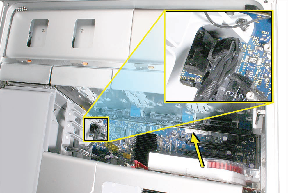

They plug in the upper left corner of the board. Right at the edge of the front fan casing (grey plastic thing.) See image below (image taken from the Mac Pro Service Manual.)

If you do install one, just be mindful of the PCIe power cables. Use the 6 pin connector on the logic board (cable needed). You can see it in the image posted above. The 8 pin cable, supplied with the card, can be used with the 4 pin Molex connector at the empty optical bay.

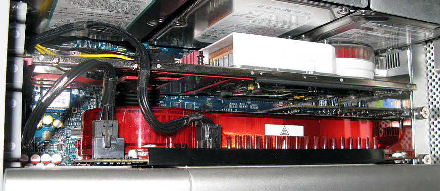

This is my setup:
- Bottom slot: Radeon 3870x2 fed from both PCIe motherboard power connectors (windows bootcamp only)
- Middle Slot: Creative PCIe 5.1 soundcard (windows bootcamp only)
- Top slot Radeon x1900 fed from molex splitter in optical bay and shared with superdrive and blu-ray drive
Hidden from view is the ODD SATA cable running from beneath the fan into the optical drive bay.
To use Mac OS X leave the monitor connected to the x1900 on startup. To use windows vista leave the monitor connected to the x1900 on startup then hold option key to choose vista and immediately swap monitor cable onto 3870x2 for windows startup.
Vista uses both GPU cores in the 3870x2 and if I'm able to track down a Mac Ed 3870 it will replace the failing x1900 and will be crossfired to the x2.
