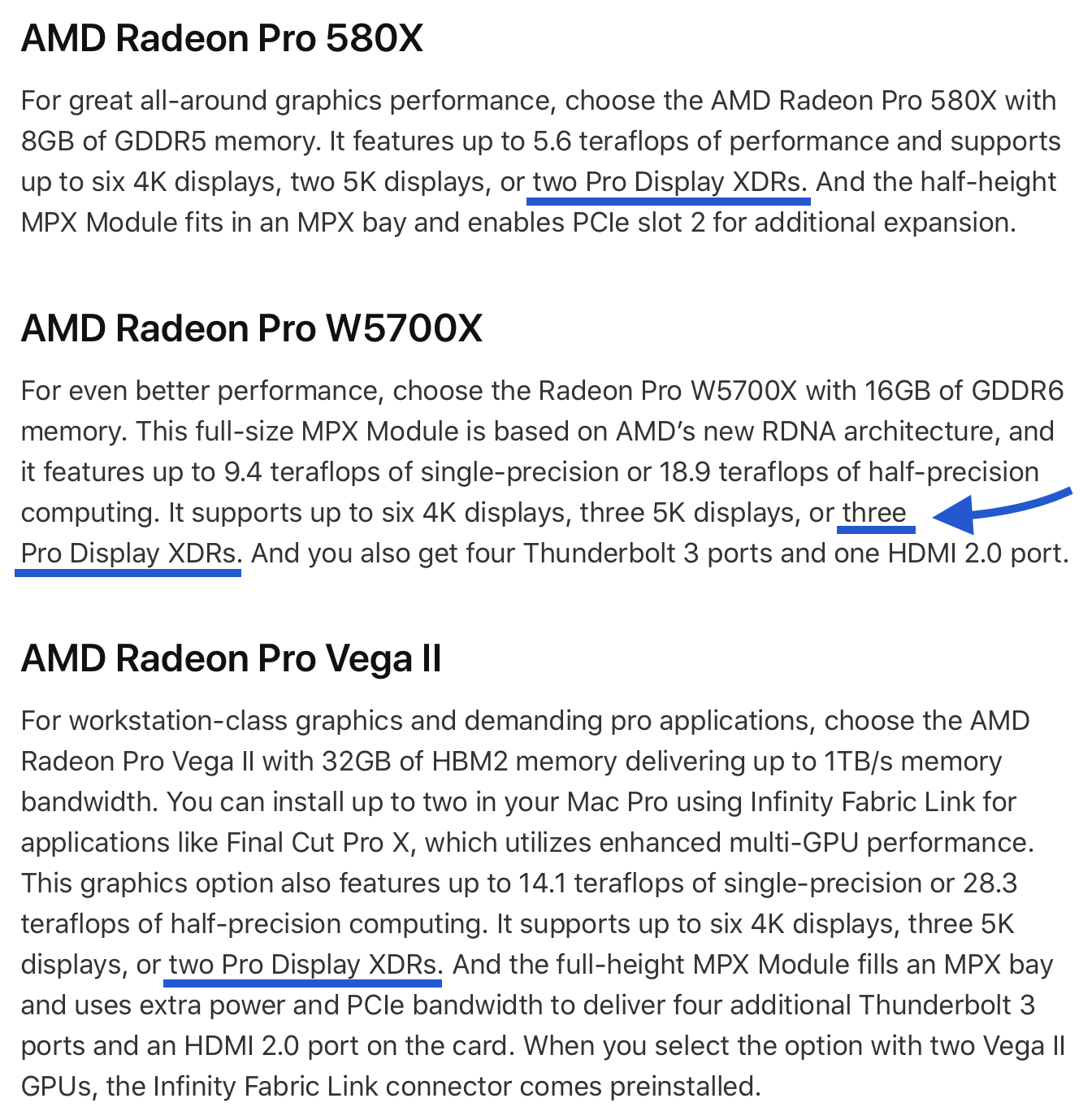

What is the advantage/disadvantage of the w5700X over the VegaII?
It likely won't be quite as capable in rendering, but it'll be much faster with hardware encoding/decoding of h.264 and h.265. It also has half the VRAM as the VegaII, and the memory on it is slightly slower.
Reactions: OkiRun
The advantage would be Display Stream Compression support (you can connect 1 extra Apple Pro Display XDR compared to single Vega II + faster speeds for display's built-in USB ports) and better h.264 and h.265 acceleration (encoding and decoding, including 10bit) thanks to the newer GPU architecture. Might be a bit better at graphics (better gaming and viewport performance). Probably lower temperatures and power consumption as well. Also cheaper, should've been the base option.
The disadvantage is slower type of VRAM (GDDR6 instead of HBM2), less compute power (slower particle simulations and real-time GPU rendering).

The Vega II has four Thunderbolt 3 ports and one HDMI 2.0 port on the card. Does the 5700 have more?
From Apple:
AMD Radeon Pro W5700X
40 compute units, 2560 stream processors
16GB of GDDR6 memory with 448GB/s memory bandwidth
Up to 9.4 teraflops single precision or 18.9 teraflops half precision
Four Thunderbolt 3 ports and one HDMI 2.0 port on card
Two DisplayPort connections routed to system to support internal Thunderbolt 3 ports
Support for Display Stream Compression (DSC)
Support for up to six 4K displays, three 5K displays, or three Pro Display XDRs
Full-height MPX Module fills an MPX bay and uses extra power and PCIe bandwidth
It's about bandwidth, not ports. Directly from Apple:
Display Stream Compression allows more Pro Display XDR connections and faster speeds for the USB-C ports on the display because it uses less bandwidth for the display data itself. Note that with Vega II and 580X you're getting USB 2.0 speeds from the display's USB-C ports at best.
