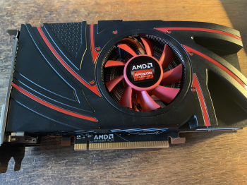

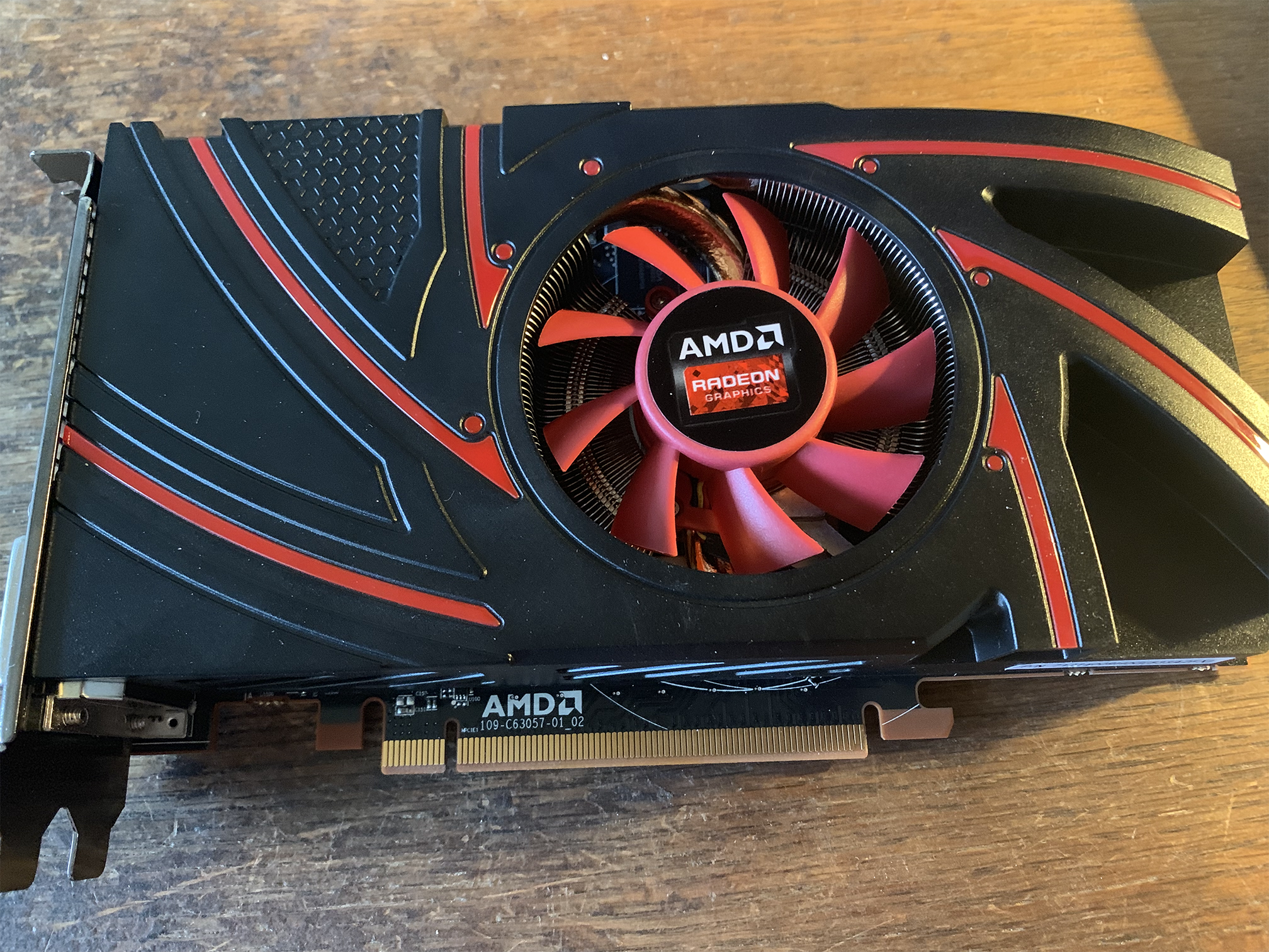

Got a ATI Radeon R9 270 from a friend he wasn't using. Tried it out, but there was no signal coming from the HDMI port. Read a number of articles and edited the AMD7000Controller.kext and the AMDRadeonX4000.kext.
Still no signal; was only able to try the HDMI port; haven't tried the DP port or the DVI port.
Is there a slight chance it could work at all? I don't play games (and never will) Any bit of info is welcome

For some reason I can't pm (too little posts), but I got a pic of the card
First some facts:
  • R9 270 uses the same graphics processor as HD 7870, Pitcairn. Is a rebadged card. This card has the Futomaki personality/framebuffer.
  • The Mac EFI that everyone uses to flash AMD GCN1.0 GPUs (HD 79xx, R9-280x, etc) is based on the EFI of Sapphire HD 7950 Mac Edition. This card uses a Tahiti graphics processor and have the Hamachi personality/framebuffer.
Now let's explain why you can't make HDMI work.
  • HD 7870 is not fully compatible with the personality of HD 7950 EFI, the HDMI port has a different hardware setup from HD 7870 to HD 7950. So, when you flash a HD 7870/R9 270 with the EFI of HD 7950, the HDMI port don't work anymore. You can't change that.
  • Another problem, Mojave drivers don't work with HD 7870 that was flashed with Hamachi framebuffer. AFAIK, you have to keep it unflashed for Mojave to work correctly.
Years ago, some people here made a personality for the Pitcairn series of GPUs that:
  • HDMI works correctly
  • Works with Mojave perfectly
This personality is not public but some cards in the wild have it.
TL,DR:
R9 270 HDMI port has a different configuration from HD 7950 and stops working when you flash the Mac EFI from it. If the monitor only has HDMI, use a mDP to HDMI adapter or a DVI-D to HDMI.

Thank you so much tsialex for this very clear information. Like I said before, just got the card from a friend, who never. used it.
Another thing, if the card works with a DVI-D to HDMI thats enough for me. I don't play games and I don't wanna run Mojave (did that on my MacBook Air - didn't like it ) (personal taste) Been running FreeBSD for years (CLI) so every GUI is a bonus to me

I'm using a DVI-D to HDMI cable with my HD 7870 flashed with HD 7950, works ok up to High Sierra. Apple mDP to HDMI adapter works too.
