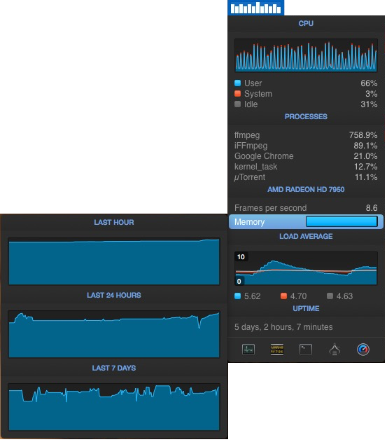

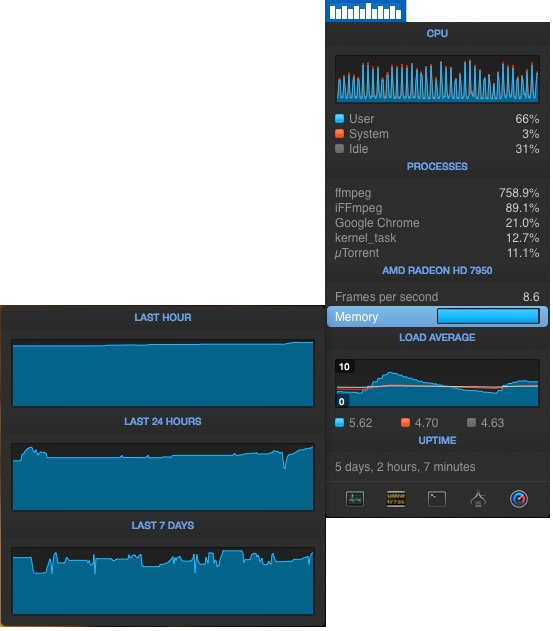

its working of sorts with my older monitor via DVI but its also seems to be loading up the ram and not clearing which is having some graphic glitches, first 2 on the left are of the 280x at different times loading the memory out,
I just think that Yosemite is good on using VRAM. Didn't realise it may be a fault. Anyway, it constantly use all my 7950's VRAM, but no such graphic glitches observed so far.
