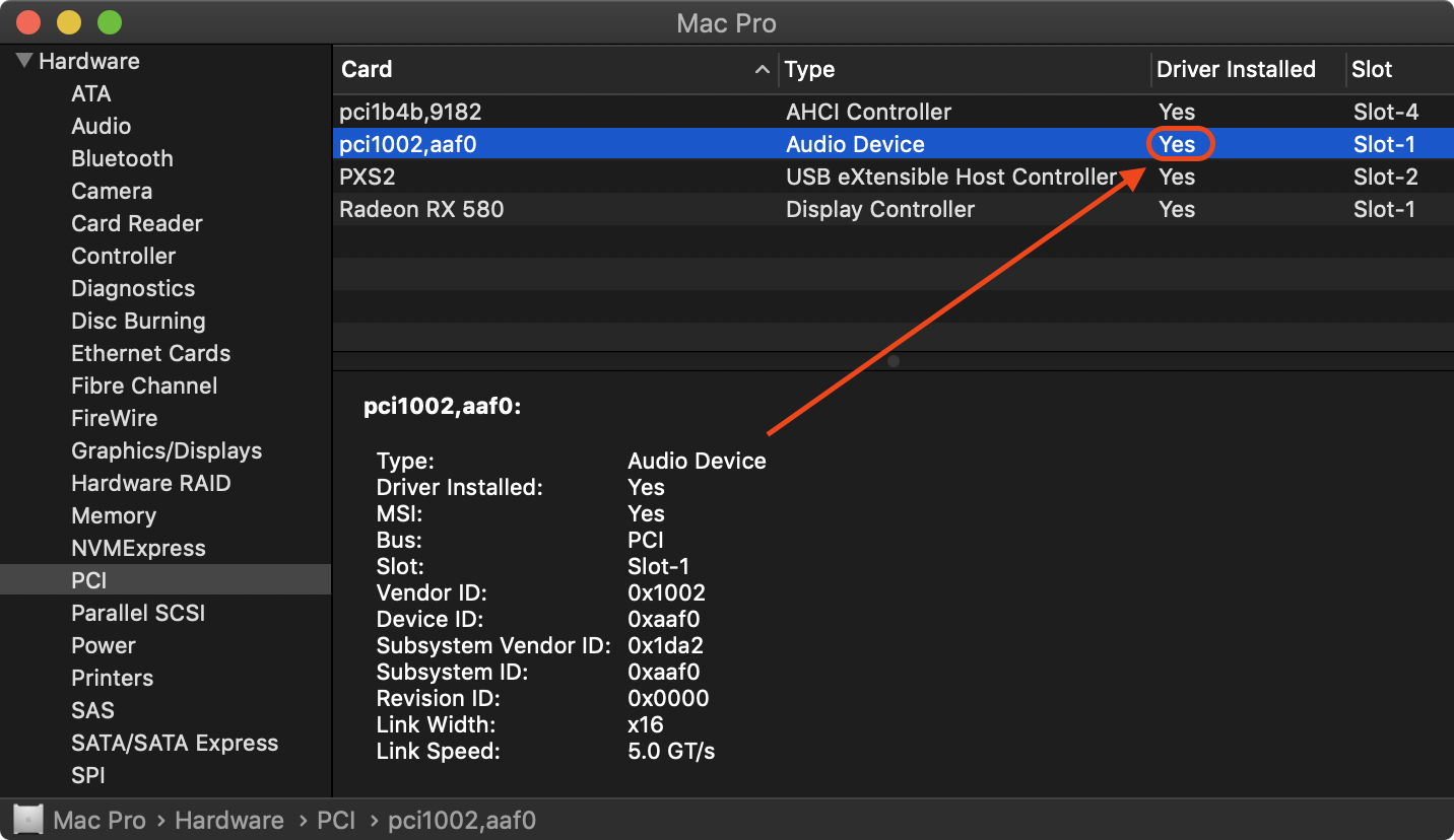

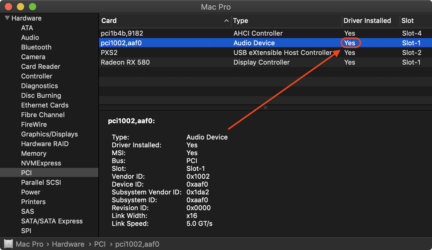

I just installed an RX560 GPU for Mohave. I notice that the system utility reports 8 lanes for audio (for HDMI I presume even though I am not using HDMI, just DVI) and 8 lanes for video for the gpu in slot 1. Will that audio allocation affect the video performance?

No, and most likely it's not even working in your case (because no driver installed)
You are right H - no driver loaded.
