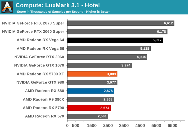

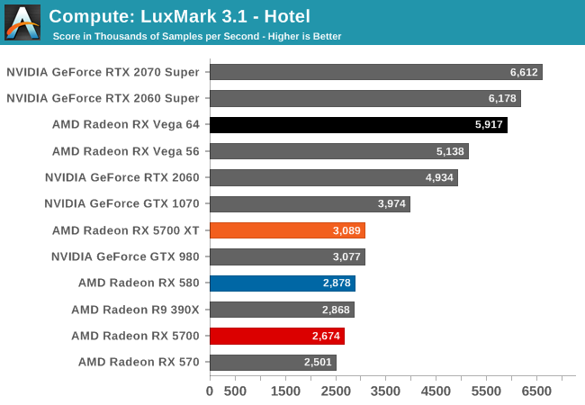

I think I will wait for radeon 5700 support in Catalina and wait until i upgrade my mac pro. For now the rx580 mvc is working fine.
I assume you know the 5700 not necessary perform better than RX580, really depends on usage.

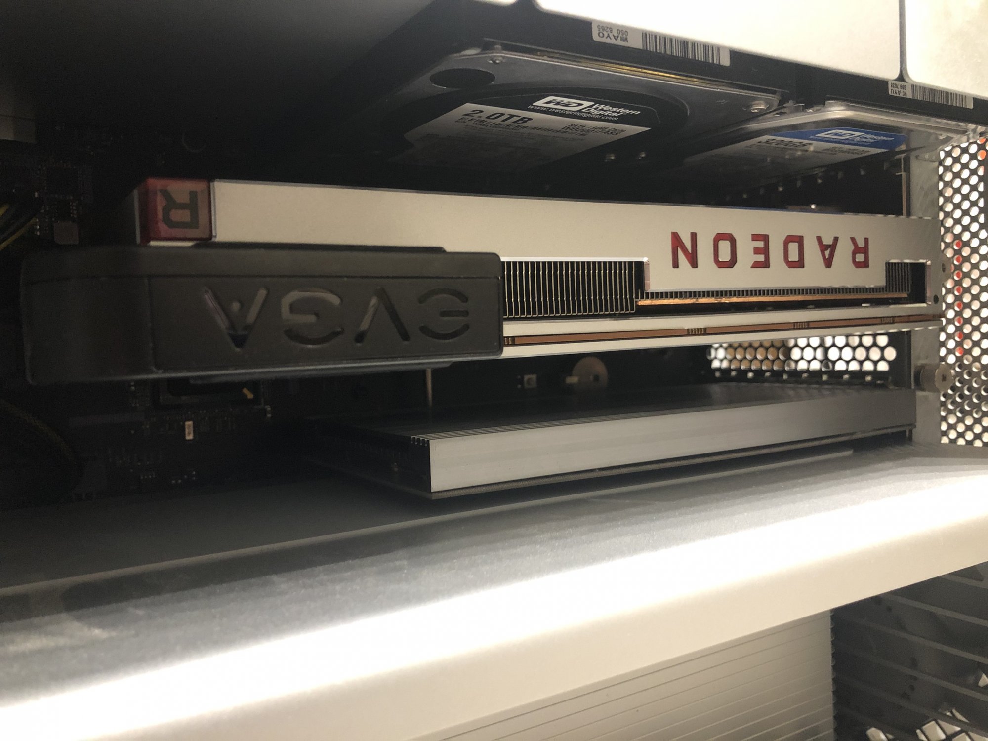

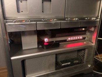

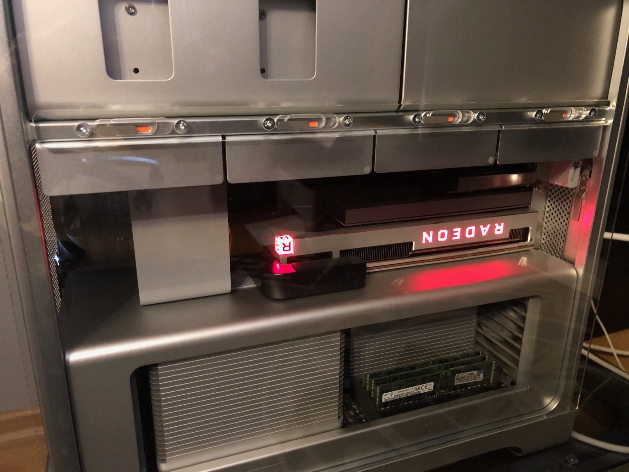

Hi, AlexMaximus!
I managed to get a Radeon VII. Isn't it a problem to have a Crest I / O card above the x16 slot? Don't block the air supply to the fans?

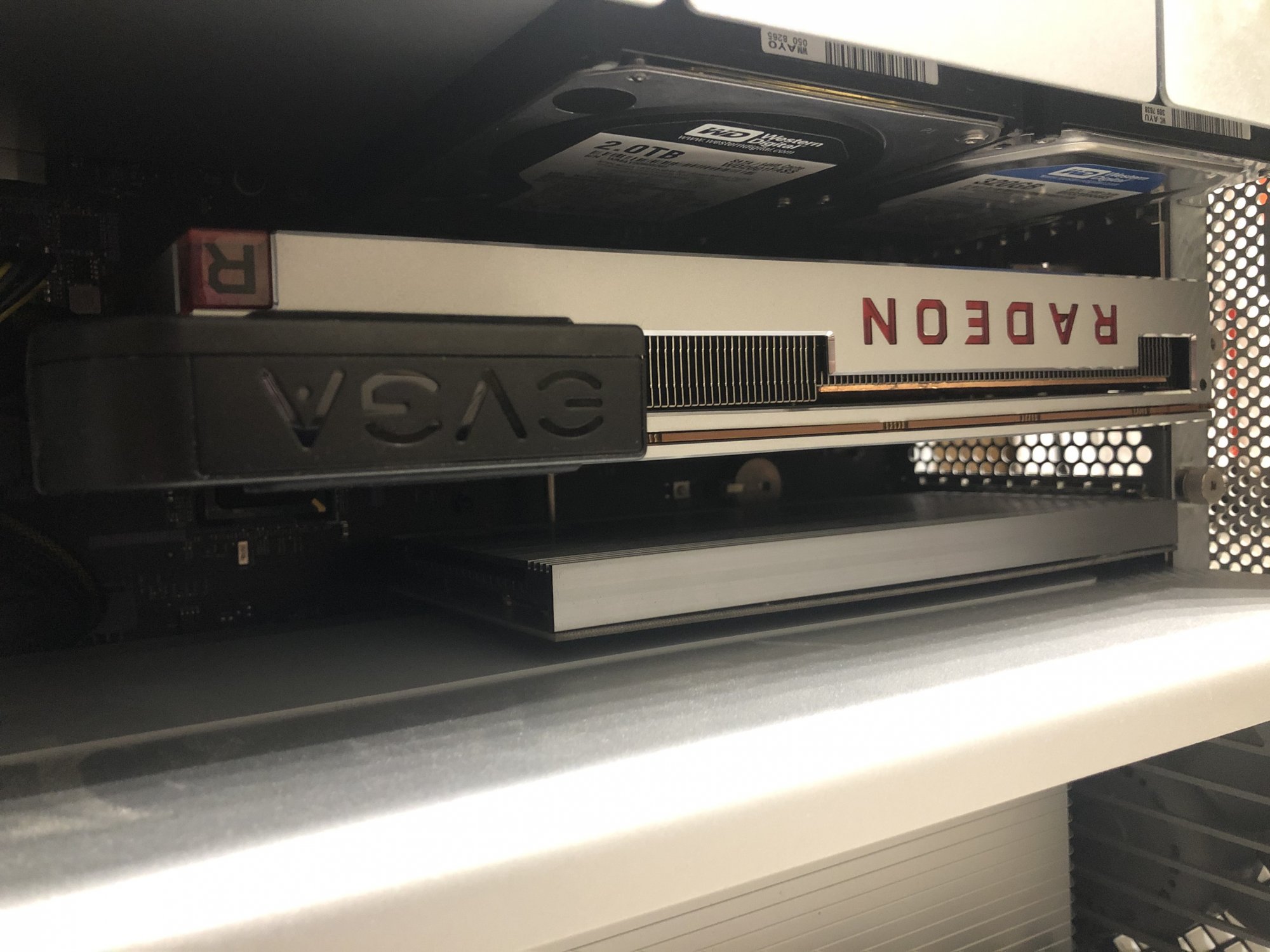

Hi, AlexMaximus!

That's how I do it, - by losing a slot, to have max speeds on those SSD blades and max airflow on the backplate.
