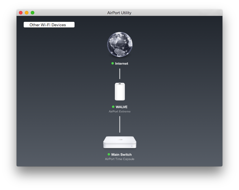

As you can see in the attached screenshot the "Main Switch" is connected to the modem and the "WALVE" is connected to the "Main Switch".
The problem is though that only the "Main Switch" shows up in the OS X server app.

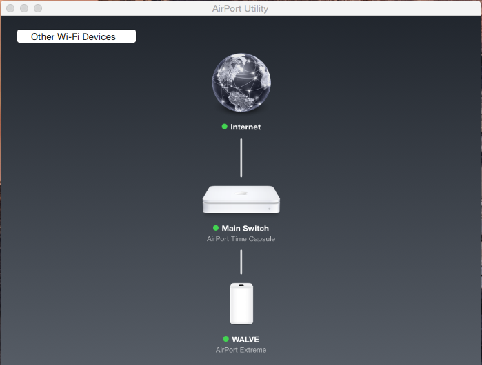

I would switch it so the newer Extreme is at the head of the network. Sometimes you need to configure the secondary base station in DHCP & NAT mode and switch back to bridge mode when done.
Thanks for answering !

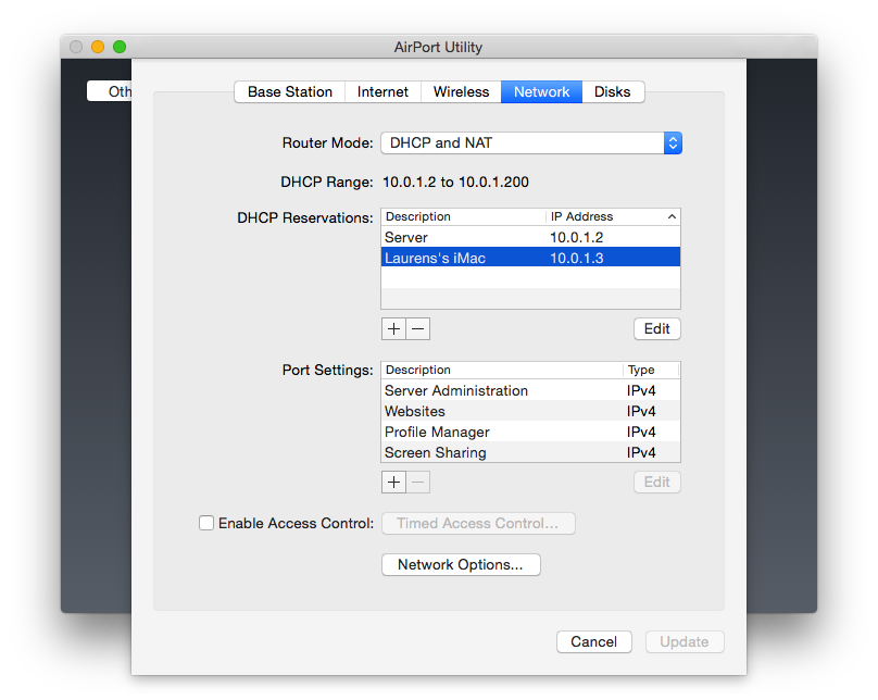

So I've changed the newer Airport to be the main router.

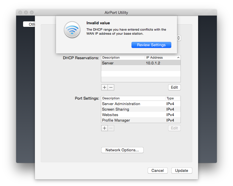

Then when I try to put the older router into DHCP and NAT Mode I get the following error:

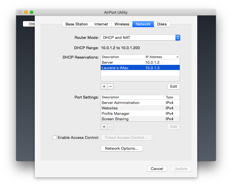

What do you advise on setting as range or configuring ?

Try putting it into WPA2 Enterprise without changing it first.
