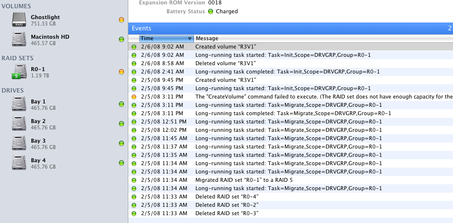

here's a screenshot of what i have...😕

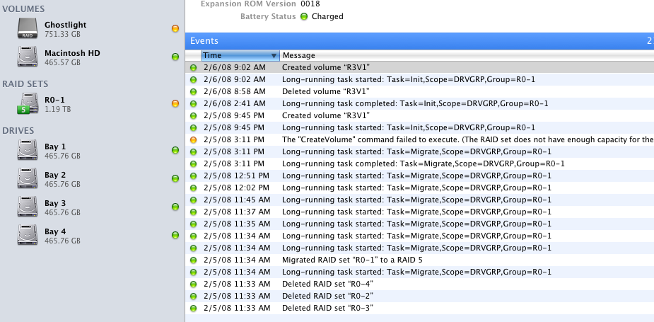

here's what the Raid utility looks like...
thanks again!

Looks OK in Raid Utility...

The 1.19 TB shown for the R0-1 RAID set is what you get formatted for the raw 1.5 TB (500 Gig being used for redundancy/parity from your original 4 x 500 G drives). This is exactly what my RAID is being set up as right now (about 2/3 of the way through the process 🙂 -- what is the convention for an "impatient" smile?)
It's two, two, two volumes in one [set]
Oh, that bit about the 750GB "free space volume"? One of the options when you migrated the original 1 drive to a 4 drive RAID 5 was to use the additional space for a new volume (this is not particularly clear in Raid Utility ...). This gives you a startup volume equivalent in space to your original one drive (but striped over the RAID), plus another (751.33 = 1.19T - 465G...) that you can use for other stuff (in my case, media data that will be backed up separately from the boot partition.) There is really just one RAID set that is divided into two. I don't know if you can "migrate" that back to a single volume (without having to save/restore the data) if that is what you had intended to do.
