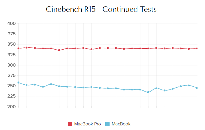

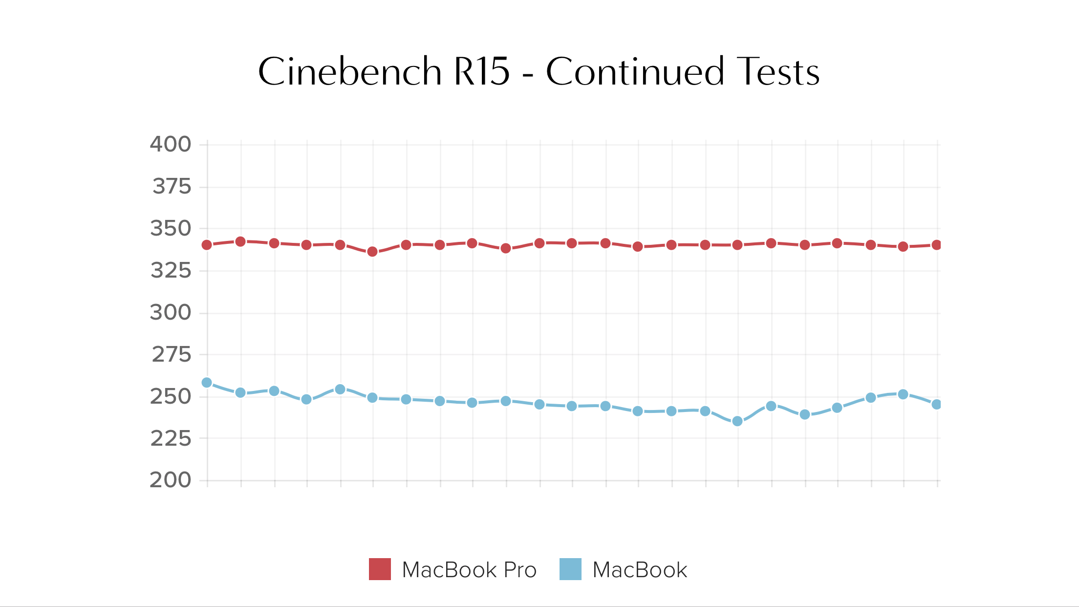

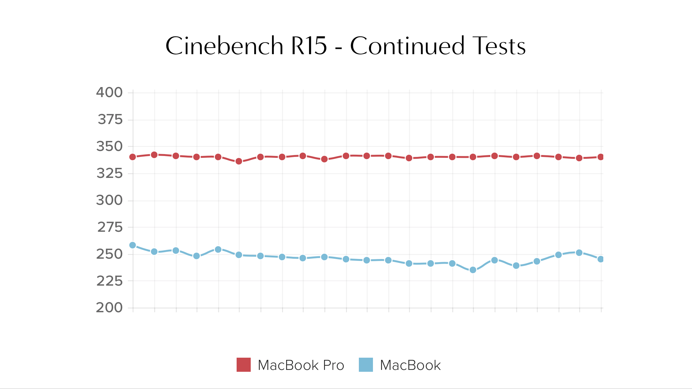

Hey, I have done this test when comparing the maxed out 12-inch MacBook to 13-inch MBP a while ago. I didn’t get any throttling issues at all. Take a look at screenshot or check out this page https://eldargezalov.com/news/12-inch-macbook-vs-13-inch-macbook-pro
Thanks Eldar...very interesting and nice review!
I am not at all surprised that the sudden dips seen on the Notebookcheck review have not occurred,
But I am surprised at the low level of fall off you show, ie almost none. When I have done the repeated Cinebench tests on my 2016 M5 I have seen typically about 10%.
Good review. But again I wonder if there were background processes in that 2017 i5 test. My m3 scored slightly higher than the i5 in Cinebench. At some point I should try the repeated Cinebench test.

Hey, I have done this test when comparing the maxed out 12-inch MacBook to 13-inch MBP a while ago. I didn’t get any throttling issues at all. Take a look at screenshot or check out this page https://eldargezalov.com/news/12-inch-macbook-vs-13-inch-macbook-proView attachment 721552
Wow! Thanks for the validation man, feel so much better about my purchase 🙂

I think he accidentally listed his MacBook as an i5 when later on in the review it's actually an i7 (1.4ghz)

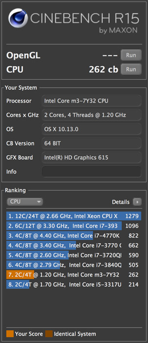

Well, either way, my m3 on a single test scored higher at 262 for Cinebench. However, I have no idea how it will behave with repeated tests. Dunno if it it will throttle significantly.

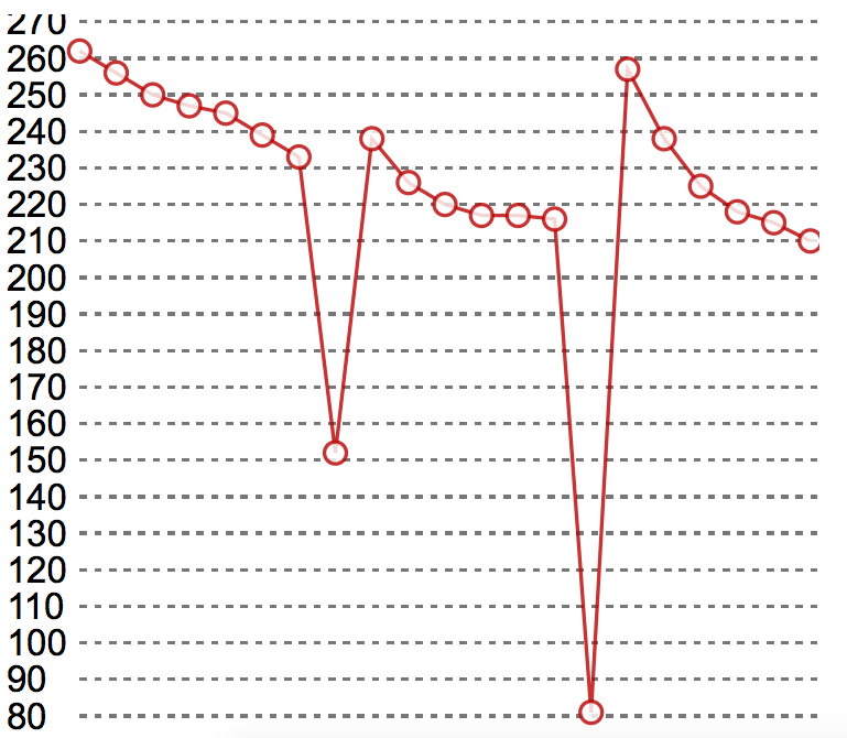

This doesn't bode well for the Core i7 then:
I will do my repeated tests tonight or tomorrow to see what happens, but I wonder if the Core i7 might even be throttling right from the beginning in the first test, cuz this is what I get with my first test on my 2017 Core m3:
My m3 scored 262 the only time I tried it (this time), and his i7 never ever broke 260 despite his having done it a few dozen times.
Hey, yes it is i7. it was a typo, thanks for pointing out.
I think I saw it in other reviews as well, quite a few times. For some reason the score for i7 in Cinebench R15 test is on par or even lower than m3. I will do the test again to confirm.
Just a thought...is it possible that your i7 was already warmed up for the Cinebench series you showed?
This would explain both the lower than expected initial result (compared to M3), and the low fall off in the tests after.
Even if I do a test right after powering my MacBook on, I always get 255~260 max. The lowest score I got during the repeated test was 235 points, which is about 10% drop.

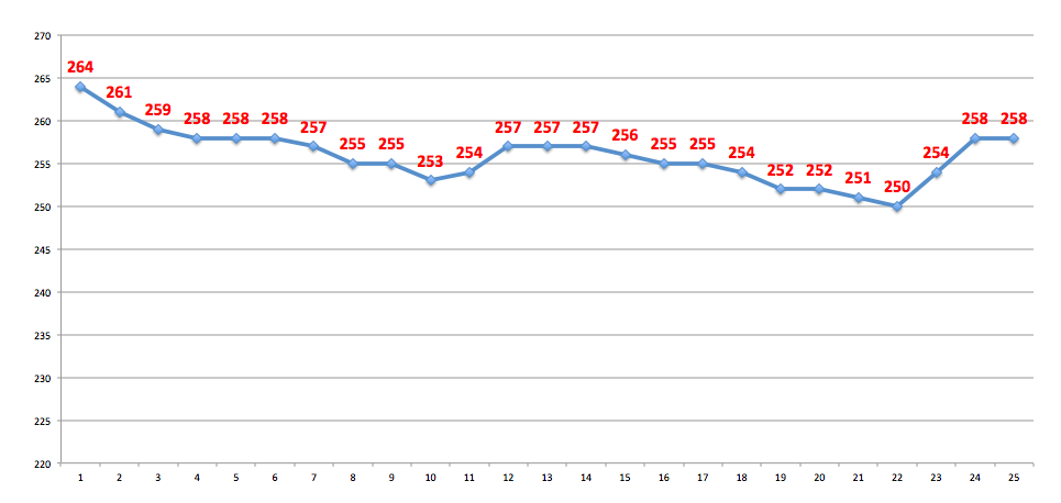

2017 MacBook Core m3-7Y32 1.2 GHz - 25 runs of Cinebench R15.038. Yes I spent over an hour doing this. 😕
Ambient room temperature 23°C. Table top was a granite breakfast bar. Running on battery power. Screen set not to dim. WiFi and Bluetooth off, and Sophos anti-virus turned off.
Note that part way through the 11th run, I moved the computer over a bit because I was rearranging the stuff on the counter. Low and behold, the score went up. I noticed the part of the table where the computer had been was a little bit warm (but not hot), so it seems moving the computer over to a cooler spot helped performance. So, right after run 22, I intentionally did the same thing again, and again the score went up.
Below are the raw scores for future reference in case someone wants to put it into an Excel spreadsheet, but the most valid scores are only the first 10 for the reasons stated above:

You'll note that not even once did the score drop below 250. It may have dropped a bit below 250 had I not moved the computer, but given that 25 runs is about 65 minutes, that means 10 runs is around 25 minutes of sustained load with only about 1 second or so gaps between runs. I'd say I'm pretty happy with that result. In other words, it would have taken half an hour of sustained load to drop below a score of 250 on this mighty m3.

Well done and well reported thanks!
You seem to have a good M3 there!
At least from memory the Geekbench scores for the M3 i5 and i7 are in the expected order.
Would be interesting to find out the spread of M3 results available.

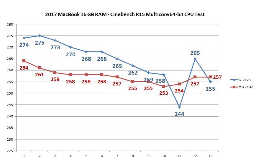

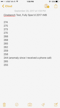

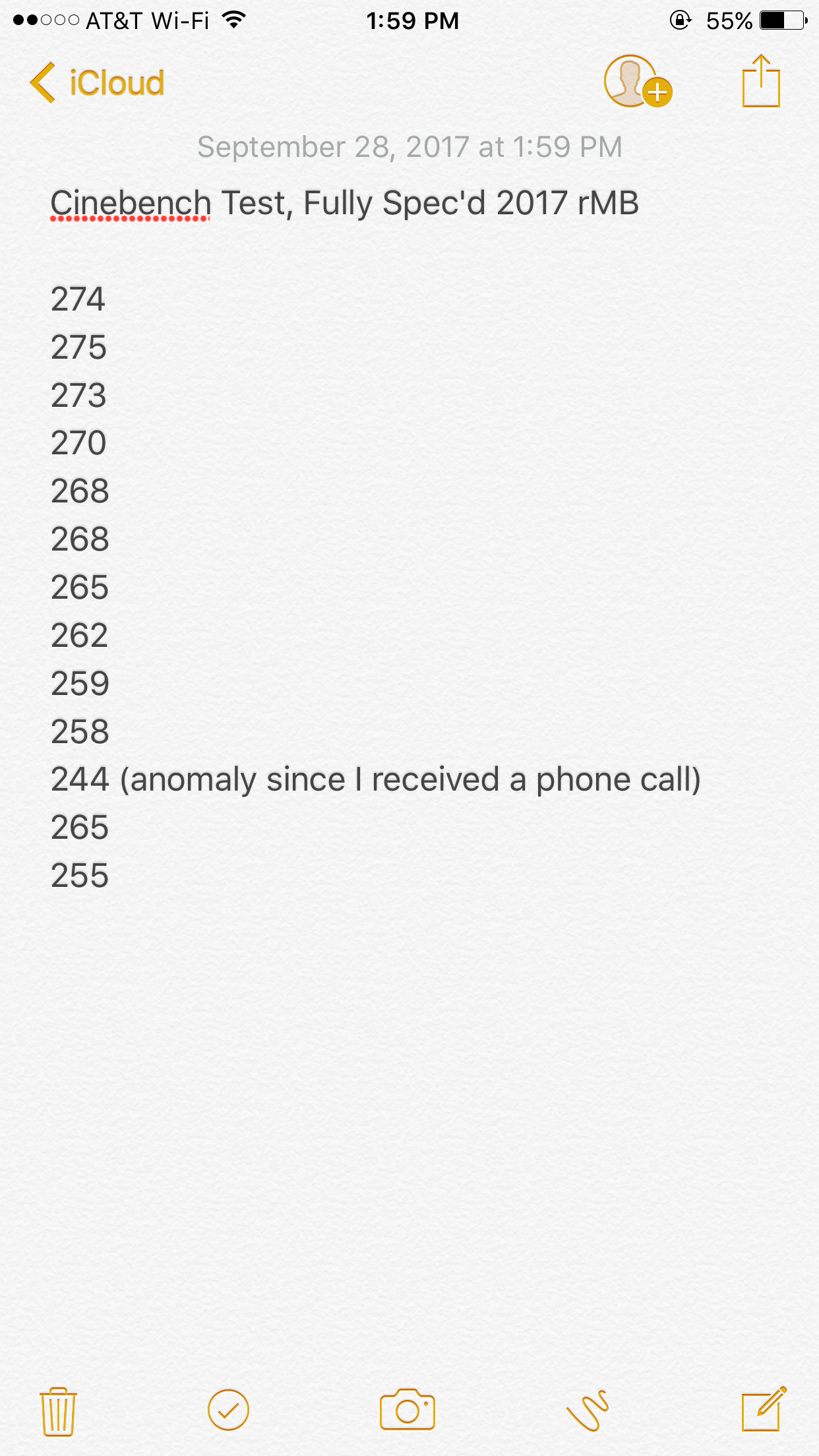

Here you go! Very impressed with my results. I must admit, last night when I got the mac and started running the tests, I was only getting 179, 214, etc. I'm assuming that's because of the fact that spotlight indexing may have been taking place, or even me installing High Sierra beforehand had a role in it too. This morning, I just opened up my Mac (and even accidentally left finder, a safari tab, mail open) and ran the test at least 10 times.
They seem to converge, although it's hard to judge after run 10, since in run 11 the i7 got a phone call, and the m3 was moved to a different part of the table.
Right. I'll see if I can get a more consistent test soon.
I kept my laptop in the same place for the tests, btw.
