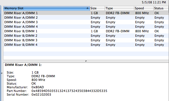

i just bought a new 8 -core MAC PRO.
with 2 GB of RAM., 1 x 1GB sticks.
I'd like to hear how much RAM is needed for my work ?
and what config do i want......1 GB sticks or 2 GB sticks...?
I mainly run heavy Photoshop CS3 work and Digital Photo Capture.
What is the MAX RAM CS3 Photoshop can utlilize ?
I wouldn't want to put in unnessesary amounts of RAM,
if not needed....
Thanks!

Photoshop itself can utilize around 3-4GB of RAM, when the 64bit version comes out then it will use RAM above 4GB limit. you also need to have RAM for the OS and other apps that you will have open at the same time. Currently adobe lightroom 2.0 is enabled for 64-bit and if you use it then it can use more than 4GB. with RAM prices being low I don't see why you can't go with 8GB, which seems to be a good balance between performance and price.

Hi,
I wouldn't go for 1 GB, but at least for 2 GB: they are not that expensive and you can spare two extra slots (if you'll go for 8 GB while keeping your existing Apple DIMMs).
