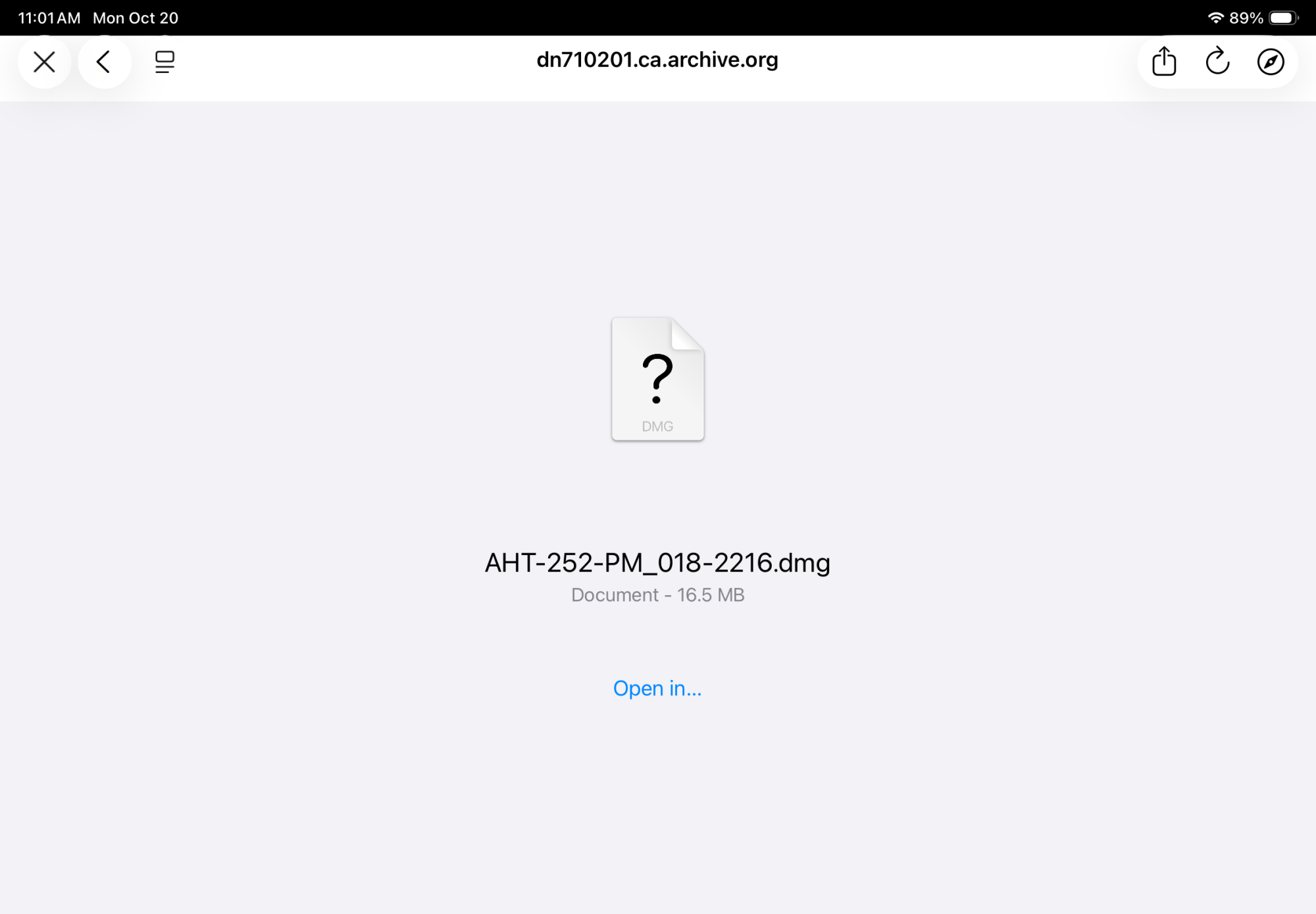

Yanno another thought is to run AHT (Apple Hardware test) suite for your particular mac. Mactracker states that you would use 2.5.2 for the a1047 Powermac G5. Link below:
IIRC the test suite includes a test of the ram slots. It may be worth your time to run and see what it states.

About this AHT thing, what you sent me, would this be used in lieu of the G5's original gray discs that I cannot find for the life of me? Do I just open the file you sent? It is asking me to open in….. What should I open the file with?

Sorry for the delay. You are correct, AHT was on those gray discs that came with the powermac - usually disc one. Since you dont have them, you would download the correct version and then burn it to a blank DVD and boot into that at start up by holding down the option key and selecting the dvd. Then you can run the suite and see what it says. What you would do is up to you, but you would know if it is ram based or if the slot is broken and from there take next steps. As it stands, you could continue to use the PM at 4gb ram. My A1047 variant was neutered with only 4gb max lol, so never had an option for 8. The board even has the pads for where the other ram slots would hypothetically go, Apple just chose not to populate them.
