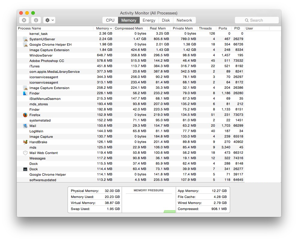

I have 32G of RAM, can't feel any difference about RAM managing between Mavericks and Yosemite. They both constantly shows about 2G of wired memory, another 8G of app memory, and the rest are basically for caching under normal usage (Safari, email, iMessage, etc.).
However, I am very impressed by Yosemite that can almost always fully utilise my 3G or VRAM. In Mavericks, it occasionally use more than 1G, but now, almost alway use all 3G. Of course, I mean normal use, not gaming or 3D work.
I'm still trying to comprehend the RAM usage!
I'm still trying to comprehend the RAM usage in both Mavericks and Yosemite. Clearly on my MP 5.1 with 24GB RAM OSX 10.10 uses Swap and Mavericks dos not. Do I need to upgrade my RAM?
Top 5 users of RAM:
Puzzled! 😕
It seems Yosemite use more SWAP, but less memory compression than Mavericks. Don't know the reason yet. And 32G seems won't make any difference.
