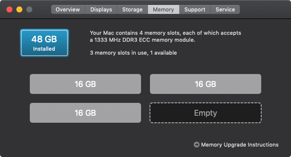

Is anyone having RAM issues on a 5,1 with Mojave DP9?
Just updated and on reboot it only displays 48GB of the 64GB. DIMM4 is supposedly empty.
I rebooted and then 32GB showed.
Rebooted again and 48GB shown.
I reseated the RAM and no change. Anyone else seeing an issue with DP9?
I've never had RAM issues up until now. Coincidence or could DP9 be the cause?

Thanks. I'd forgotten about the red light. Yep, red light present.
Seems like one of my DIMMs just died out of nowhere!
Doesn't explain the 32GB on one reboot though. Maybe the 3rd DIMM is failing too? What the...

in some cases a failing DIMM can cause issues across the entire memory channel. the 4,1 and 5,1 have triple-channel RAM, so that fourth bank actually shares a channel with one of the other DIMMs. remove the failing stick and see if the behavior continues.

Thanks. Yeah, it's definitely a dead DIMM. Not happy. £66 on eBay to replace. :mad:
Did you tried cleaning the slot contacts and the memory contacts? Every now an then, annually maybe, I have to do this with my Macs.
