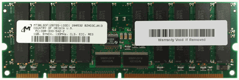

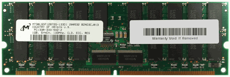

I similarly doubt it would work, but such things apparently exist. Probably cost close to nothing too if you felt like being a test subject.
Thanks. I actually did look it up, but the pictures (including yours) while they look similar to the 512s I have do not look quite the same. I'm betting the notches don't line up exactly.
That ram is ECC Registred it will not work in a G4 Mac however a while back I found this http://www.ebay.com/itm/1GB-SDRAM-P...RY-RAM-DIMM-/231280650583?hash=item35d966a957 its a 1GB SDRAM stick thats of the normal desktop type I have never seen one before but i know someone who has ordered mac pro and G5 Quad ram from the seller with no issues. keep in mind i dont know anyone who has tested the PC 1GB ram stick in a G4 tho (iv been wanting to get one for testing LOL ) (mod note: its not my ebay listing)

Well…confirmation that this does not work.
There was a slightly cheaper auction I was watching that has this exact same memory stick. My QS does not recognize it. I tried all three slots.
Looks like 1.5GB ram is where she stays.

What I was testing was the 1GB RAM stick that LightBulbFun linked too. THAT does not work.
