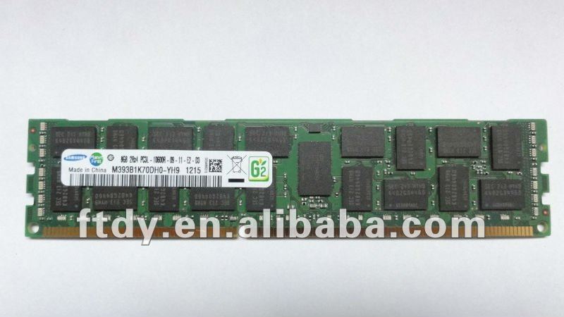

Do any of your 8GB modules look like this:
The above image is RDIMM and not compatible with UDIMM that looks like:
BTW most memeory modules have lifetime warranty, and you should contact OWC for replacement of the defective memory.

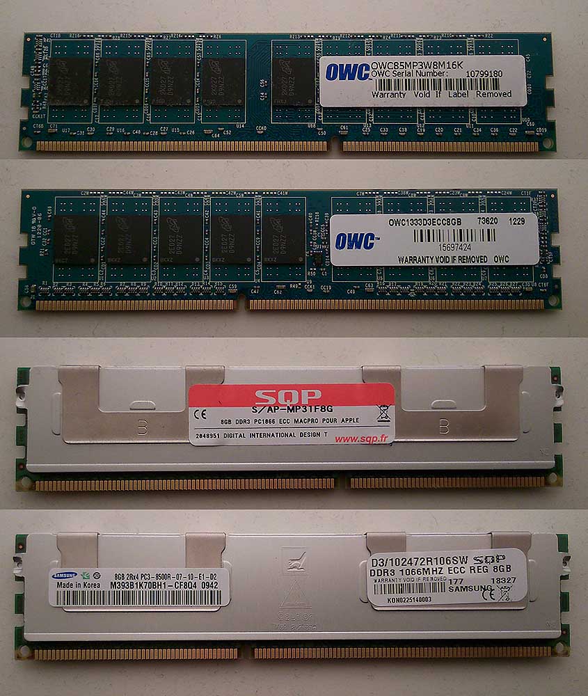

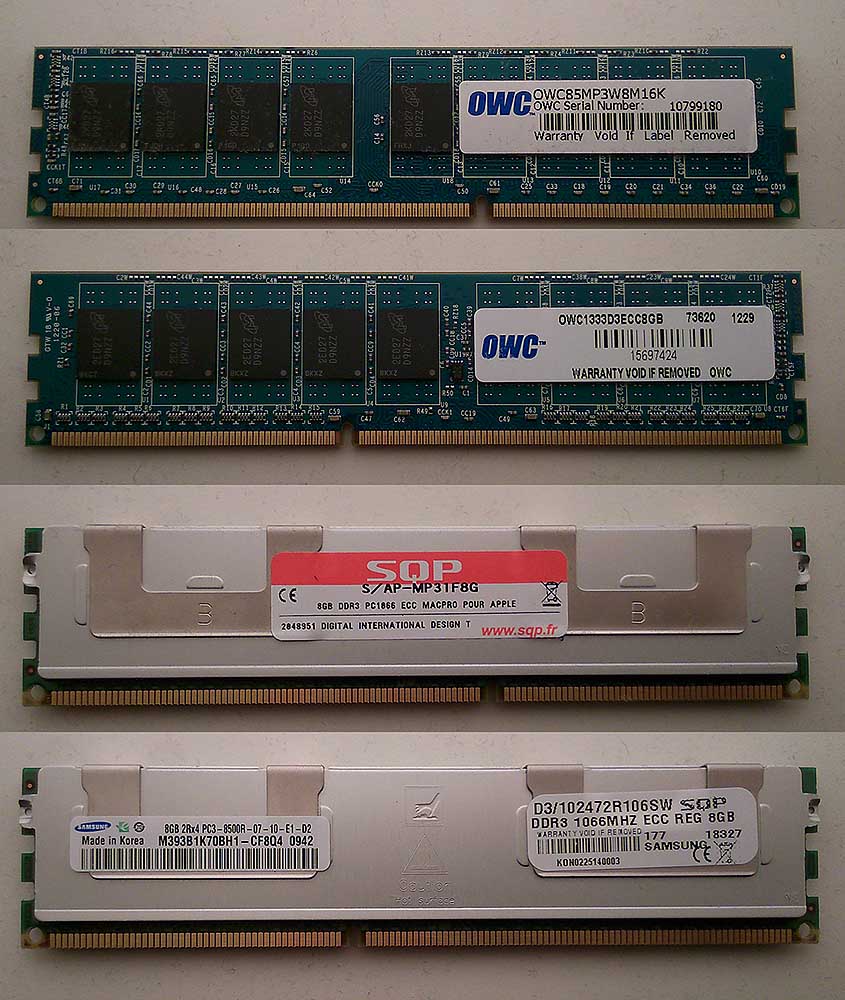

You did not really answer the question because the System Report from Mac Pro can not tell whether the memory modules are RDIMMs or UDIMMs. I know this because I have used both types in my machine before. I could be wrong of course, but I still think mixing different types of DIMM is the more likely explanation. At least find the product number on the memory module and find out its DIMM type online. People in the past have reported no problem when mixing different memory speeds or even ECC and non-ECC (although not recommended) memory modules as long as they are UDIMMs.
I didn't answer the question because I couldn't see enough similarities between the photos you included and what I have here. I've taken pics of the two module types I have, in the hope you could identify them as either RDIMM or UDIMM, as I haven't a clue.
Just as I suspected, the bottom two modules are RDIMMs, as it clearly showed ECC REG as registered module on the heat spreader. So you don't even need to remove the heat spreader to confirm them as RDIMMs. You need to return these two for UDIMMs as unbuffered memoery modules.

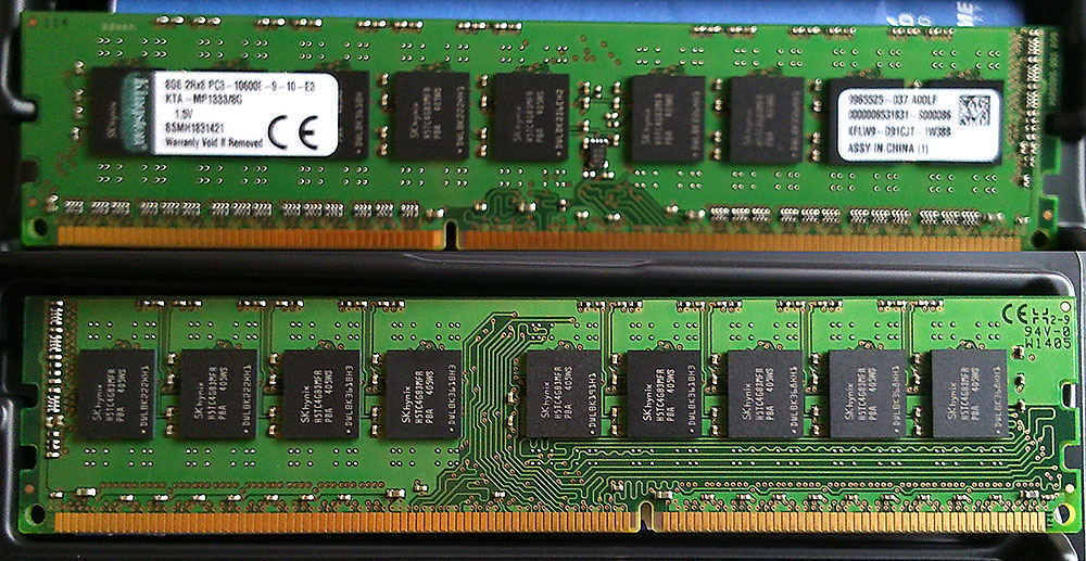

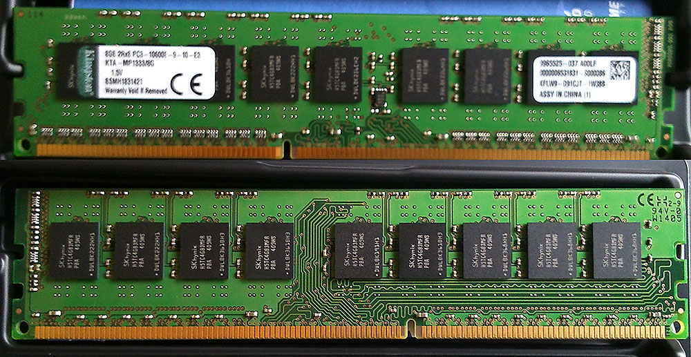

Just for the record, after two weeks of waiting, the vendor agreed to take back the modules and send me a couple of 8gb Kingston modules, for a little extra cost. These are working just fine alongside the OWC module (shown above) and even together with my 4GB Crucial 2RX8 PC3-8500E module, for a funny total of 28gb of RAM.
Thanks to everyone for their help.
