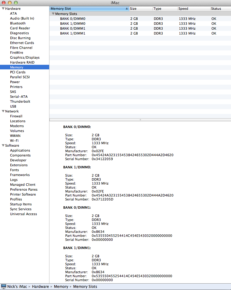

    I just installed my additional 2x2GB of Ram from OWC last night and when I check "About My Mac" it shows 8GB of RAM (previously there was 4) so I know it was successful.
    Today I'm running iTunes and Safari and iTunes starts skipping and this gray Restart screen scrolls down like a curtain. When I restarted my iMac a little yellow triangle notice popped up for a split second and I read the word "Nexus" and when asked to send a report I did. Could the RAM have caused this?

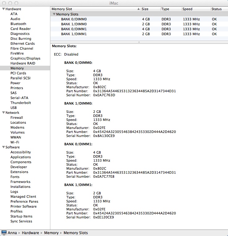

    Yes, it could, and it may be the result of mixing two brands of RAM.
    Mine was crashing (grey restart/kernel panic type screen at random intervals) after I added two 4GB DIMMS from Crucial (to total 12GB).. Try them in different slots, on mine at least one "bank" is on the left side of the iMac and the other is on the right. You want to match the dimms in each bank and see if that helps.
    Weirdly a lot of guides online say the banks are aligned the other way with the two front sockets being one bank and the two rear ones being another. I guess they changed them for different models? Maybe my iMac is just a freak.
    edit: It did it 10+ times over a day with the ram in one orientation and hasn't done it once since swapping them out. I was full of dread as it was a new (well, refurb!) iMac and I was getting prepared to send it back!

    I think you probably did do it right. That's what I did at first too. That's what Crucial and OWC say but for some reason I get frequent kernel panics in that configuration. When I go into About My Mac now it looks like my attachment, with two 4s in Bank 0 and two 2s in Bank 1. Thats with pairs matched forwards/backwards not left/right, and no kernel panics anymore.
    All the dimms passed all the 3rd party memory tests I could get my hands on too.
    Maybe someone here has some idea why this could happen. :eek:

    This is what mine looks like...Idk if your theory is right bc it proves Apple doesn't have their Banks set up correctly in the first place?
