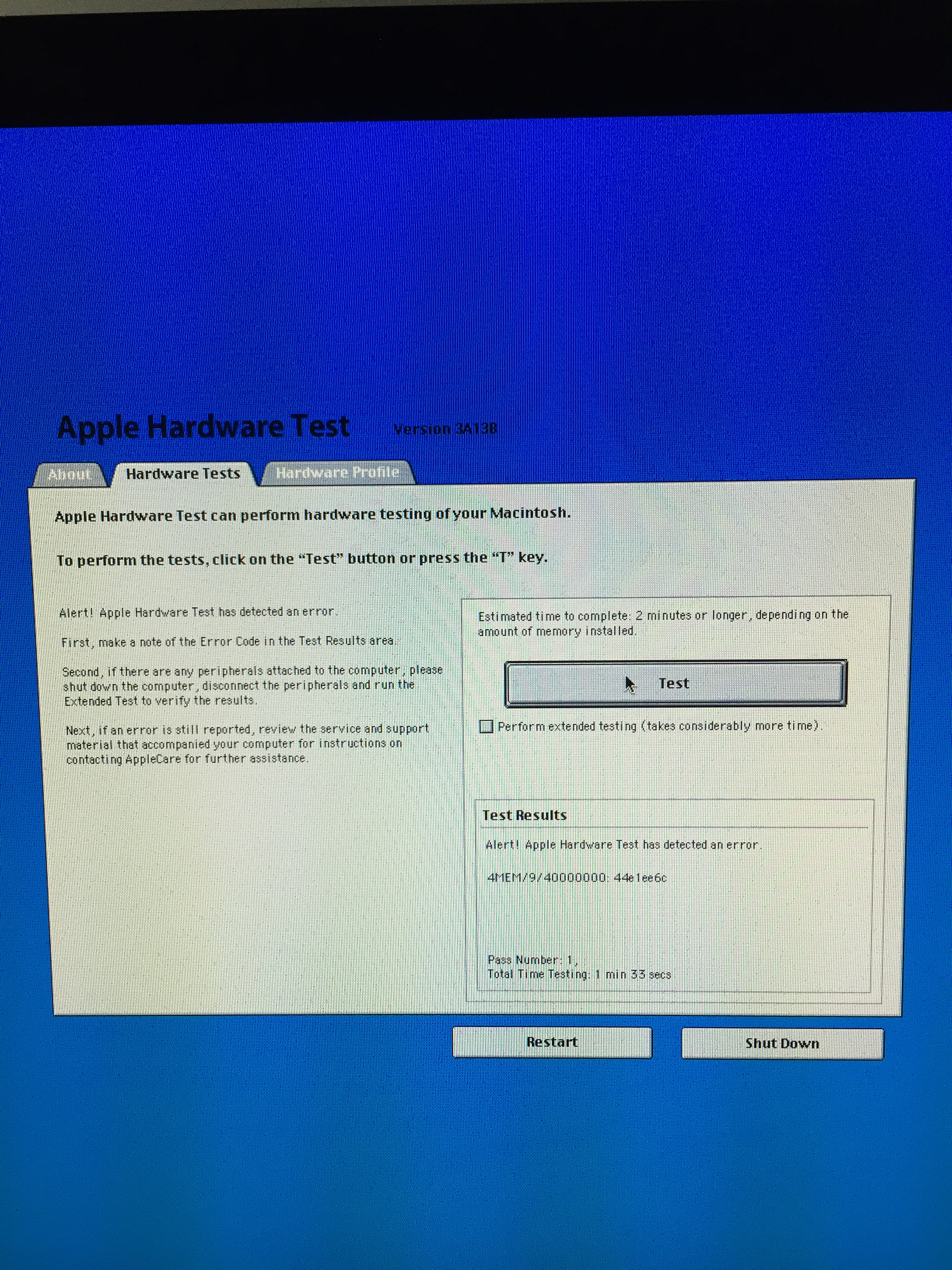

Hi, again. I did the following tests
1. remove one piece of memory, run AHT, i got the following error
Alert! Apple Hardware Test has detected an error.
4MEM/4/40000000: 89c3dce8
so another error, probably because it was in another slot
2. the same piece, i install it in another slot and i got another error, see picture attached.
3. removed that piece, install the second one, performed standard AHT, everything was ok; then i performed extended AHT test, and after 45 minutes everything was ok
4. i switched again the slot, then performed the AHT, everything was ok.
SO, bottom line, one of the RAM is bad. I need another piece.
