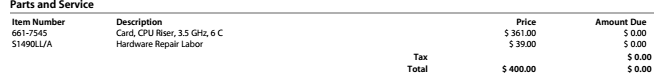

Update and conclusion; I picked up my repaired nMP yesterday at the Apple store, they changed the CPU riser card, it appears that it was defective from day one. The machine is running well now.

Nice to see this terminology - the board that the CPU is on is a daughtercard, the motherboard is the circular board at the bottom of the cylinder.
The CPU is not on the motherboard.
I have attached a screen shot of the work order indicating the part changed.
