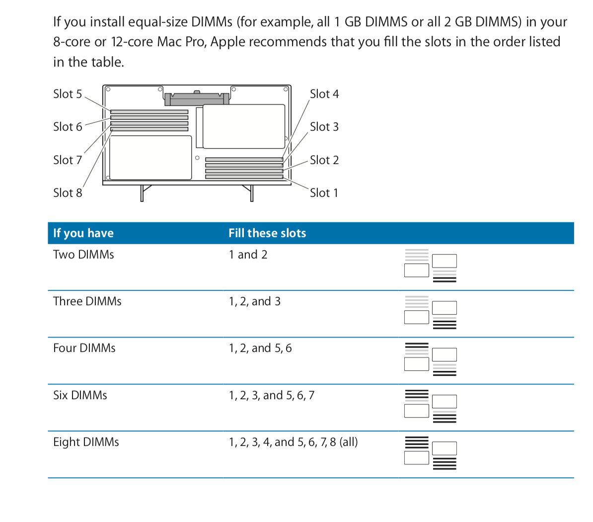

Hi!
This is the manual
Best regards
/Per

This means that you first you put the 16GB in slot 1,2,5,6 and the rest 4GB in the rest

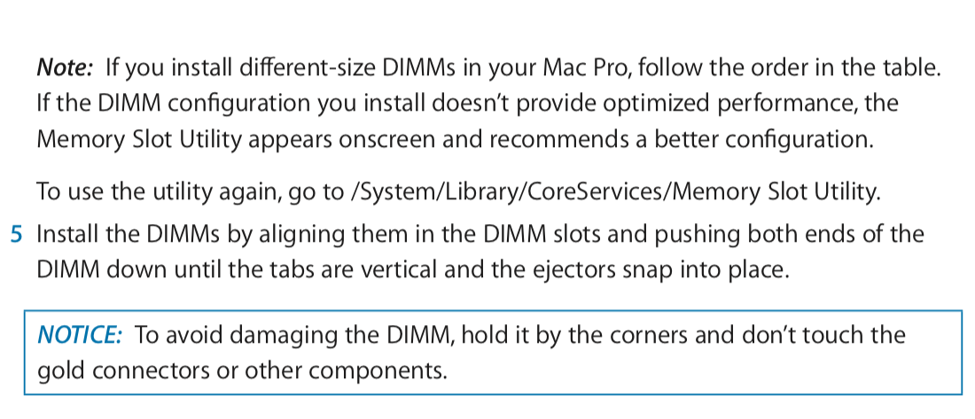

Don’t worry about the difference in capacity. If they are not in optimum config, the OS will tell you once boot to desktop, just copy the recommended config, then shut down, and re-arrange your DIMM.

The best way is to put the same amount of RAM to each processor, so one don't need to use NUMA so much. The best way is to put 2 16GB DIMMs and 2 4GB DIMMs for each processor.

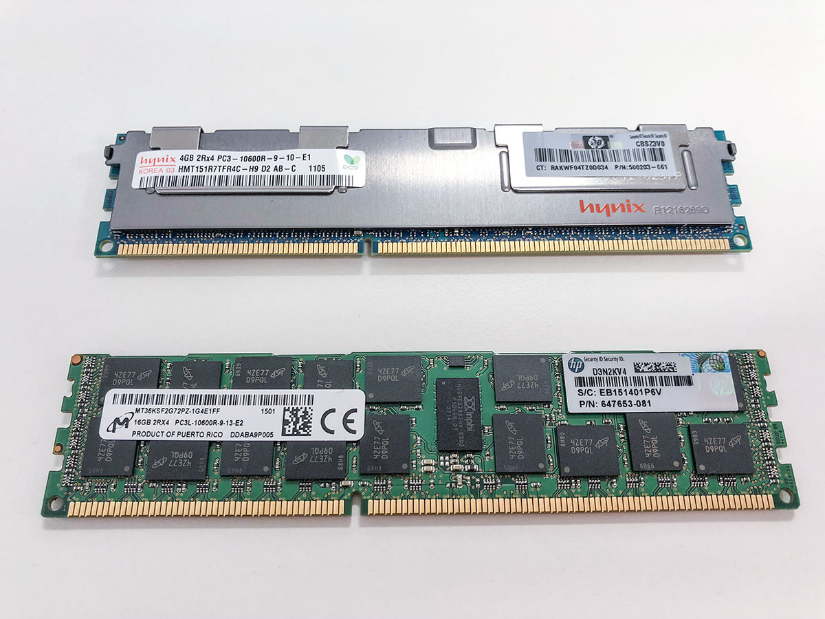

Received the 16gb DIMMS today, all works fine in the following configuration:
Slot1: 16gb Slot2: 16gb
Slot3: 4gb Slot4: 4gb
Slot5: 16gb Slot6: 16gb
Slot7: 4gb Slot8: 4gb
Total: 80Gb

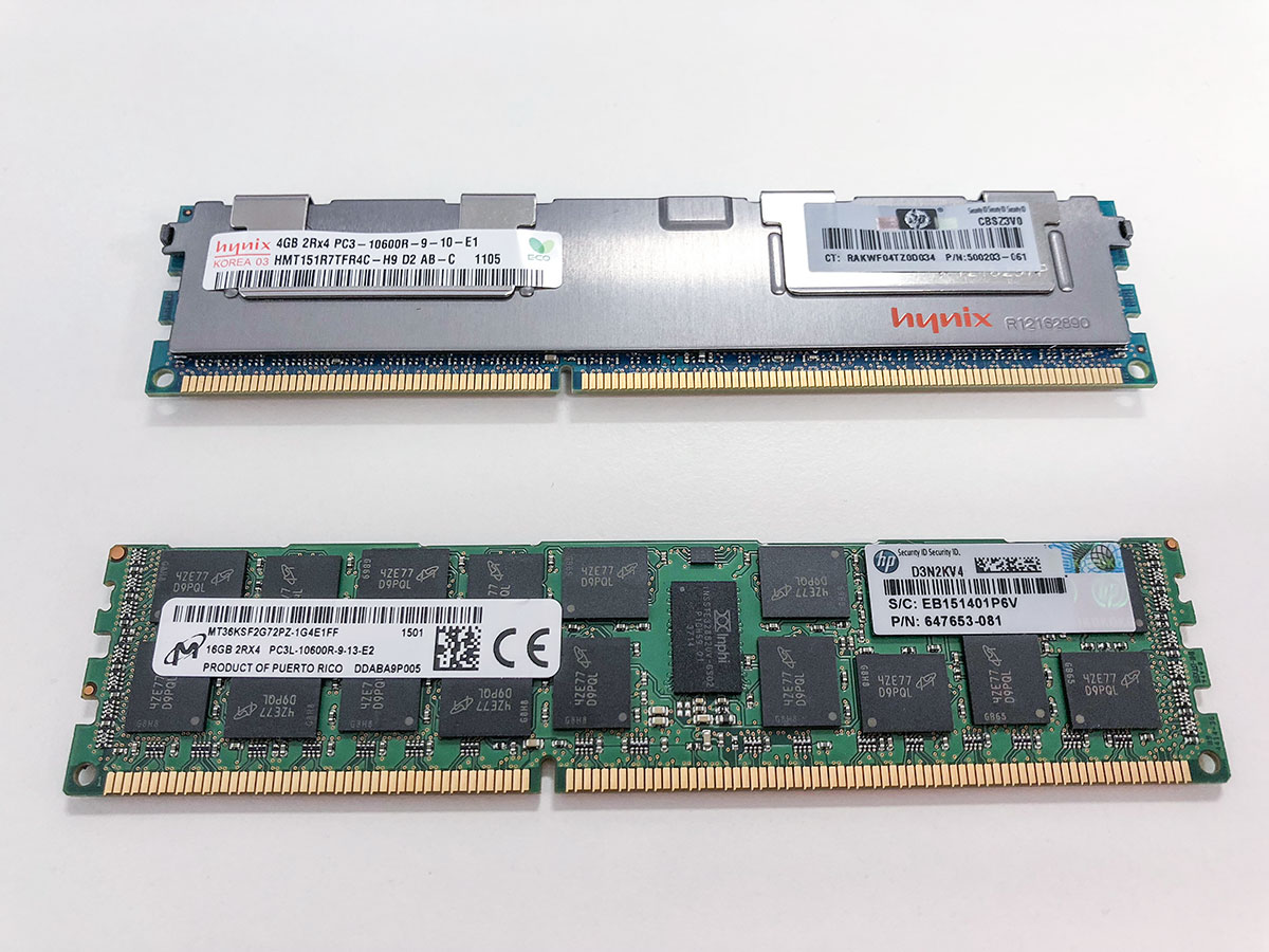

My old 4gb DIMMS all had heat spreaders on them, is it worth transferring these over to the new 16Gb modules?

Check your RAM temperatures with iStat or another app, if the new ones are hotter that the old ones, do the heat spreader swap.
Test your new memory a lot before doing that, you probably will loose your warranty. I usually only do the heat spreader install after the warranty/return window expires.

I my 2010, I had followed the manual with four identical 4GB ECC dimms, and placed them in slots 1,2 & 5,6. I tossed in a Lion install, and the memory slot utility popped up and suggested that I put them in slots 2,3 & 6,7.
I moved the DIMMs, and saw no performance decrease running Sierra. Any ideas why the memory slot utility suggested a configuration contrary to the manual?

No idea, but that won't make any difference anyway, each DIMM still has their own channel.
IMO, just follow the memory slot utility's suggestion can't go wrong. It's definitely more update than the original manual, and it's directly from Apple.
