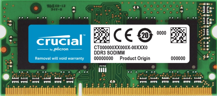

Are there 4 chips on each side? I had a mid-2012 13" with 16 GB and it need low-density ram with 8 chips on each side.
I'll have to look again tomorrow, it should be compatible though as Crucial's system scanner recommends the exact model number of the RAM I bought
Reactions: Tekguy0
Just checked, there are 8 chips on each side
