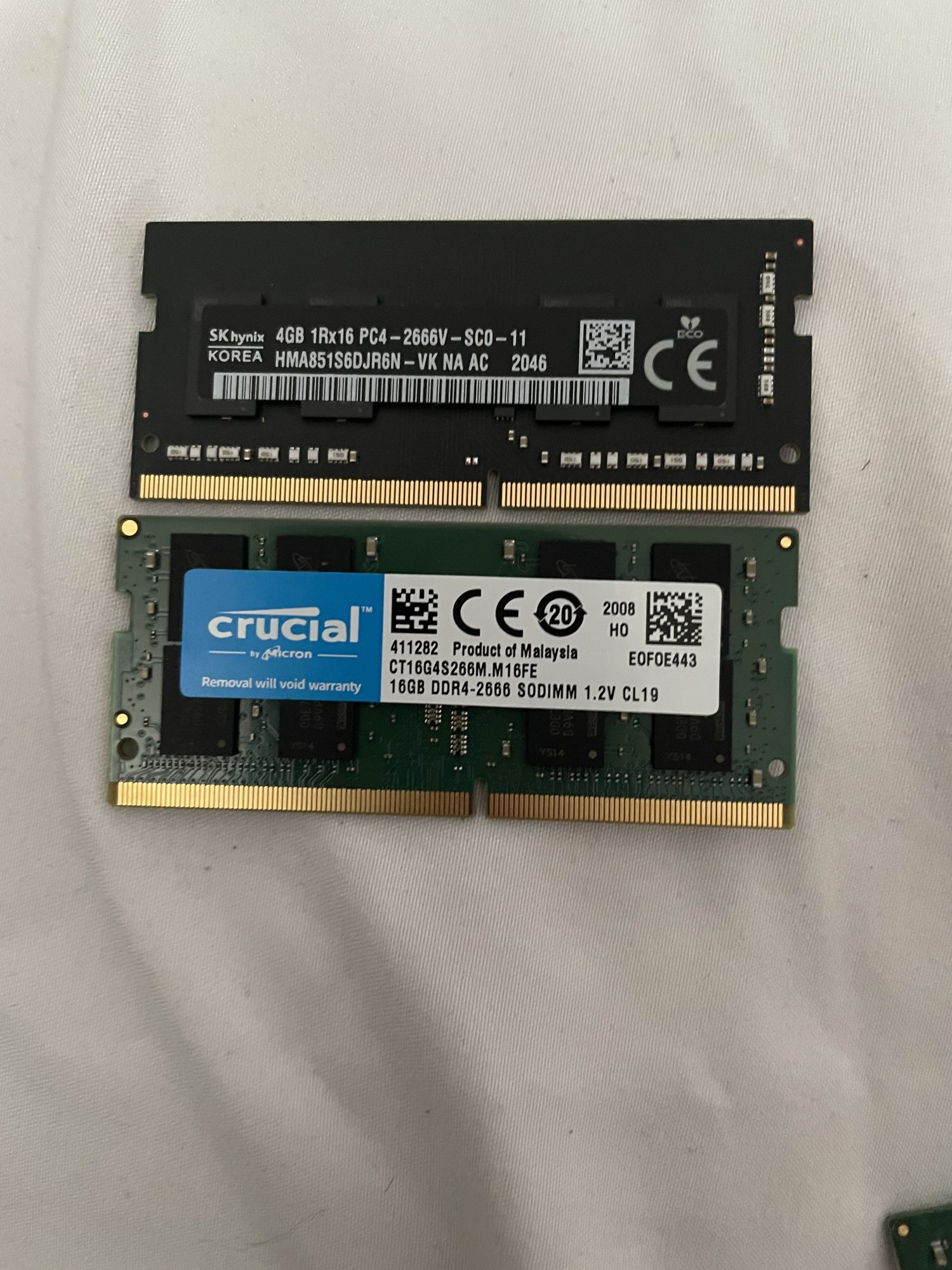

I tried upgrading my 2020 IMac ram to two Crucial 16gb sticks which and I’m placing them in the same slots as the ram that came with the computer (slot 2 and slot 4) but my iMac won’t start up.
I made sure the ram was pressed firmly and closed right but same problem.
I then tried keeping the original ram in there and adding my 2 sticks in slots 1 and 3 but it would not start.
I then placed the original ram back by itself and it started no problem.
What can I be doing wrong?

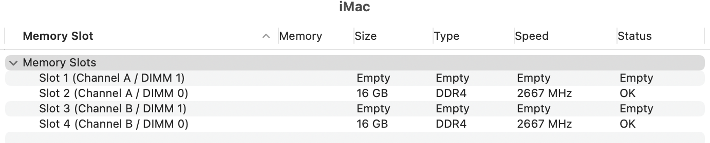

Check it is running at 2667 MHz, with equal RAM in Channels A and B
