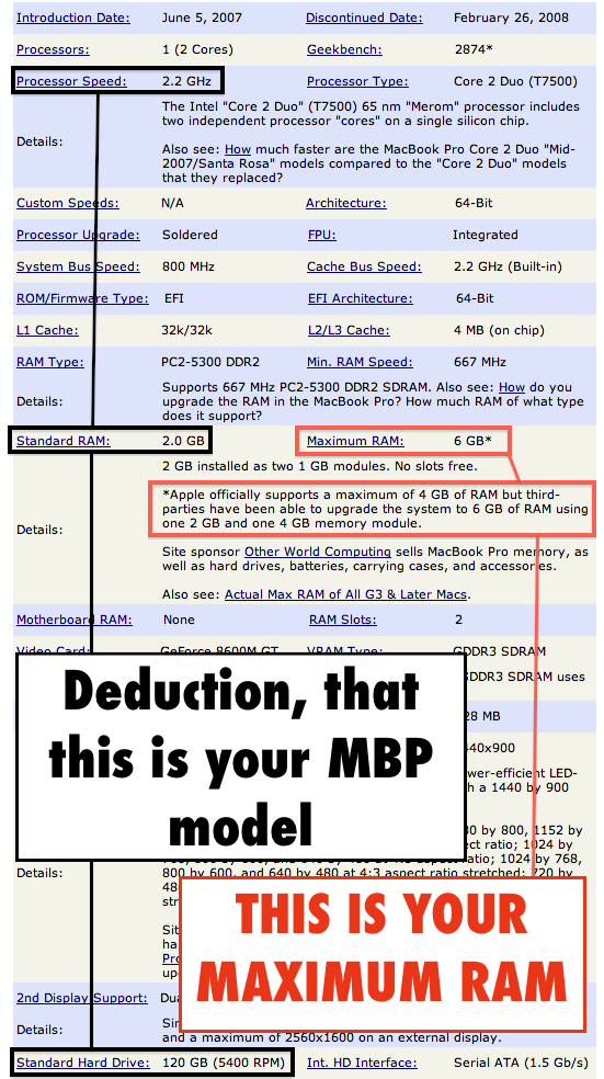

Go to :apple: > About This Mac > More Info... > Hardware > Hardware Overview > Model Identifier and look at EveryMac for your machine.
Then click on the presented link and see what the maximum capacity is.
Or you could go to OWC and see for yourself, as you clearly don't have the Unibody MBP, but the Aluminium one.
Aluminium MacBook Pro (2006 till 2008)
Unibody MacBook Pro (released 10/2008)

Ahhhhh my bad. Thanks! I'll check out that site. 🙂
Hmmm that's very strange. When I purchased the MBP at the Apple store they said I had the immediate option to upgrade to at least 4 gigs (which I opted not to do), but the identifier clearly states that each slot takes a 1gig stick max.
This can't be right.

You have this Mac?
