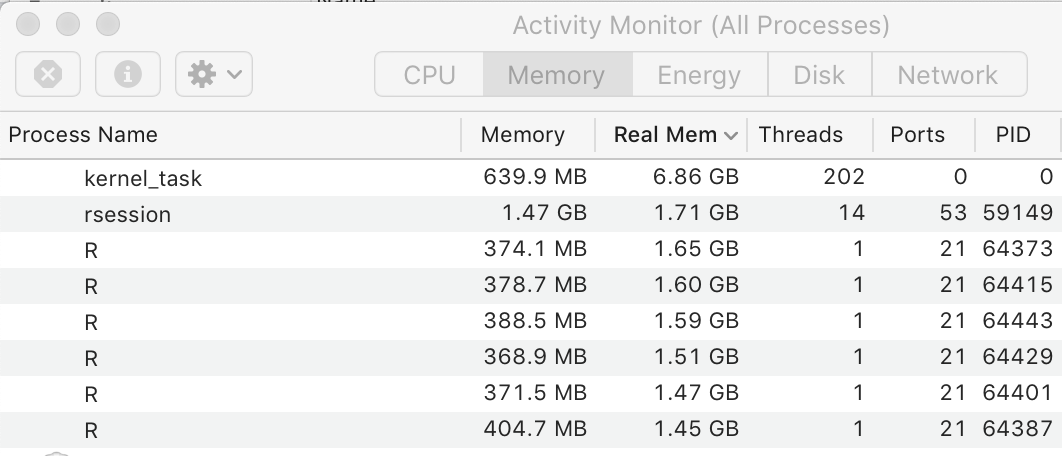

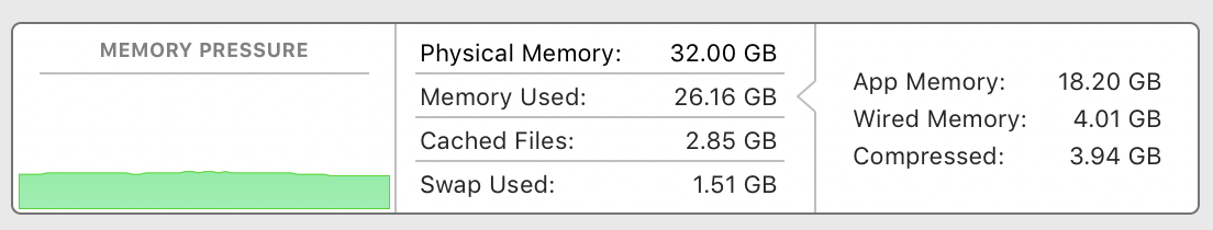

I'm currently doing some data crunching in R on a 6-core i7 Mac mini 32GB RAM: 6 threads running, and RAM usage looks like this:
My question is: Am I really using 26 GB of RAM? Or only 4GB? (The 'Wired Memory'). Pressure is green (whatever that means?)

You are using 22Gb of RAM (18.2 gb(R) + 4 gb(Mac OS itself)). So you have free 10GB of Ram.

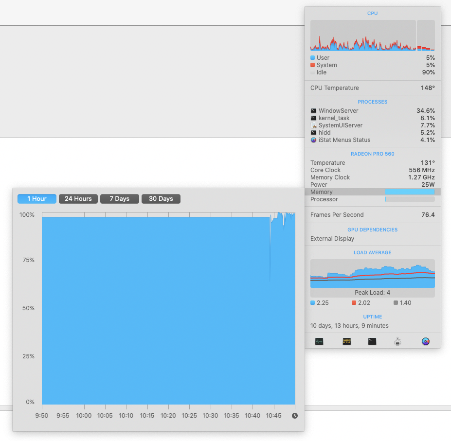

Guys, I have a similar question.
My Radeon 560 memory is maxed out and SWAP memory started to max out as well, but RAM remains around 75%.
Will I benefit if I go from 16Gb to 32 Gb?

"Wired Memory" is best thought of as what the system is using. System processes, etc. Necessary for everything to run. The rest can be swapped out or compressed. You are using 26GB, but 22GB of it can be shuffled around. 4GB used by system processes is not bad. Mojave idles around 3GB for me.

I think it's more helpful to use Apple's own indicators. THey make it very easy and non-technical. What color is the memory pressure in Activity Monitor. If this is an extra ordinary workload, you are probably fine, as the system is at about 1/3 pressure. If you need to push it even more on the regular 32GB is worth considering. My guess is you do not. I have noticed that Mac OS will swap out data to disk it thinks it doesn't need even if it RAM resources still available.

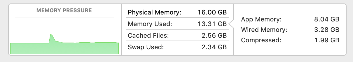

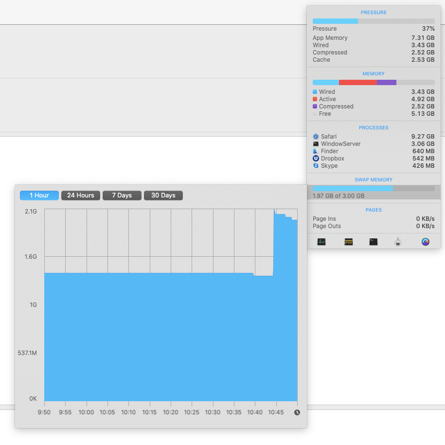

Apple memory pressure shows that there was a significant peak, but withing the green zone.
But the iStats menu said that ~100% of the swap was used.
What concerns me is that the computer got hooter and (I think) slightly slower when I kept so many windows/programs open.

I don't know what the maximum size a swap file can be under Mac OS, but 3GB seems incredibly low. My understanding is that swap keeps increasing dynamically as necessary until the disk is full. You might not be getting accurate information from iStats. Activity Monitor tells you everything you need to know about RAM. Let the system do its thing from there. Green means you are good.

macOS assigns a certain amount of disc space for swap file - it changes based on what the system needs. iStat menus report the percentage of the swap file being used, which isn’t really helpful. For example, if macOS has 1GB assigned to swap and 1GB is being used, iStat shows 100% swap file used. That’s not helpful.
Also, macOS uses swap very liberally, so using swap file usage as an indicator of insufficient memory resources is not really a great idea. Unless there is a huge amount of disc space assigned to swap during a particular workload. In that case, macOS will report high (red) memory pressure in Activity Monitor.
