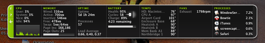

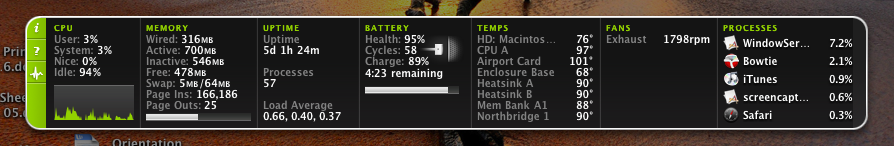

That makes sense. I do not think that I need more RAM, I just thought it was odd that it PO with free RAM available. Anyone have any more info on the Swap number, or the bar at the bottom of the iStat widgit.
I'm not sure what swap numbers you mean. Can you explain further or attach a screenshot?
Same with iStat (which I don't use). A screenshot might help.
Here is a screen shot of my iStat...
The first swap number is the amount of space used in your swap file(s). The second number is the total size of all your swap files.
You can see your swap files by examining the folder /var/vm (type in the path by using the "go to folder" command in the Go menu item (sorry I don't use an english Mac so I can't be more precise)). New swap files are created when needed. They can also be deleted automatically by the system when not needed anymore.
The bar at the bottom measures how much memory is "used" (wired+active). Inactive or free memory is not regarded as "used" here.
