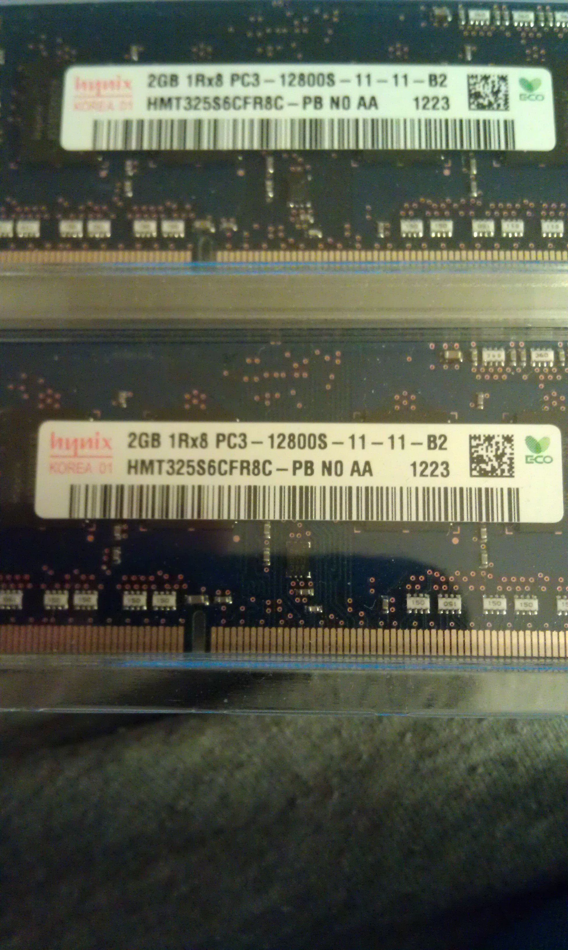

I'm fairly certain it was 11 in mine originally. I have the spec sheet downloaded on my Mac at home, all indications are that it's 11 though it's not listed specifically. I also deduced this by looking at the ratings on the sticker on the memory, there was an 11 in the spot where CAS latency normally resides in the string of specs. I'll post the string and photographic proof when I get home.

According to the tech specs book I downloaded from Hynix based on the memory part number I searched on, my original memory, pictured below, will run CAS 9 if you run it at 1333 (PC3-10600). If you run it at 1600 (PC3-12800) you get CAS 11. With my Corsair Vengeance memory installed, my mid-2012 15" MBP reports that it's running at 1600 (PC3-12800).

Thanks for the confirmation and that is what I guessed, that the stock 1600Mhz RAM runs @ 11 CAS 🙂
Anyway, good to know that the GSkill RAM I got matches all stock values (1.5v and 11 CAS @ 1600Mhz). FYI, I did not see any 1600MHz RAM @ 9 CAS on Newegg when I bought my set the other day...
