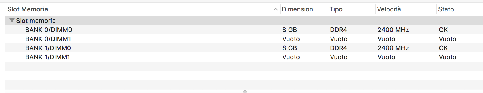

The RAM that I have purchased have the same CL of Apple RAM.... it's full compatible
This is my situation..
So you think it's better to move the Apple RAM from BANK1/DIMM0 to BANK0/DIMM1??
Sorry.... my system is in Italian language :)
Yes, that is what I would recommend. If the RAM you purchased has all of the same specifications as the RAM that came with the computer it may not matter, but you have a lower risk of incompatibility if you have perfectly matched RAM sticks.
Just put the new Crucial RAM into the empty slots as redheeler already recommended above. The Apple stock RAM is already installed in dual channel configuration. Leave it be.
With the Mac you want to have matching RAM sets in alternating slots (DIMM0 and DIMM1).
Based on the screenshot that he posted, it looks like the RAM didn't come installed in a dual-channel configuration (he has one DIMM in Bank 0 and another DIMM in Bank 1). He'll need to move one of the original DIMMs before he can install his new RAM, if he wants to have everything running as fast as it can go.
Proper dual-channel configuration on the iMac means matching modules in DIMM0 and DIMM1. This has been proven by both benchmarks which show severely decreased performance with matching module sets in BANK0 and BANK1 as well as CPUZ in BootCamp Windows which confirms dual channel enabled only with matching sets in DIMM0 and DIMM1.

I am basing this on my own benchmark results but others in these forums have also confirmed it. Not only do benchmark results improve noticeably with matching sets in DIMM0 and DIMM1 as opposed to BANK0 and BANK1 but running CPUZ in BootCamp Windows shows dual channel enabled only when it is configured that way and not when it is in matching banks. Then there is the fact that Apple ships the iMac with their matching sets in DIMM0 as well.
I will get a screenshot from CPUz later and post it to this thread. I like optimal performance as well.
Dual channel alone probably wouldn't affect performance so much but my best guess as to why my benchmarks show such a marked difference is that with matching modules in BANK0 and BANK1 you are actually using mismatched sets in the same channel. If all of the modules are identical then it probably wouldn't make much of a difference at all. However, in my case I have 2x16GB of Crucial Ballistix Sport LT CL16 RAM and 2x8GB of Apple stock CL17 RAM and when the Ballistix and Apple modules are forced into the same channel with each other the benchmarks show it.
