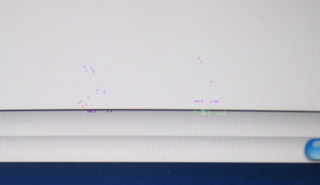

I've had my 27" iMac (3.06GHz) for a few weeks now and yesterday I noticed some weird artifacts appearing on the screen, very randomly.
They will pop up all over the screen but if I "Show desktop", they will go away for a bit but sometimes reappear again in different areas of the screen. I restarted the computer but that only temporarily fixed the problem.
Anyone know what's causing this and how to fix it?

As was suggested, see if it persists with a new user profile, but it's probably your video card. A new user profile should take any preferences you have changed out of the equation. You might also try stopping applications or removing them from your login items.
My 4 year old iMac started doing this a couple of years ago. For the longest time, I thought it was an application issue, but eventually it degraded to the point that the screen would 'lock-up' after a few minutes use. Of course It didn't get to this point until my Apple Care was expired... Turns out that the video card is soldered to the motherboard and the fix is to replace the main logic board @ $550. Make sure you get this resolved while your warranty is still in effect, as it's a very costly repair.
When this started happening on my system, It was from running the CPU hard for extended periods: Ripping DVDs in Handbrake and running games would reliably generate artifacts that would persist even after the system cooled back down.

It just happened again when I opened iPhoto and looked at some pics. Closing iPhoto makes it go away but reopening makes the problem reappear.
I'd say that it is a problem with the GPU that's exacerbated by heating. I have a 2002 iMac G4 with the same issue. Also possible is that one or more of the cooling fans are failing.
I'll guess that the problem will only get worse over time.
The best solution would be to have the GPU replaced and I think an Apple tech can do this without replacing the entire system board. An alternative is to install some fan control software and have it run the fans faster or at lower temperature thresholds.
I wonder what triggered this...I guess something have have failed? I didnt do this for the first 3 weeks of ownership and now happens everytime I have too many things open. I just had 6 (8 page each) PDF documents open and sure enough it did it again. As soon as I closed 3 of the 6, the problem went away.
Could be video memory corruption or an issue with the GPU. Also consider your main RAM as a culprit as well. See if there is some RAM test you can run on it to rule out your main RAM as the problem. I'd call Apple to see about getting it repaired.
I went to the Genius Bar today and they said it looks like a video card problem and are replacing it. I'm dropping it of tomorrow. Hopefully it is the vid card and not the main RAM.
